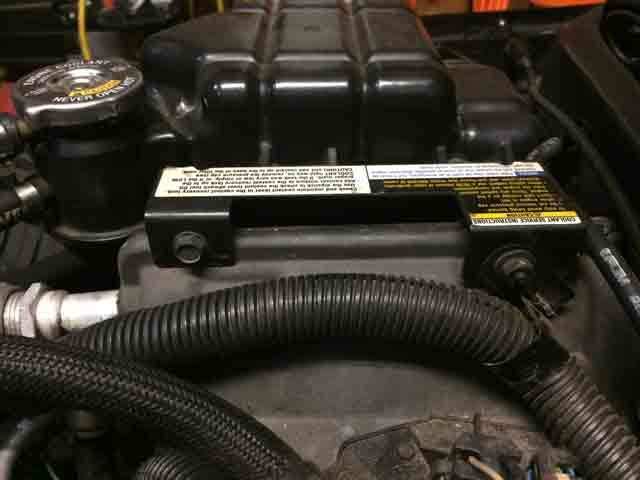

Anyone with an LT car have pics showing how the expansion tank mounts? It sits up on the top passenger side of the engine bay. I bought one I want to retro fit to my car (L-98) and am going to have to make my own bracket. I'd like to see the stock one though so I can get a visual, thanks.

the bracket mounts to the evap housing
then the tank mounts to the bracket

the bottom locator pin goes into a rubber insulator mounted in a simple L-bracket bolted to the square support rod from the hood latch to the frame.

Awesome. Thank you very much.
