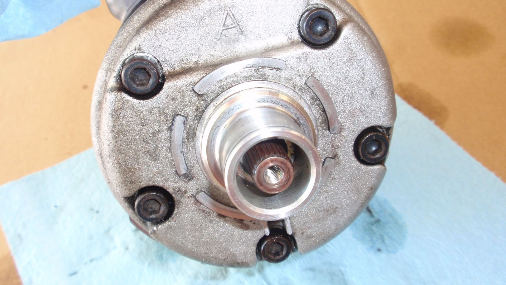

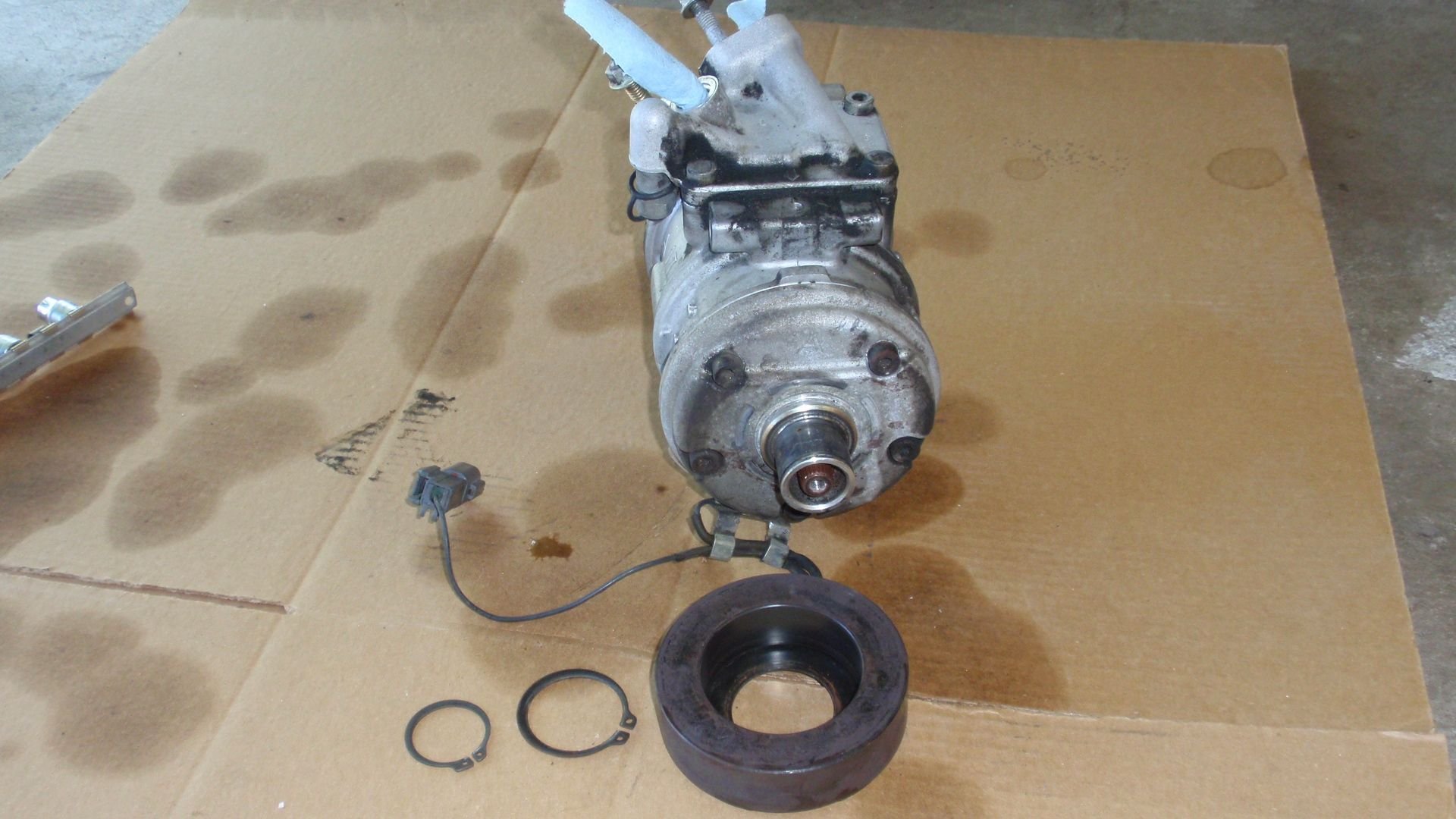

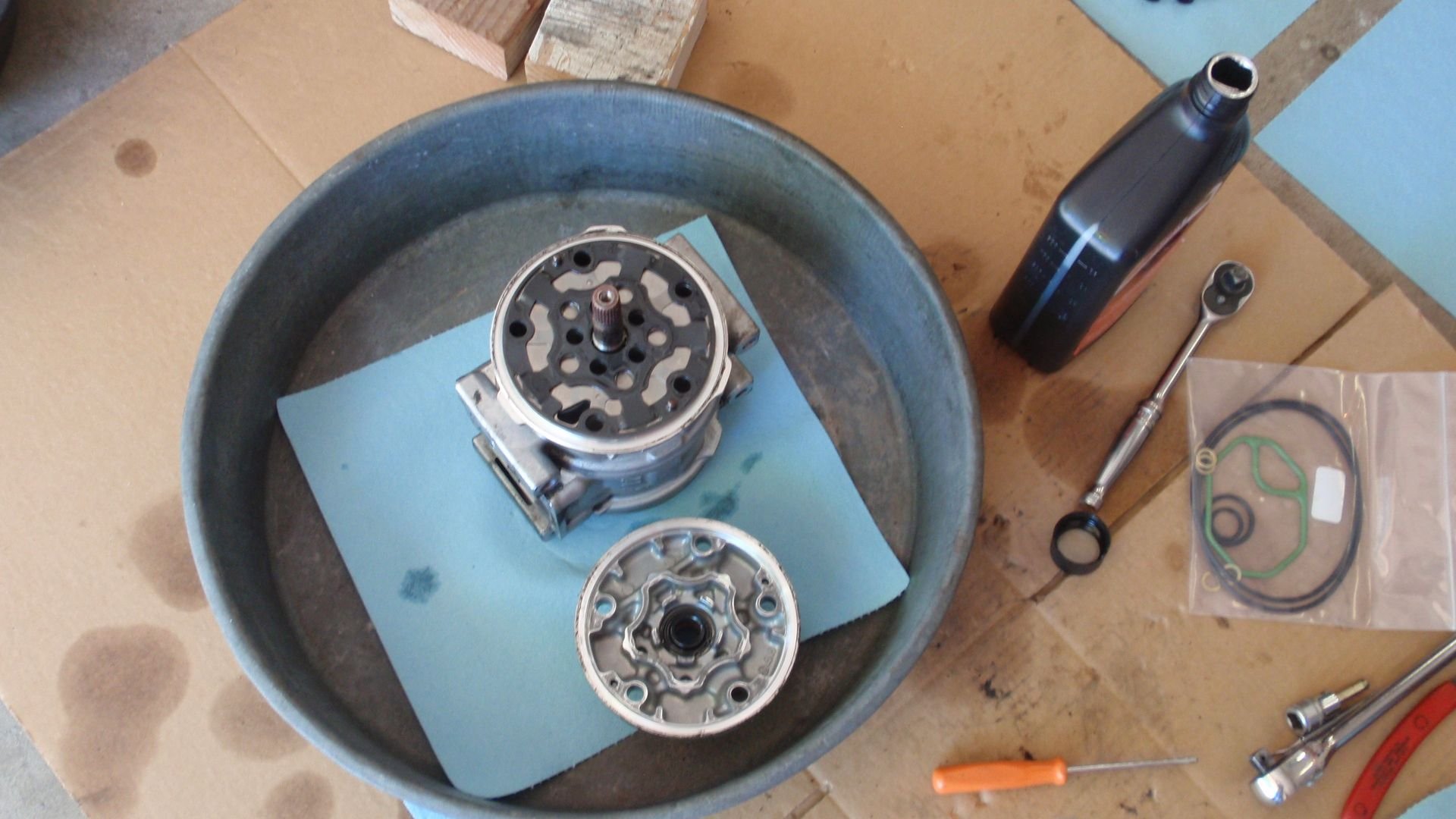

So before I started, I ran Dye in the system. Turned on the compressor and let it cycles around the entire system. The only leak found under UV light was the one at the compressor front. Other than that, everything else appeared working.
Now I took off the front of the compressor to see what I was dealing with. As I work my way through it, I can see Dye on more and more parts which is pretty much a trail to the actual issue. I did spin the pully around after I took off the clutch to see if the bearing makes noise. It doesn't so it's intact. So far, there is dye all the way to the front shaft seal which leads me to think joeld is correct. Luckly, I have the front loading compressor, which means the seal can be pulled out from the front without taking it apart. I know this because the retaining clip is on the outside of the seal. Potentially, it can be done while still on the car but I won't chance it and do it on a bench like aklim suggested.
In terms of O rings. I don't know if they have been changed or not. In my experience with O rings in general, once you pull apart anything with old O rings, they will start leaking. I have spares ready. I think the only ones I should come across are the ones between the metal lines connecting to the top of the compressor.
I have enough pics to make a guide on how to do this when I'm done if anyone's interested.

I don't believe this to be true. If you look at my pics, my retaining ring for the front seal is on the outside of the cap. Your's was on the inside.
Check out this video. It shows the difference between the two compressors.
