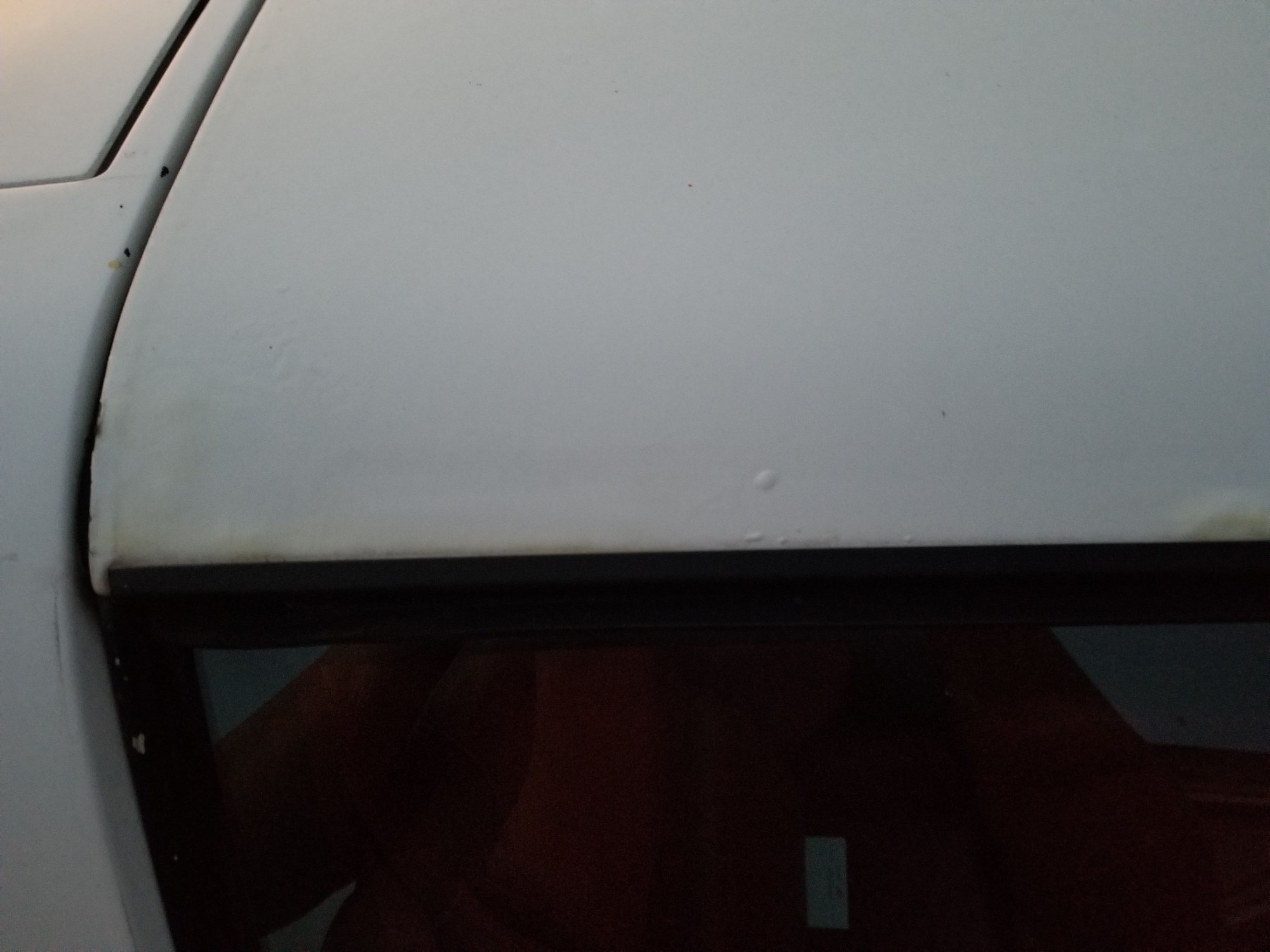

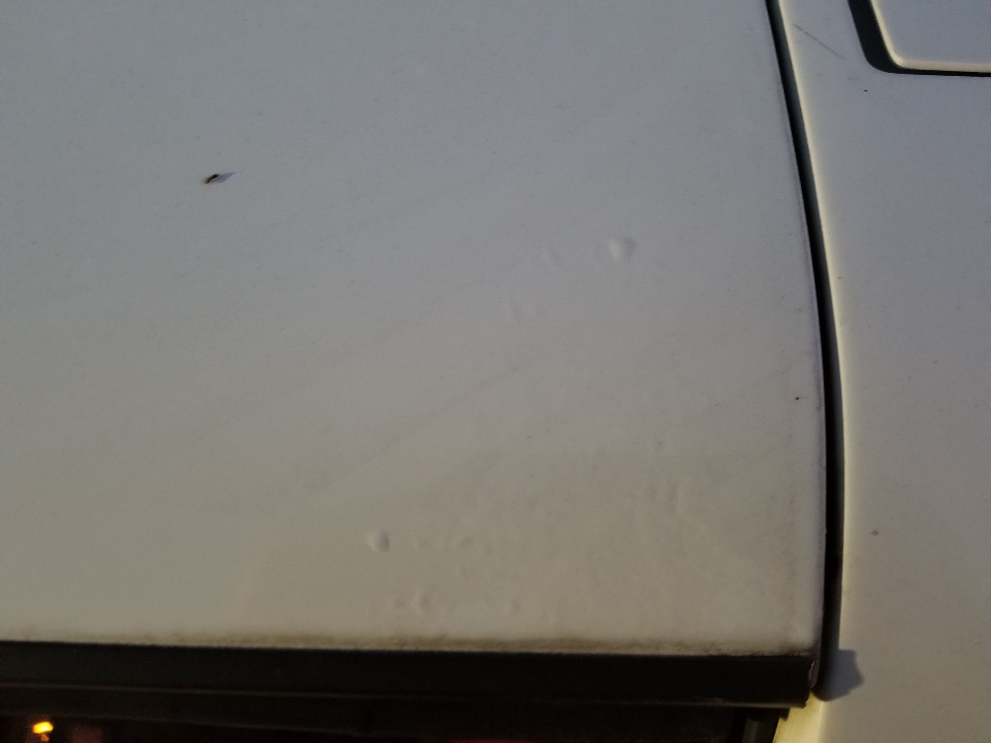

Looking at the pics isn't that what yours needs paint?

IDK. Why is it bubbling after 5 years? What about that big line crack? Is there something wrong in the fiberglass? That is my concern. Should fiberglass bubble and crack like in pic 1? If that is normal, I'd have it redone with the paint job but if the material is bad, I don't know what to do. I'm no expert on body work so I don't know if the fiberglass can be saved.

I did not see the crack but always thought the bubbling was poor preparation of the surface.

The acrylic ones are see through and the fiberglass ones are painted to match the color of the car. Have you owned the car since new? If not I suspect the PO had a top painted to match the car, poor preparation before paint could lead to the bubbles but not the cracks. Cracks mean an issue with structural stability of the top. Previously cracked and repaired poorly? Car pushed so hard the frame flexes and cracked the top? Yours may be repairable but you will only know after sanding down to the base fiberglass. Either way, even repaired the top would most likely crack again with use since it would take a significant amount of additional glass and resin thickness to add enough structural stability so this does not happen again. Go new fiberglass and paint to match.
