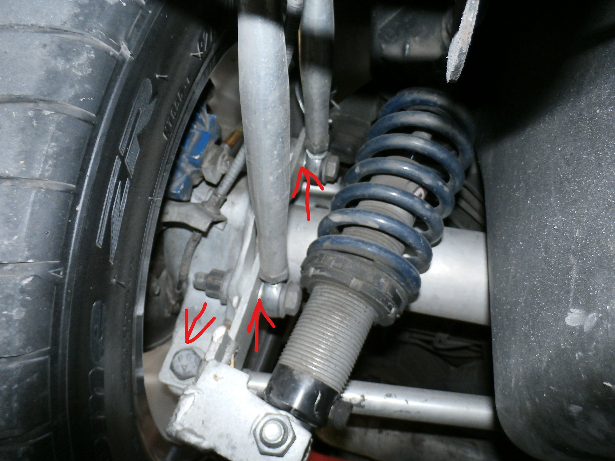

Here are the ones I made up, the 3 red arrows show where the mount bolts to the knuckle and then the mount is made with two pieces of 1/4 inch flat stock, (as is the rest of the mount) this makes double shear strength which should be impossible to break, (I hope)

Midnight 85, hate to ask, but do you have the specs on the coilovers? and spring rates? I took a quick look at the rear yesterday, they shock looks shorter than whats on the front.
I see that your using the bearing mounting coilovers. I was leaning toward using the bear mounts coil overs. They seem to be more rigid of a mount that the poly mount.
Looks good buddy. I was also thinking about doing my lower mount similar to yours.

no problem mike, glad to share. i can tell you about the shocks but i don't remember the spring rates but they are the only ones, i believe,, that exotic muscle offers for the c4 so you could get that info there. the shocks are qa-1 proma-star number ds 404, the extended length is 15 in. and the collapsed length is 11.25. the spring is the standard 2.5 inch and is 10 inches long. the shocks have 18 firmness settings, i am using position 7 and the ride is far superior to the em
the mount i made is not my idea, i saw the same thing on another c4 group and was impressed with the strength. the downside is that you have to cut the original mount off the knuckle, the upside,, for me anyway,, is that it made my previously broken knuckle usable again. if i can be of any further assistance just ask.
