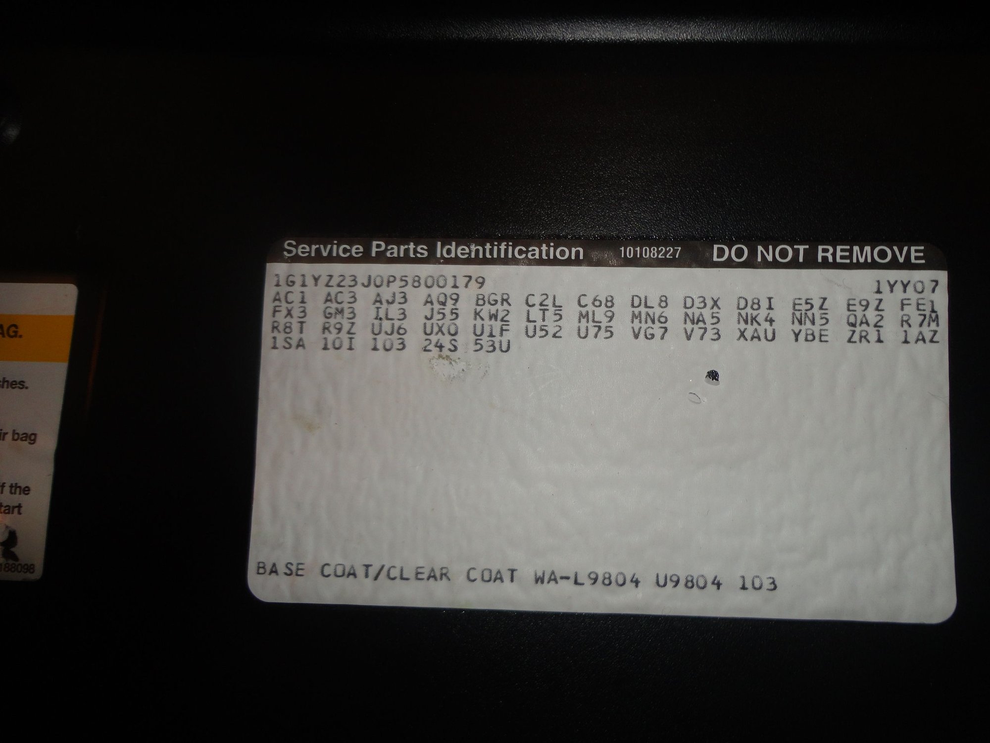

Than again you could look the codes on the SPIF tag in the storage compartment.

Have you found the Service Parts Identification sticker? It would be either on the underside of the console cover or the underside of the passenger side storage compartment lid.
Gear ratios will be different based on coupe or convertible. Look for any of these codes that identify the gear ratios:
GM1 2.59
GU2 2.73
G44 3.07
G92 "Performance gear ratio"
Coupes with the automatic trans would usually get the 3.07, while convertibles would get a 2.59 ratio but the G92 "performance" ratio in the 'verts would be 2.73.
Manual trans cars got a GM3 3.45 ratio.
