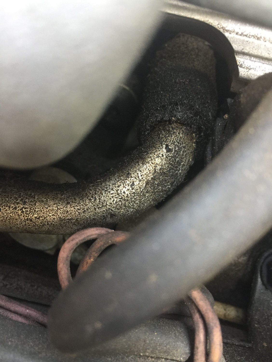

I just now took a look at that little hose @2:00 and the hose is old and decrepit although I can't see all to tell if it's leaking and I think it's original.
Any idea on how to get in there to replace it?

Various curses of a loud and hideous nature!! The actual problem is NOT the burn circuit, rather the ECM saying "Hey, burn circuit, you suck, your friend the sensor is saying garbage." ?!?
Well, I know what I'm gonna try shortly!! I already replaced the boot in the header thinking it might be leaking.

I had a slightly different PVC problem, the hose to the valve cover. I didn't think a hose as hard as rock was a problem, replaced it thanks to this. *deep bow*
Didn't fix code 36, but did help some others, smoother idle, softer throttle on take off. Worth the $4!
