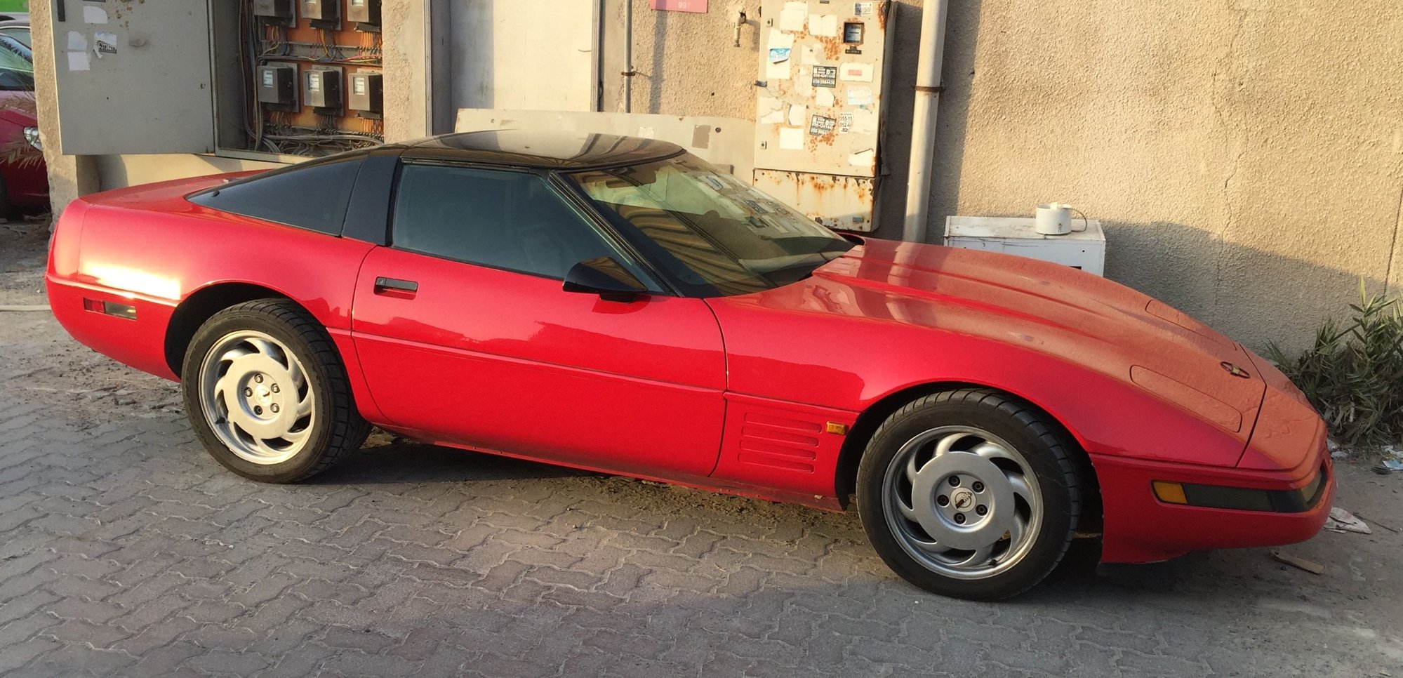

We need to see pics of your new ride!

That’s the one: I’ll get photos of the engine once it get cleaned up.

Originally Posted by ZEROVETTE7
The RF wheel belongs on the driver side. Is the driver the opposite of what's mounted now on the RF? RR is correct mount!
Yep it’s actually the LR , will switch em soon
thx👍🏻
thx👍🏻
Unfortunately, your tires are directional, and will need to be switched too.
(That makes it three posts from Mission Viejo, California! Hi, Whalepirot!)
eventually all will go and new will come
