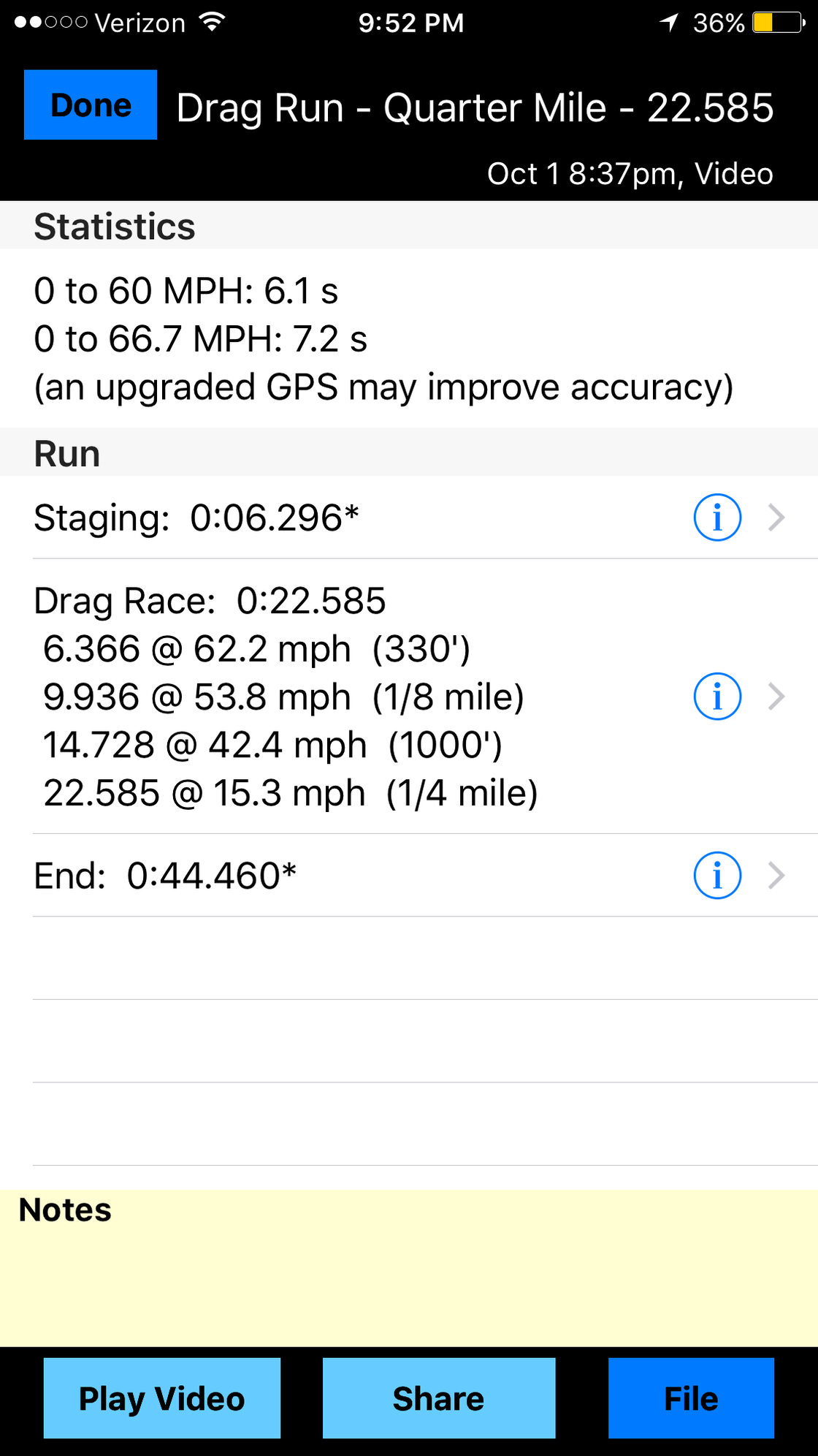

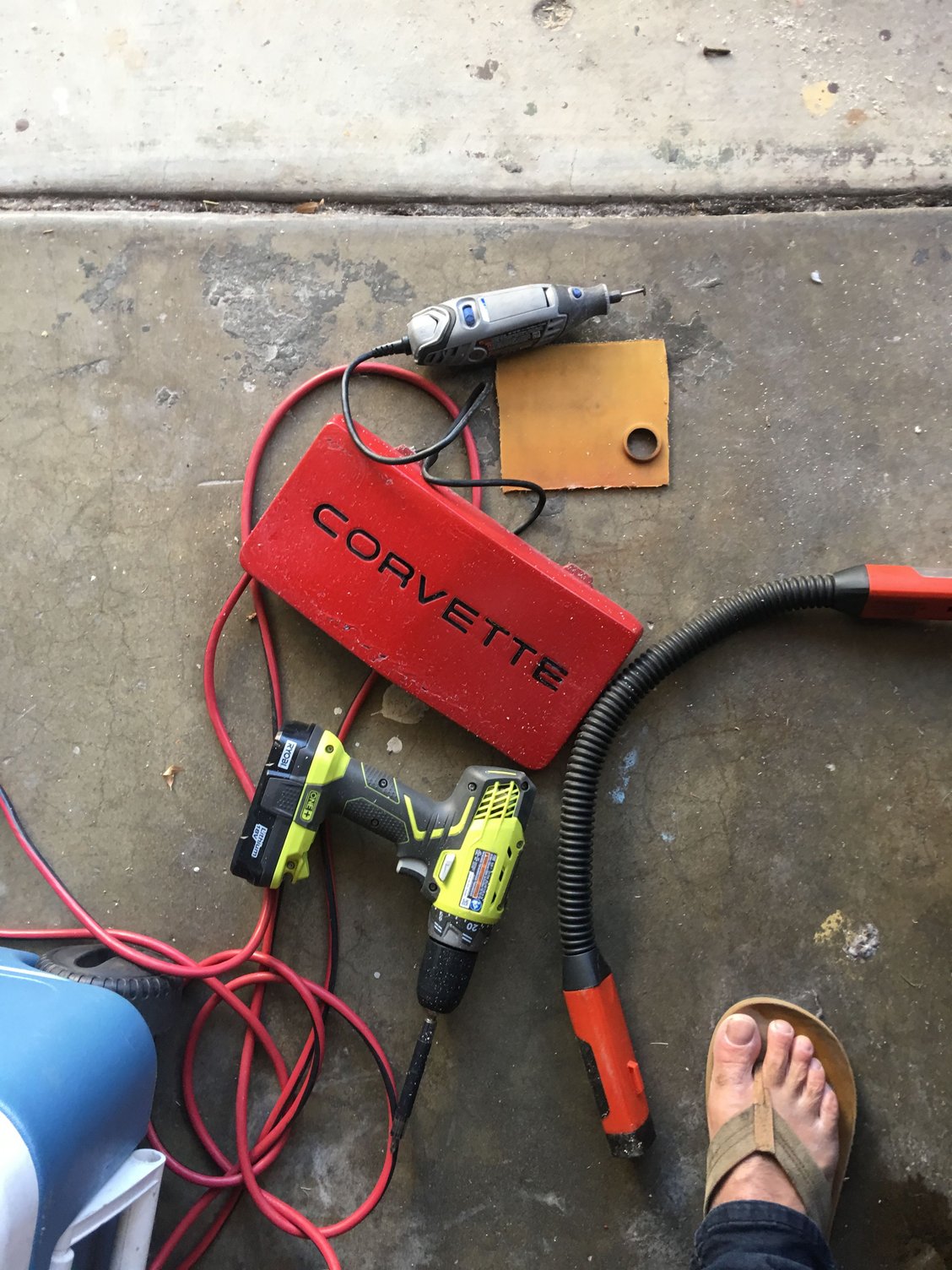

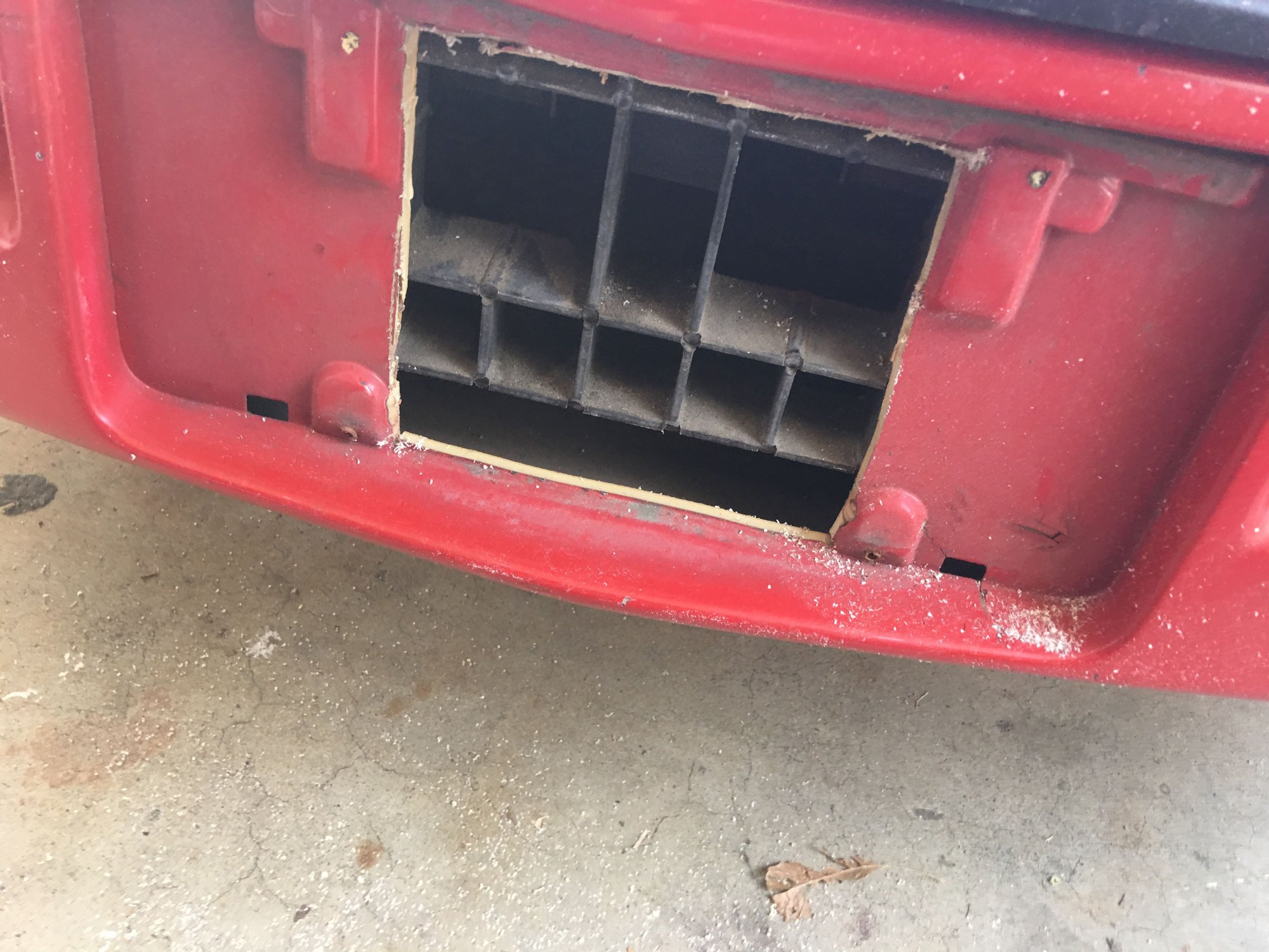

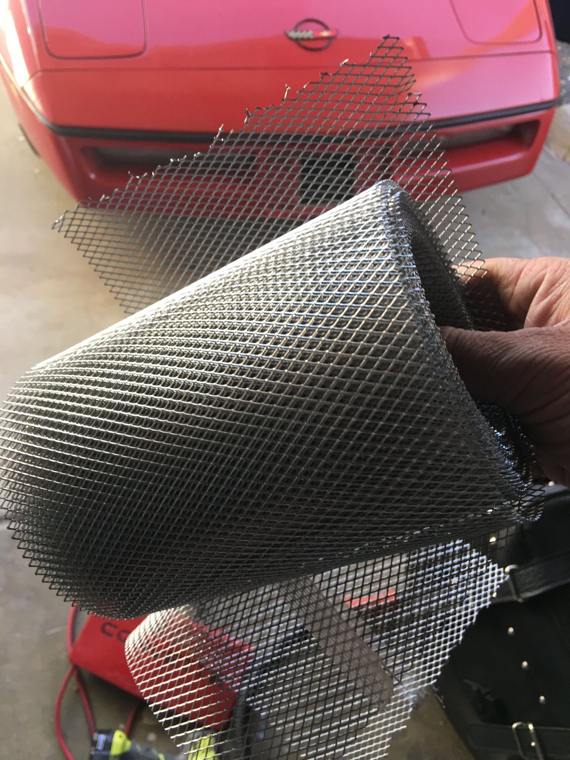

I'm sure I am beating a dead horse here. I did the air box cut out some time last month. Today I decided to make finish the free mod with ram air set up. I cut the front plate area out and placed a metal mesh with a license plate frame to cover it. This was all easy and cheap. Mainly used a dremel and cost $10 for mesh from Home Depot.
I just came back from a test ride. I actually feel a difference. I have been using a free gps track app. Prior to the mod my 0-60 was around 6.5 -6.7 and today I ran a 0-60 in 6.1 consistently. It also felt like a had a faster pick up from 60-75 mph.

Didn´t you have to cut the energy absorber pad behind the front bumper to get air through?
Or are these baffles open to the rear side?

Originally Posted by Schieby
Hi !
It is open. When you cut through the bumper you can see them, however they are really thin and didn't appear to block the flow.

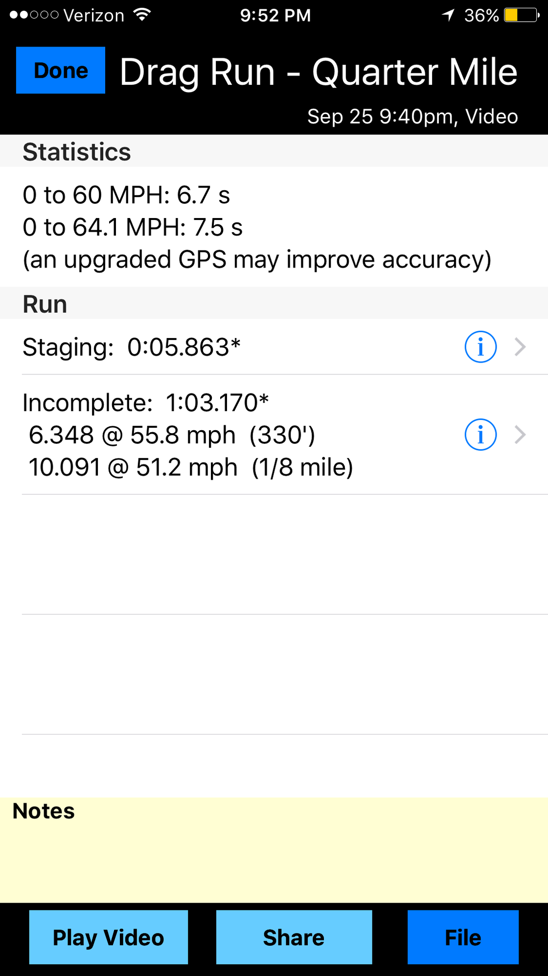

Ok here's some data for you guys. My 0-60 prior was pretty weak and even in the 7 second range on a bad day. It was about 98 degrees. Ignore the 1/4 mile as I ran out of run room. I was going for 0-60

The 6.1 speed was with the ram air same method of launching at same rpm as the 6.7 record without the mod.
It makes since to me.The stock induction system is really inclosed and restrictive. I feel like I removed a governor.

That mesh could also be installed in the lower air dam intake, to keep debris out of the condenser/radiator area
Good idea!
