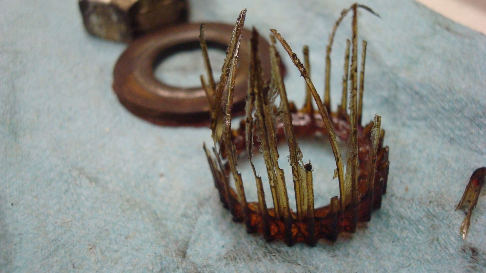

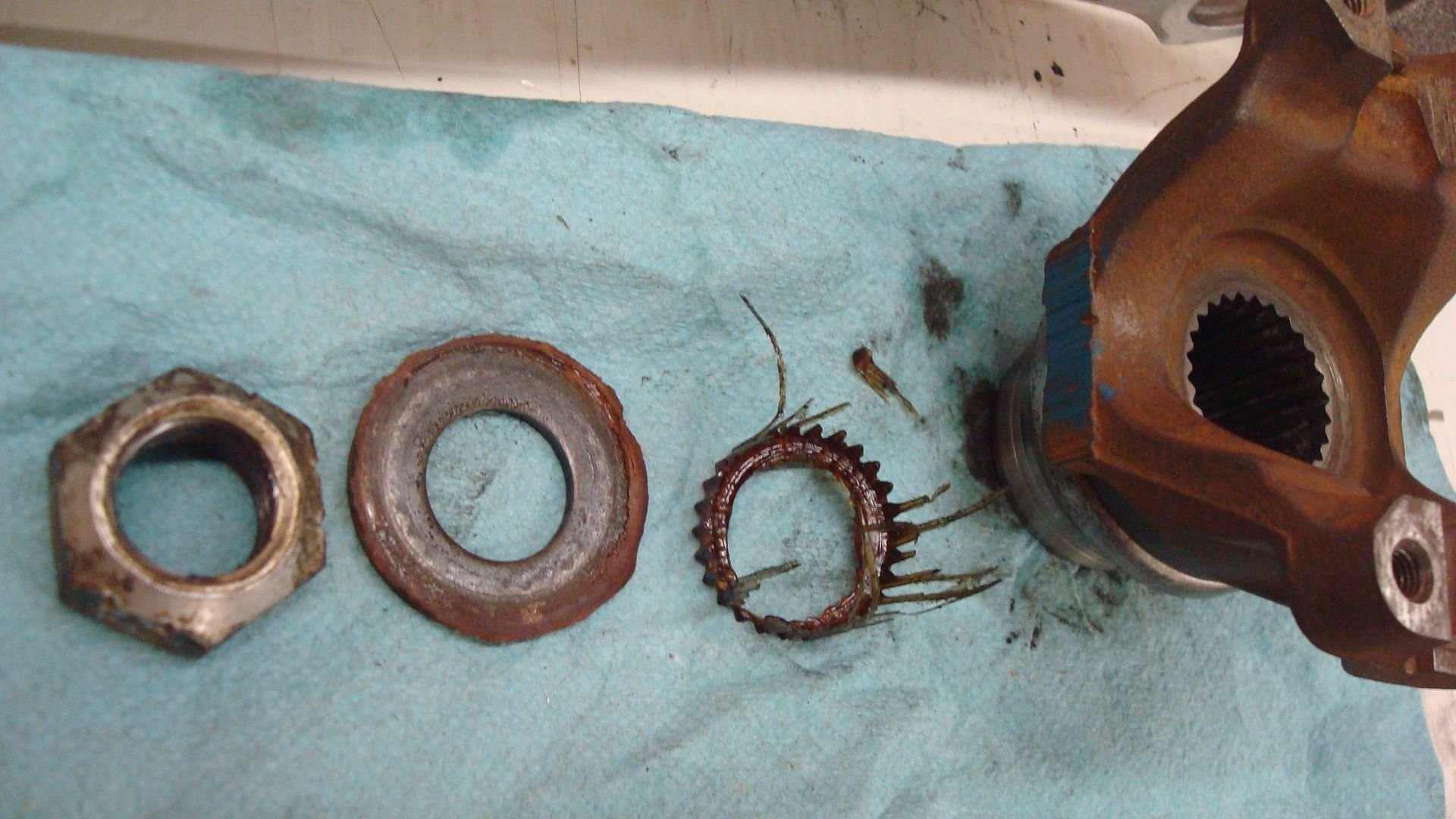

In case you guys are interested and may have missed it, I did rebuild the brakes and had a little challenge on the right rear. Here is what happened and how I fixed it.
https://www.corvetteforum.com/forums/c4-tech-performance/4050816-brake-caliper-fix.html
I
also had a couple of surprises when doing the differential seal that led me down a path of no return. I thought the seal would be the least of my problems. Here is the first thing that I encountered. Anyone see anything like this before? The seal was replaced once by a dealership years ago. I assume this the crush spacer that they put in and why the current seal was leaking. The part is plastic and is being extruded into the pinion spline.

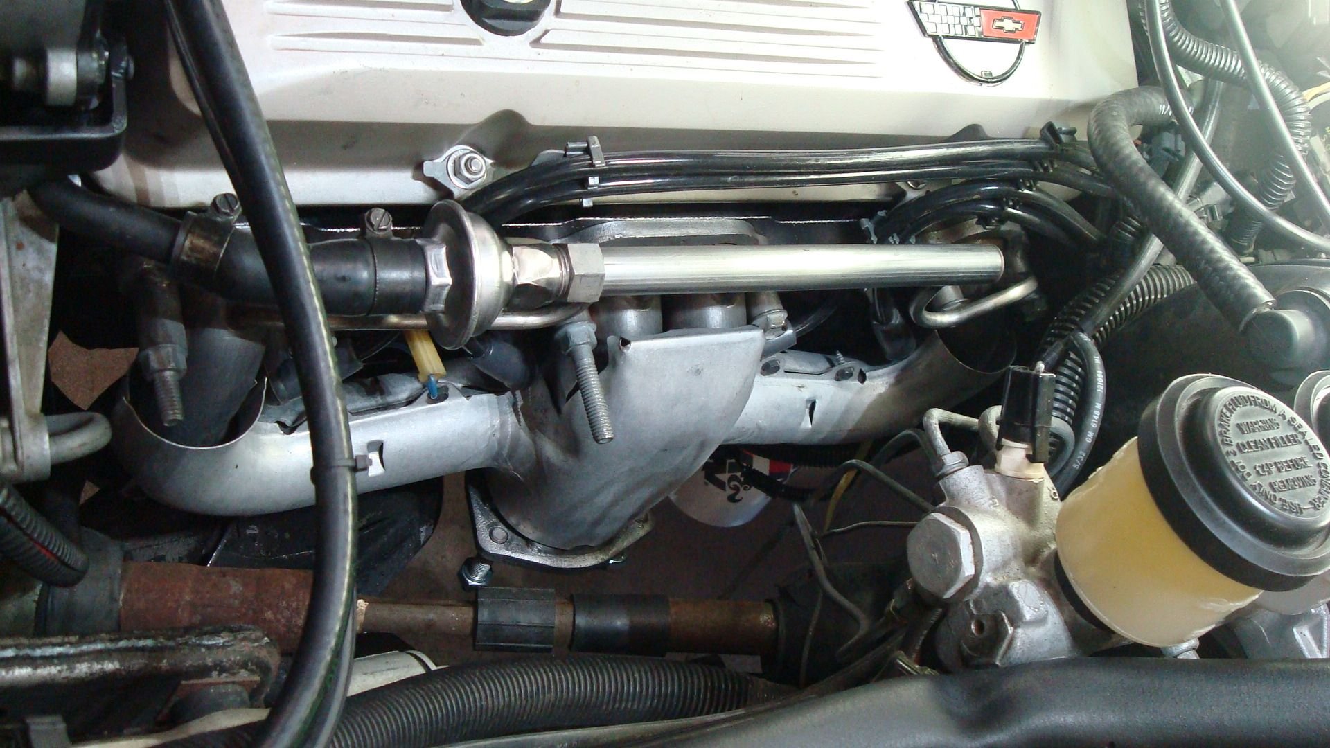

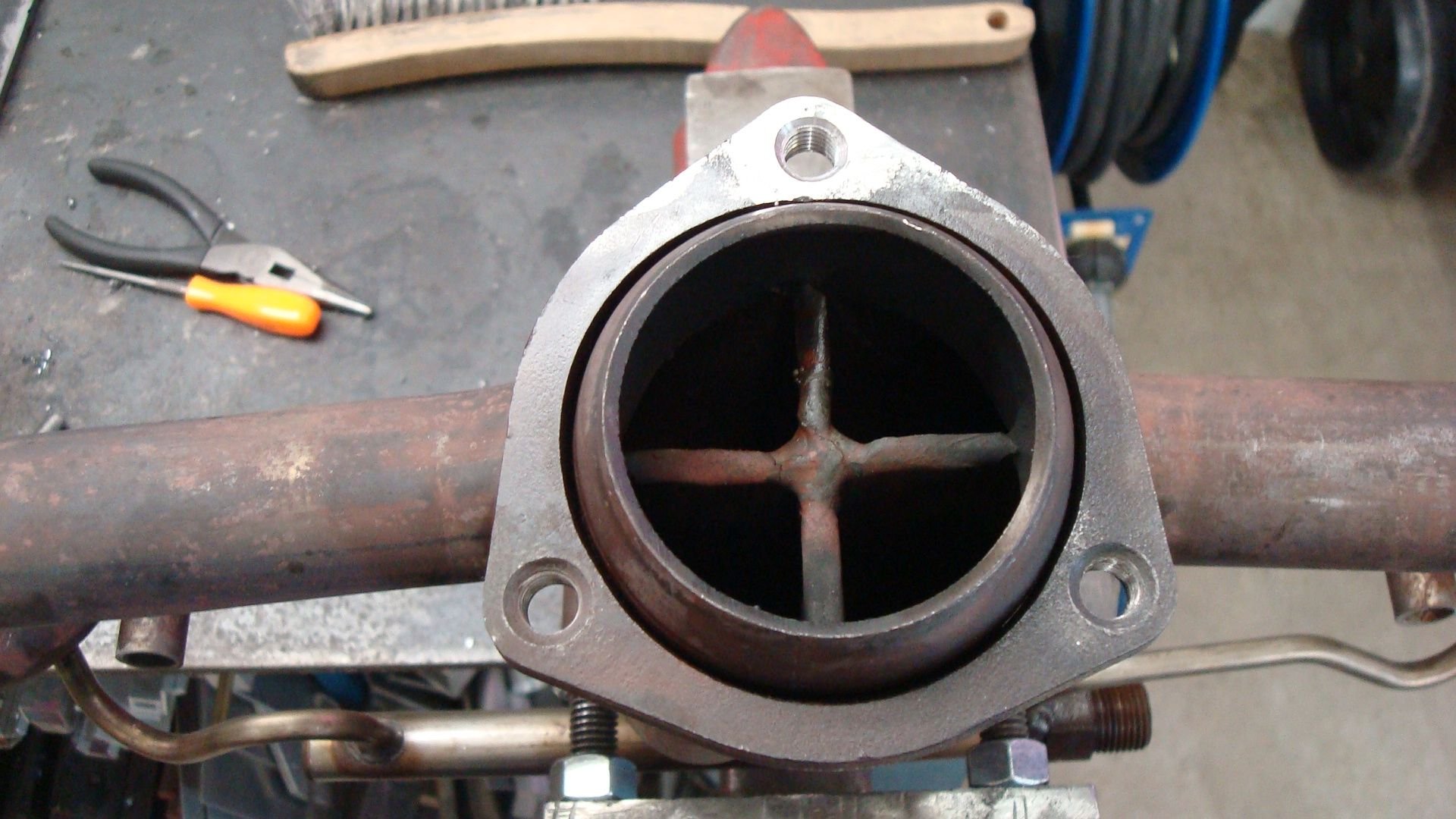

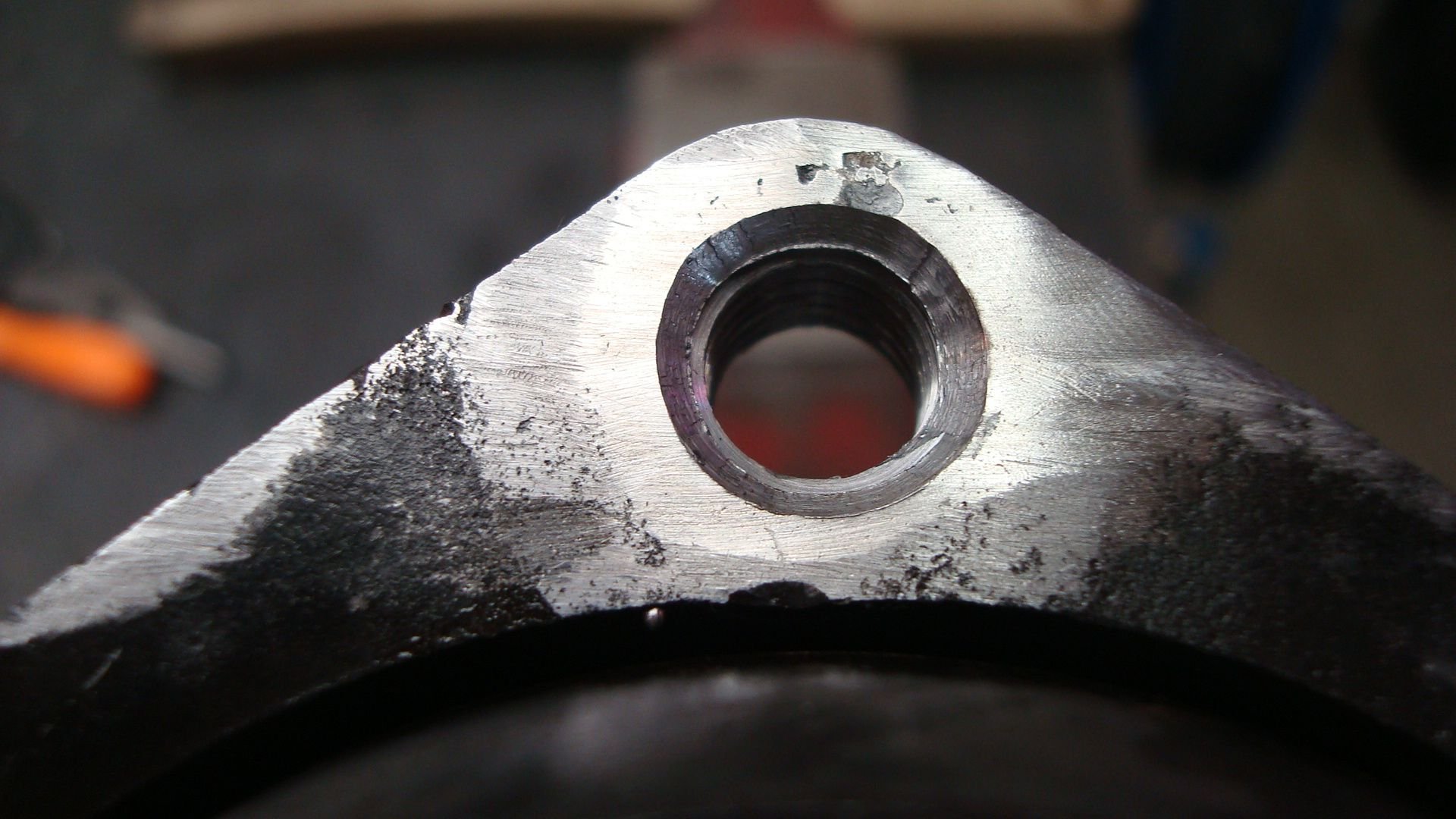

Well, as luck would have it, I had on heck of a time getting the flange of the exhaust pipes off of the manifolds. It seems all the studs were bent and me being me decided to replace them with new. I started to do this with the manifolds still in the car. And no good deed goes unpunished and I broke one clean off. There is no way I am going to replace these now in the car and make the fix. So out come the both manifolds and while they're out I did a little rust removal at the same time. Here are some pics of the whole process.
Oh yeah, I decided that I just didn't want to drill a straight hole to remove the broken stud, so I had a little welding and tapping to do. I made a fixture to make sure placement and straightness were all the way it is supposed to be.

GOOD JOB! had a similar issue on my 85 - fortunately, I was able to repair my one problem stud with a helicoil.
as a side note, replace any and all hardware, at least as much as you can, with SS, and "goop" everything with hi-temp anti-seize. at least you'll make it easier for the next guy. try permatex #77134 - nickel based and good for 2400 degrees. BTW, don't replace the exhaust manifold nuts with any type of GM OE stuff. they're plain steel, and the rust like crazy. I used copper (alloy) flanged, locknuts (M10-1.5), BMW p/n 18301737774. you can buy them all day long on fleabay for less than a buck a piece. I have used stainless, and brass alloy, plain nuts in the past, but these are flanged and a (prevailing torque) locking design - works like a champ!

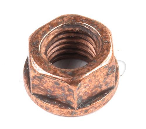

this is probably overkill, but on the last three C4 exhaust systems, I added these washers under the copper lock nuts -
18-8 Stainless Steel Washer - Oversized, 3/8" Screw Size, 0.406" ID, 0.875" OD -- they run .105 to .13 thick -- https://www.mcmaster.com/#98370a030/=19xwjk7
I originally added them to a magnaflow system on my first 90 due to oversized holes in the exhaust pipe flange. not sure if it's a habit now, or what, but the thick washers provide additional support the steel flange. as I said, maybe just overkill -
Yeah, I tend to agree with ya on this one. I don't think they are really needed either. I will evaluate when I go to assemble them. I think I already have some stainless washers in my supply.
