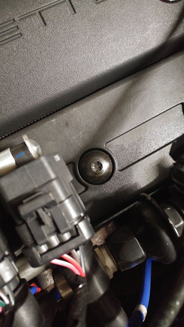

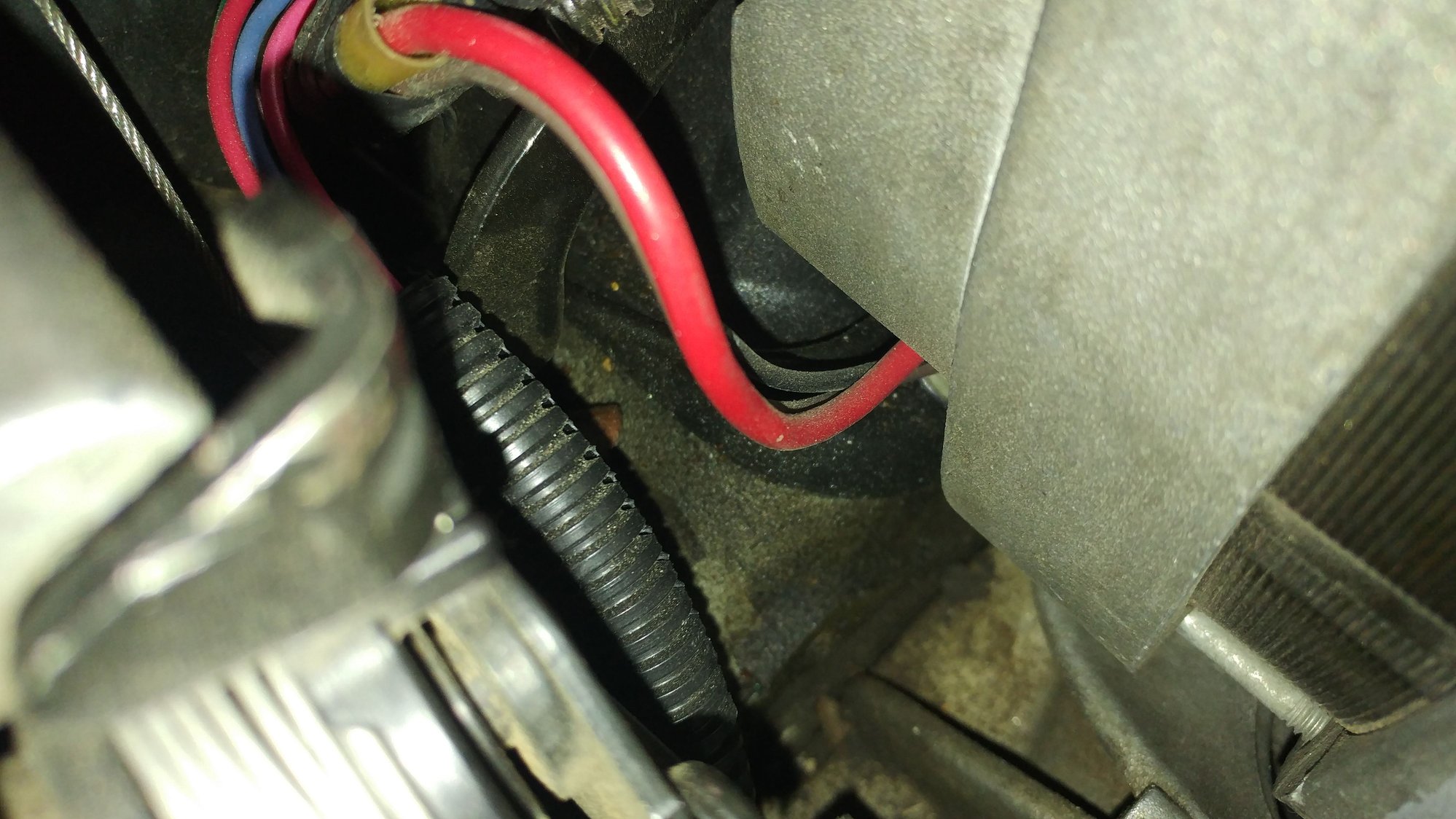

Started smelling it every now and then. Here are some pics. Just thought I'd ask before take stuff off. Weird, because I used felpro gaskets when I changed the valve cover gaskets, in may 2014.

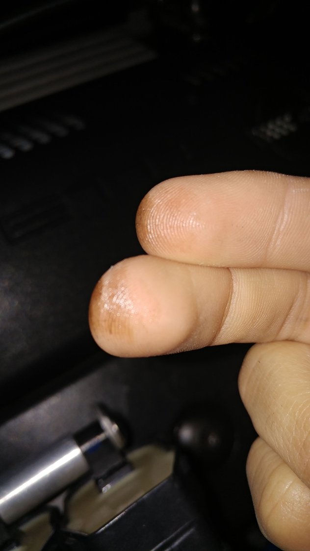

This is how my fingers got when I put them where valve cover meets the head, on the left side.
I don't know why oil comes out of there. The bolt is tight.

which fel-pro gaskets did you use? VS50443R are for the 93-96 composite valve covers and are supplied with sealing (washer) gaskets for the mounting hardware. when you say the bolt is tight, are they torqued to spec? (106 in.lbs.) I've found in most cases, over-torqueing VC hardware causes leaks.

I probably did over tighten them, and yes it did come with the sealing washers. Oh well, at least it is an easy fix. Passenger side is dry as can be

That's what I do for the most part. But when I popped the hood to clean it, I saw oil on the head, right under the valve cover. I'll just remove it, see what's up.
