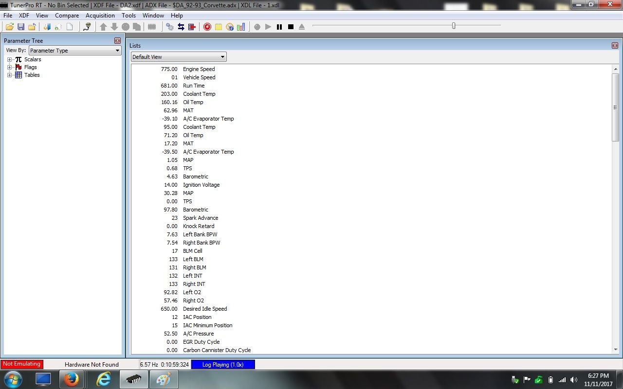

Does this look OK?

Wondering why there is a disparity between the right and left O2 sensors?
Could it be that they are cycling and you just caught it at that point? They should cycle up and down constantly.

Forgot to mention, sometimes at startup it has pretty low idle. Sometimes I shut it down and then it idles fine after the second start. I replaced the relay already. I would post the actual log file but don't see how I can do it on here.
I don't see a low idle. Look at your "Desired Idle" and "Idle Speed". It wants 650 rpm and you are at 775 rpm.

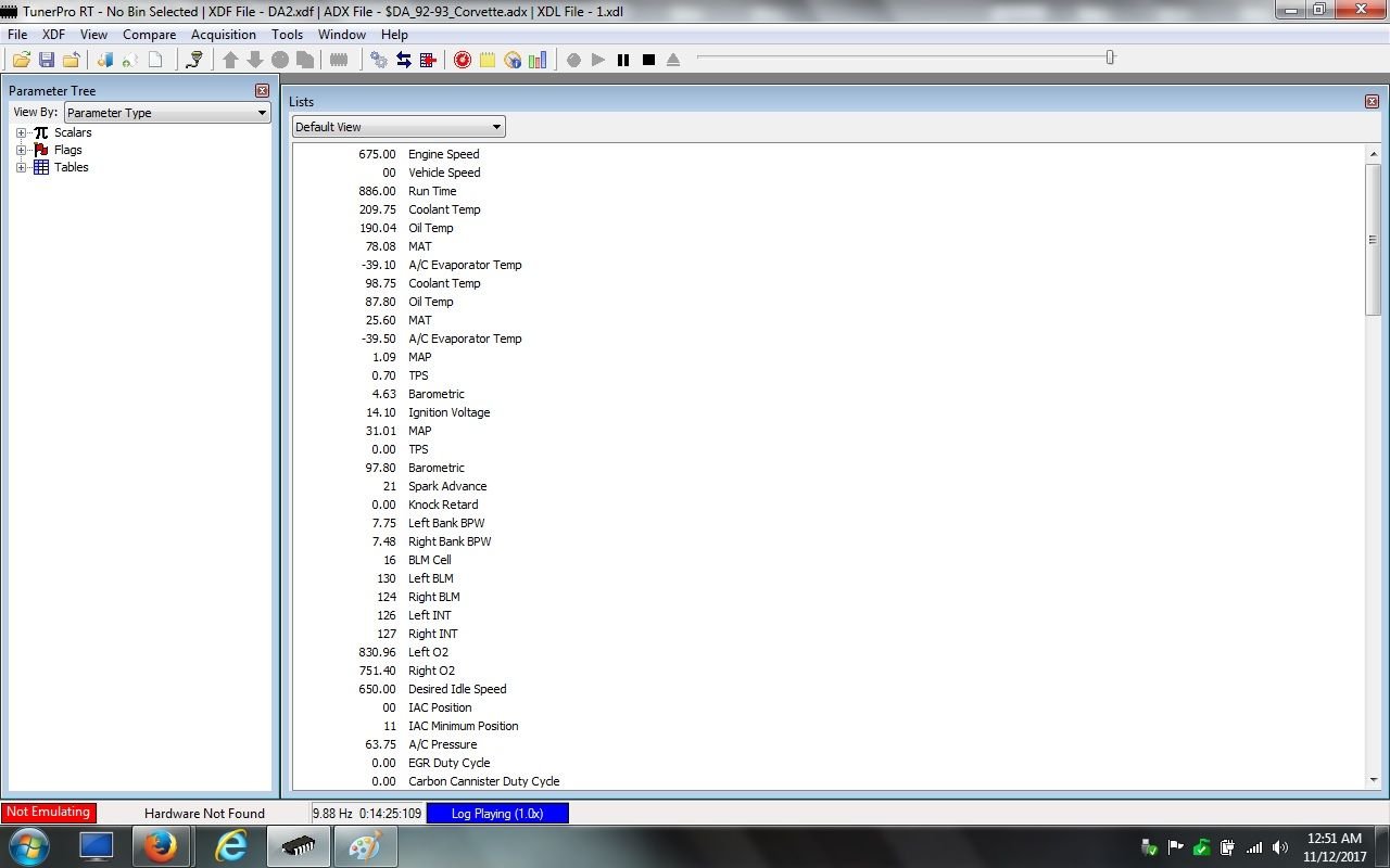

I was driving it at the time, once I start driving it the idle is fine. Sometimes after I shut it down then restart in a bit it idles low again but after driving a bit it will idle fine with no problem. It only happens at start up, whether the engine be cold or warm. Here is an idle capture when it started fine and engine warmed. Still has the slight misfire though. I will try to make a video of the file.

Lets try this. With the engine at stable operating temp, everything but the motor off and idling, what is the IAC position, give or take a few? It should be around 20-30 counts. It can fluctuate but not fall off to 0.

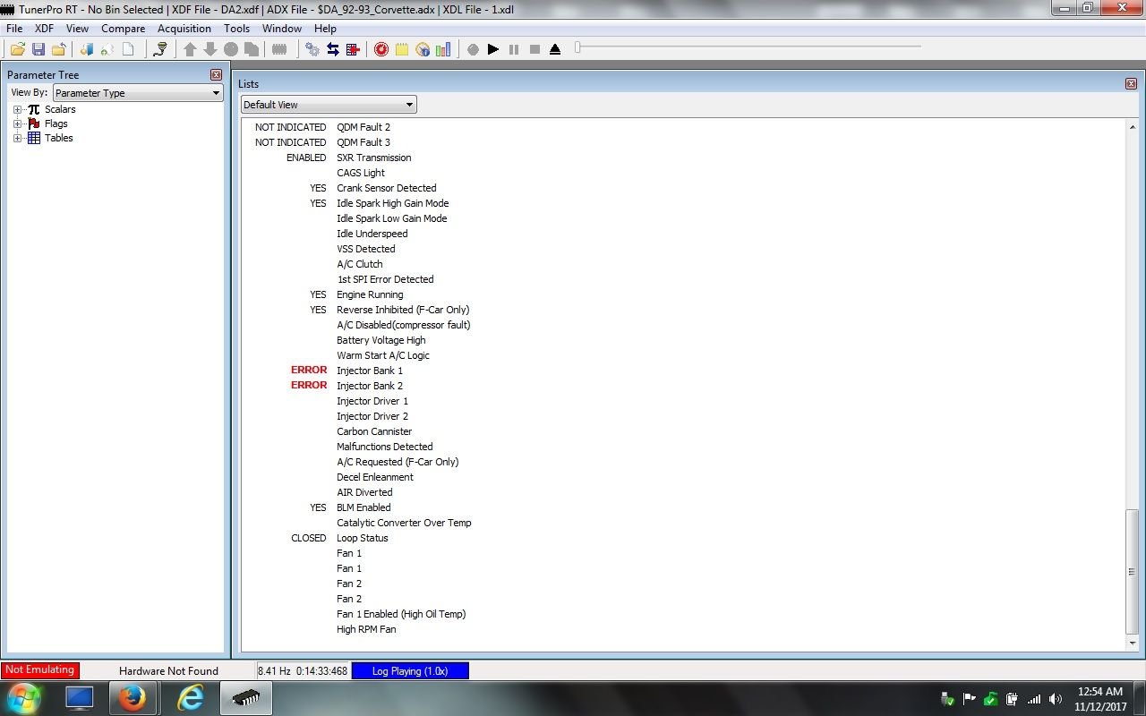

I forgot about this. This is one of the reasons I feel I need new injectors.

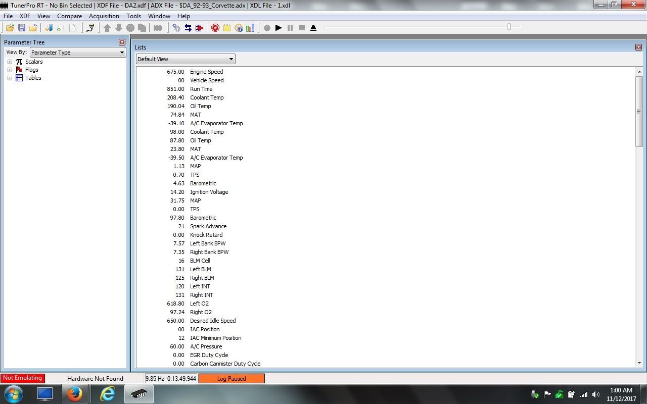

This one is toward the end of the log after warmed up and idle. It was a little cool that day so I may have had the heater on, I don't recall. The IAC readings pretty much stayed at those readings about that time during the play back.

IAC 0 means it is unable to adjust anymore because too much air is coming in either through a leak or the screw is set too far in.

One snap shot is almost useless. You need to do some graphing with fuel O2 and IAC values all in the same graph to see if readings are similar but out of phase. I am betting there is a vacuum leak somewhere with IAC so low.
