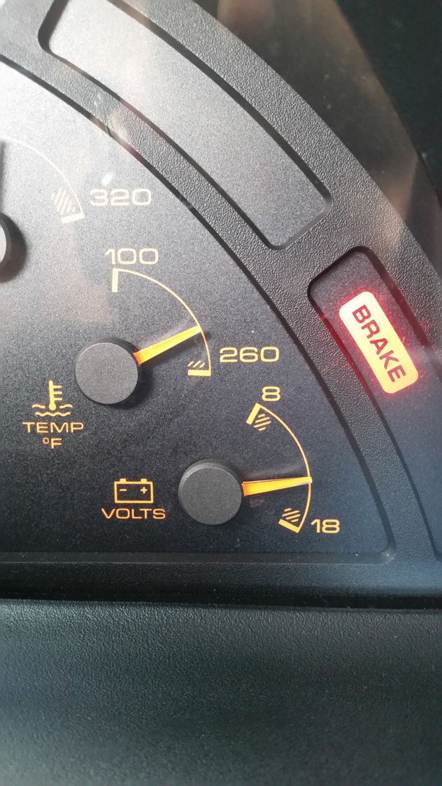

91 6 speed. My primary fan seems to turn on late (picture below) Or is it normal
? Anyway, my secondary never turns on. Not even with the AC on. When I ground to check the codes they both turn on so I know the secondary works. Any help? Thanks.

Joe, it sounds pretty normal.
BTW... you analog gauge is a "close representation" and not an exact measurement of your temperature. T.o double check you should hit your engine with a thermo gun
Good to know. So what about the secondary fan? Isn't it supposed to help the primary fan with cooling the radiator or block?

From: Lansing MI
It doesn't come on until 228. Your pic looks normal to me.
It never came on though even when it reached that temp.
How do you know it reached 228?

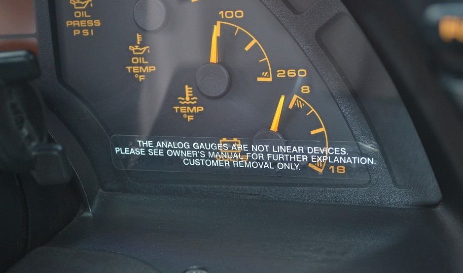

That analog gauge does not have a linear scale, and it almost impossible to tell what the real temp reading is.
Unless that needle gets close to the "shaded" area of the gauge, you probably haven't reached the trigger point of the fans.
