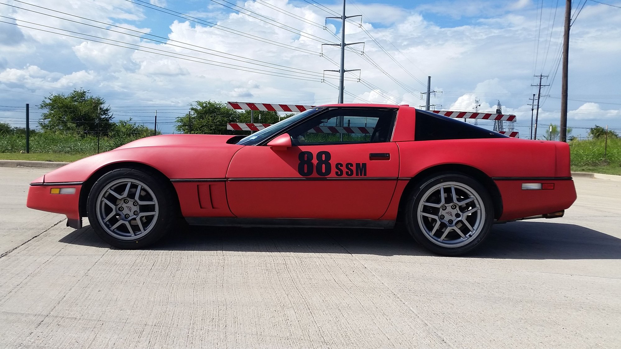

Finally got a chance to install the ported heads and big cam I scored from my dad (aksracing) from his 87 vert.
Added a Victor Jr intake with some port matching, and some longtube headers to complement the package.
Swapped out the diff for a 3.45:1 gearset D44.
Running the original 4+3 trans, but I have a ZF6 ready to toss in.
The car weighs in below 2900 with 1/2 tank.
I converted the front suspension to coilovers last year, and I love it.
This car is starting to get a bit rowdy, and I'm looking for some traction advice. It is very unpredictable on nitto NT555 G2's in stock size, but seems pretty happy on Toyo R888R's in a 315 width. It just has quite a bit of oversteer.
The car is very light. It's gutted except for the driver seat and dash. Only has the basic accessories needed to pass inspection and make it run. No A/C, ABS, computer, etc.
I am retiring the car from autocross as it isn't competitive enough in it's class (SSM), and I'm looking to do high speed 1/2mi and 1mi events.
(We are running the 03Z06 next year)
So... stick with leaf in the rear and upgrade the shocks, or go ahead and swap to coilovers?
Add ballast to the rear? Soften up the rear bar?
