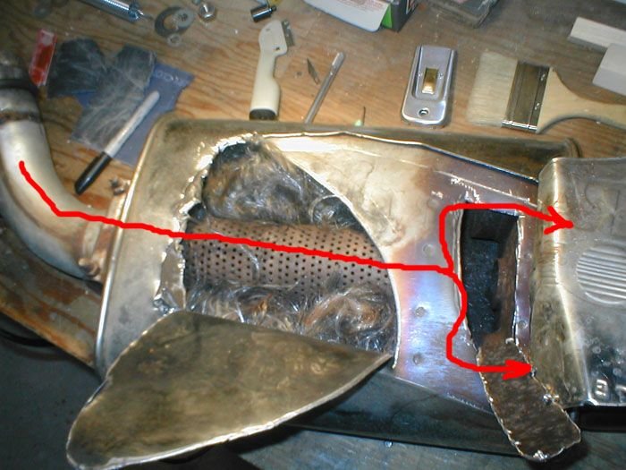

Originally Posted by SuperL98
Interesting thread ... looked thru my saved muffler images and found this one.
Might be the Vette Corsa ... think I saved it from this forum?
Cool picture. It seems that Corsa does the "fake" dual similar to the ZR1 factory muffler.
I hate fake. Fake *****, fake news, fake duals. Fake.
The good news is that they are in fact using the folded-chamber quarter-wave resonator design like their other mufflers. So that's nice.

Some others I have....
The DynoMax SuperTurbo for the L98 (I cut this one open)
It has two open outlets, but only one is a direct path, the other just open to the last chamber and just makes noise.
These droned like crazy and welding the fake one closed made them almost stock quiet.
The DynoMax UltraFlow for the L98 (Cut by me also), actually has two full open outlets, but they extend way into the chamber.
Droned like crazy also and plugging one side helped, but still a very loud muffler.
And someone else posted these labeled stock ... stock what I don't know.
What the path inside is ... I can't figure?

Originally Posted by GREGGPENN
I suppose you could get into the issue of perforation -- which reminds me of the comparison of a smooth vs turbulent intake tube! I'm going back to the 2000cfm though!
Yeah, I think in the Walker's case the holes are just holes: they don't have edges that protrude into the exhaust flow. If they were to have protruding edges, then that gets really restrictive really fast. My guess is that Magnaflows are similar in that respect.
Sorry to veer slightly off-topic again, but....Thanks for this pic! It never occurred to me before:
In looking at the cross-section of this "performance" muffler makes me feel less "bad" about shoving those SideEffects up the butt of my 383! This muffler makes the same (dumb?) 360-deg worth of turns before exiting to it's final destination.
Now THAT'S more like what I call tight radiused turns.
I wonder if the first "Turbo" muffler is an attempt to put the two outlets slightly out of phase? If the left half of the initial inlet continues straight to the right outlet -- while the other half winds around to the other one, the outlets have different timing. (Not sure if phase is the right word here). Maybe the out-of-synch exits were supposed to accomplish some sound abatement?
That last pic might be the factory leveraging helmholtz resonance -- where sound bounces around in TWO of the internal tubes canceling soundwave in the front chamber. The lower outlet is probably a dummy. (The back 2" is likely a chamber that connects the middle and bottom tube...while the other outlet passes through it...w/o exposure to that rear chamber.) That would create a canceling wave that ran smack dab into the oncoming inlet waves....before the gases pass over the the other outlet.
