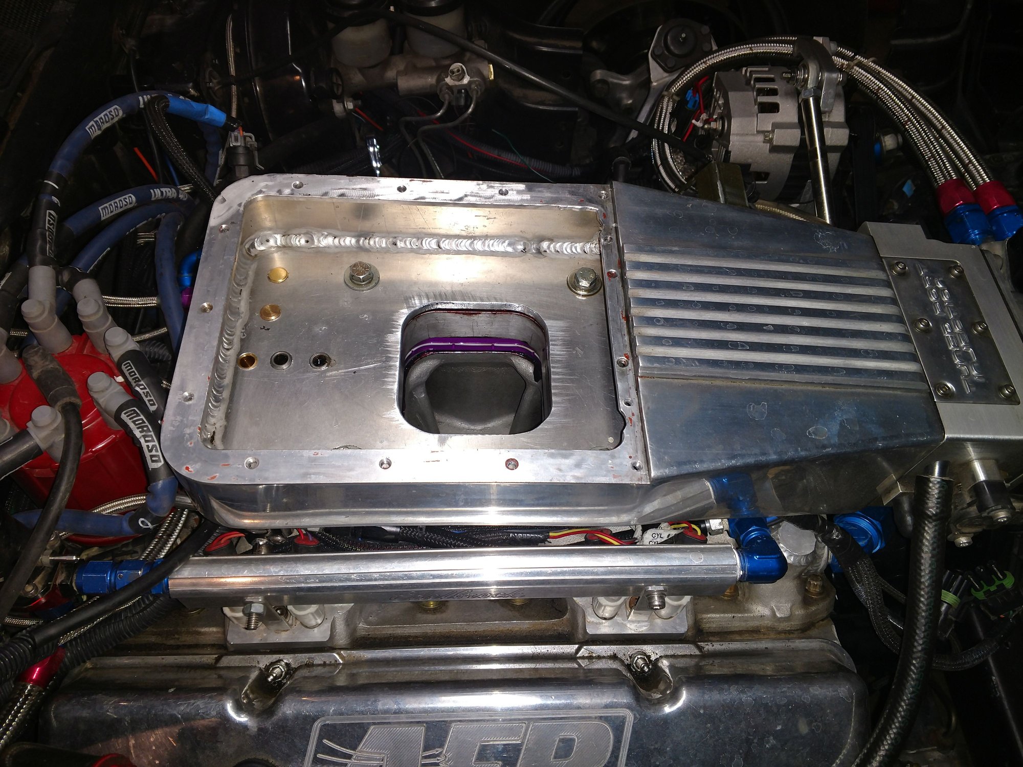

Here is my setup. Vic EFI with Accel Prototype plenum.
Pop the lid for a little surprise...
Zex perimeter plate.
