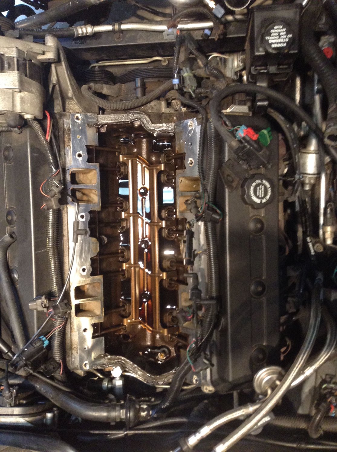

Welcome
Here's a photo of mine with the intake off, the China Wall is the area at the top and bottom of the photo. I happen to use The Right Stuff to seal the area. Would strongly recommend you get a Factory Service Manual (FSM) for your 94, these can be found on eBay and sometime here on the forum.
Don't forget to ask for help if you get stuck with something, everyone hear is a great source of help.
