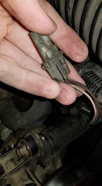

I looked at the coolant temp sensor and noticed its hooked up to something with one white wire that is spliced into a black wire.
That black wire is just sitting here cut off and there doesnt seem to be anything to connect it to.

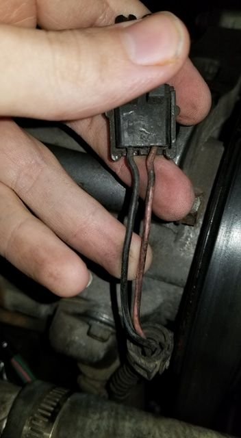

I found a 2 pin connector with a black/grey and pink wire. It's coming from the drivers side of the wiring harness. If anyone knows what this is supposed to be connected to please let me know.

Pic two shows where the ECM temp sensor should be. It should have a two wire connector, what they have there is some kind of butchered one wire connector. It's a very common sensor. That sensor will cause all kinds of problems if it's wrong or malfunctioning. BTW the one next to it with the Bosch style connector is the cold start temp/time sensor.
Pic three looks to be someones bodged attempt at something. Can't tell what that is.

Thanks for the help. I already have a coolant temp sensor + connector on the way so I hope to have that remedied soon.
