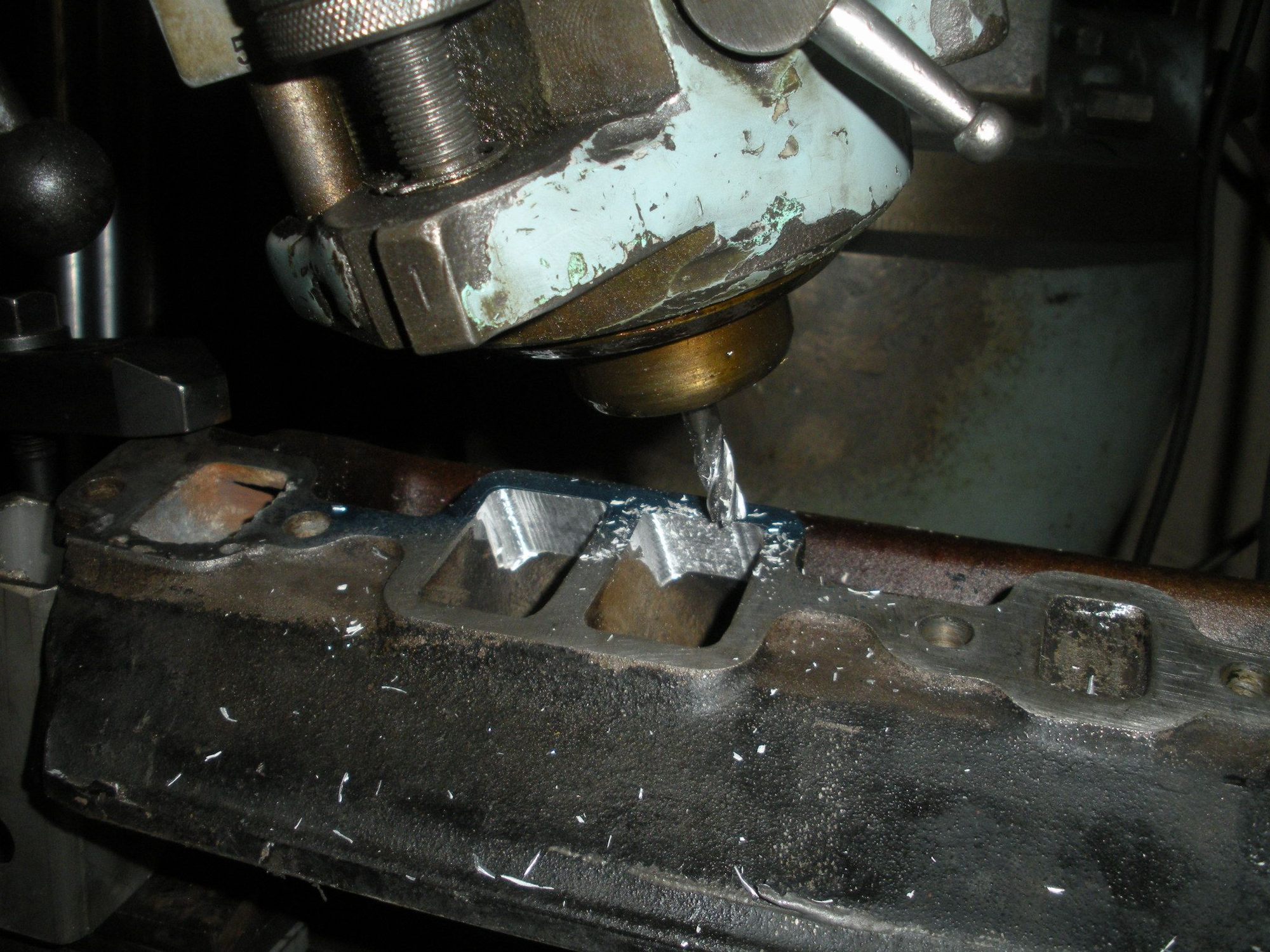

Originally Posted by 1984Z51auto
I know that you are looking at the short block basically, so the biggest difference between motors, which was the holes in intake runners connecting adjacent runners in 1984 does not apply (I believe that was the defining change 82-84).
Since you brought that up (even though it doesn't apply to the OP's question), have you figured out a reason for those holes between the runners in the '84 intake manifold?
A long time ago, I believe I read that the holes were there to improve cylinder filling, taking advantage of the pressure waves in the adjacent runners in the intake manifold. Unfortunately, I can't recall the source of that enlightenment. There was some work, also years ago, in changing the size of the holes in the stock intake passages to gain further advantages. I must admit that switching from the '84 with 205 HP to the '96 with 330 HP kind of erased my memory banks!
By the way... nice port matching job!
Thanks, but that was only the first cut to a very extensive porting job. If the holes were there to improve air flow, why the h*** were the ports made so small? And those weird holes are only in four of the eight intake runners!! Somehow, they must have improved the torque curve characteristics. Opening up the ports for good port matching was a MUCH better answer to that situation!!
Sorry for the diversion. Let's get back to the OP's question.
