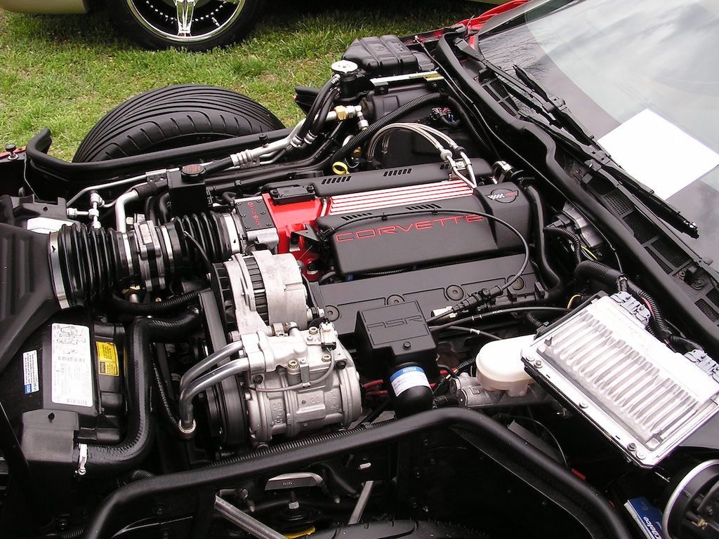

I have used plenty of soap and water over the years on my '96.
Hot soapy water, Simple Green, various scrub brushes, etc.
No High Pressure power washing though, just a normal household garden hose.

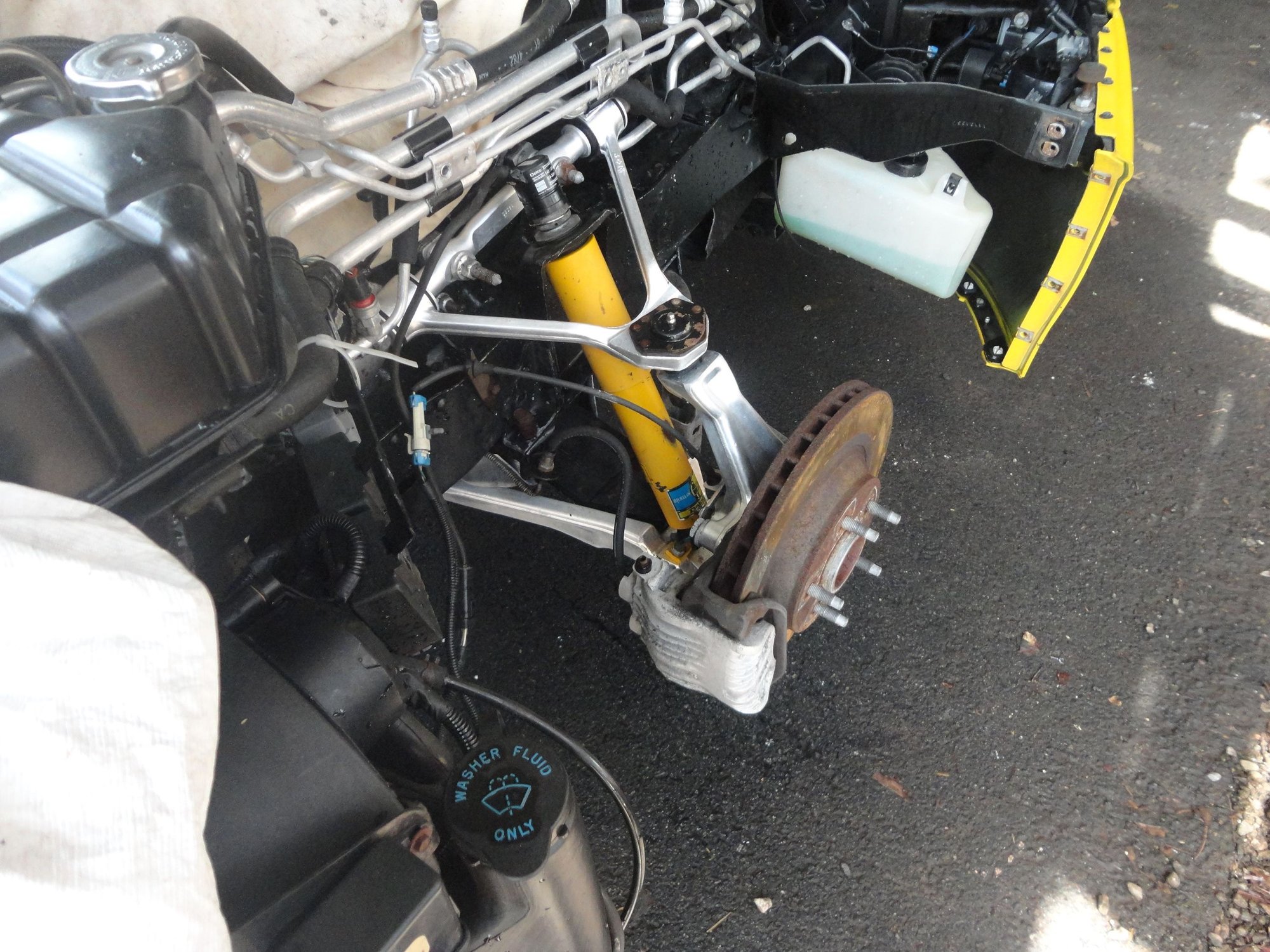

Best way to get at all the spots around the bay is to remove the inner wheel wells.

, and might as well add, for a detailing spray, I like stoner's trim shine. BTW RollaMo, what are you using?
very nice - looks showroom new.

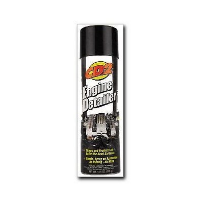

Thanks for the compliment!
I am using a product called CD2 Engine Detailer.
But you can't hardly find it anymore.
I have also used the Stoner Trim Shine you are, and like it too.
Believe it or not, that car has over 124,000 miles on it.
Don't drive it as much as I used too, but it has been on quite a few long road trips.
