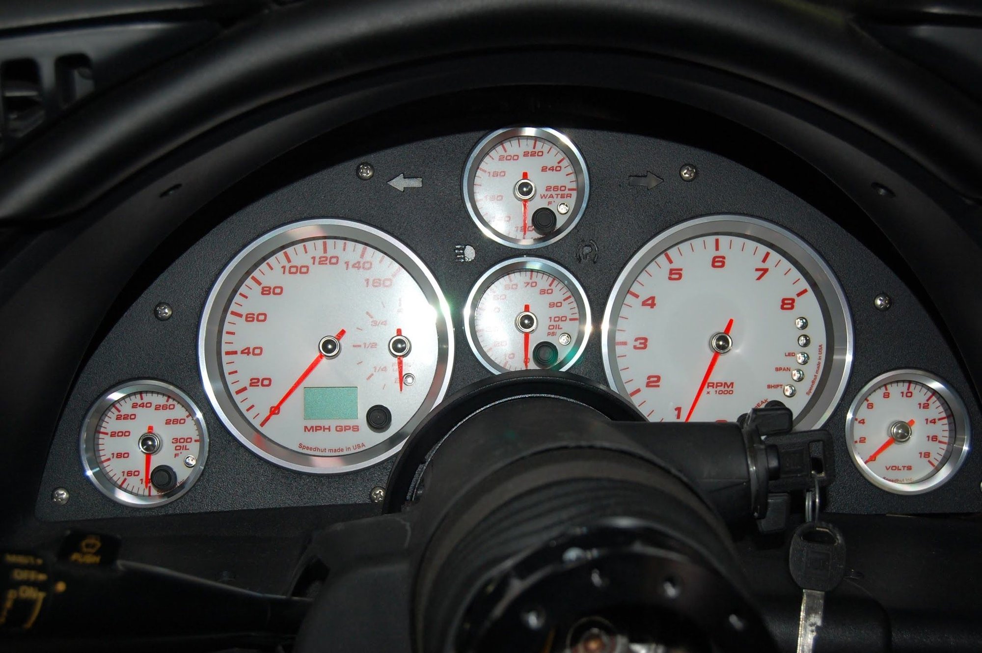

A small update. The new dash is about finished...
