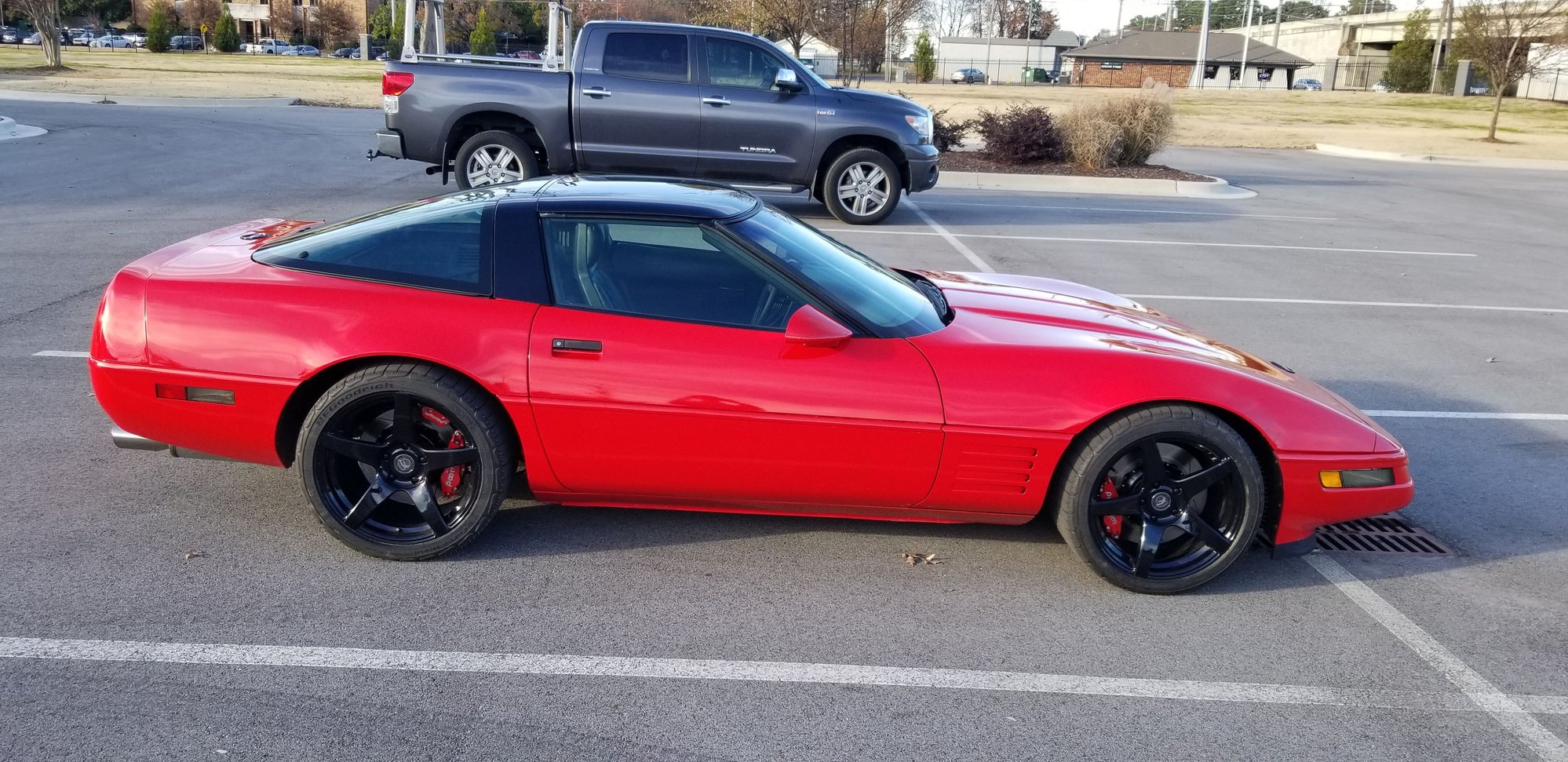

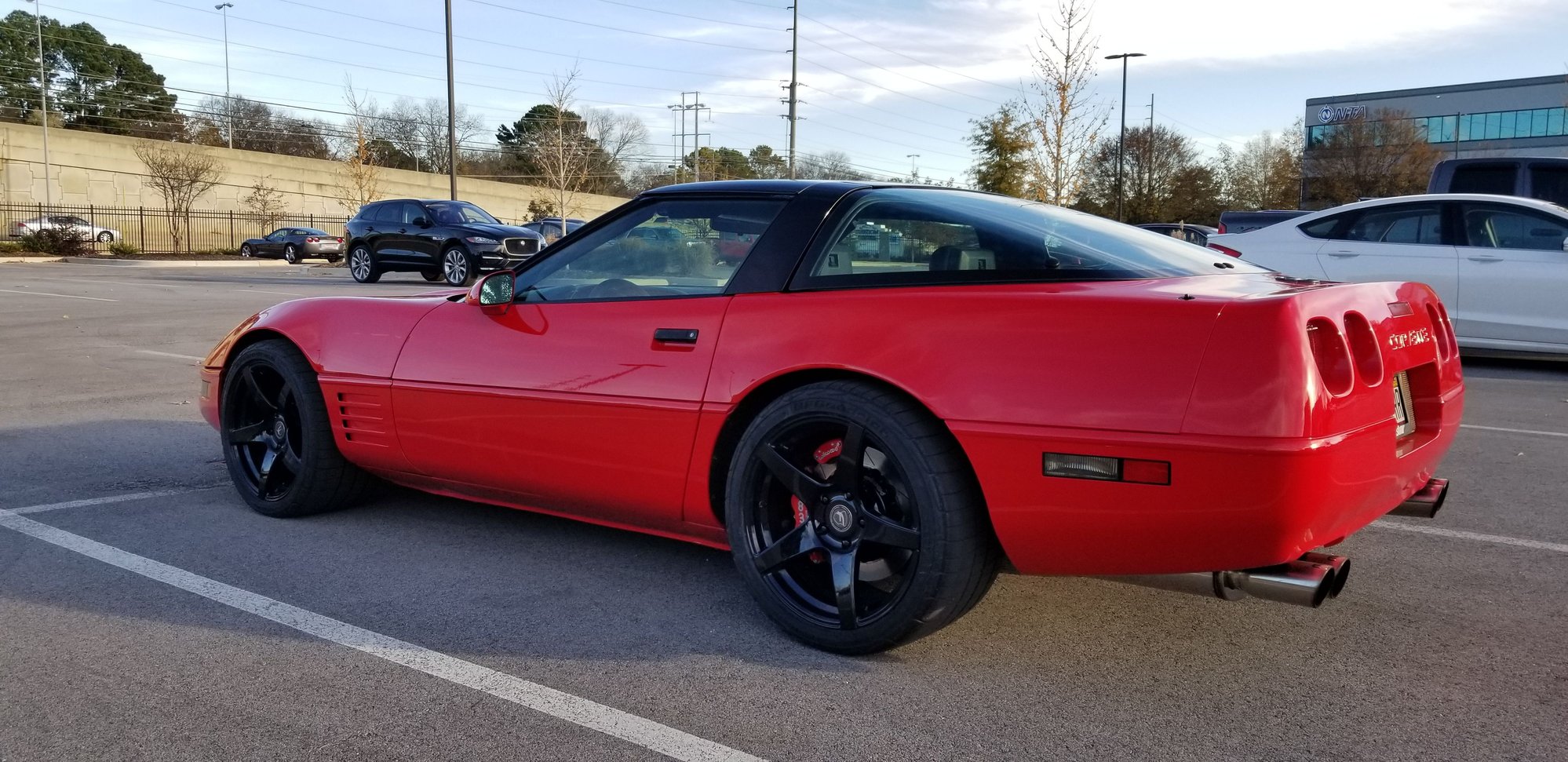

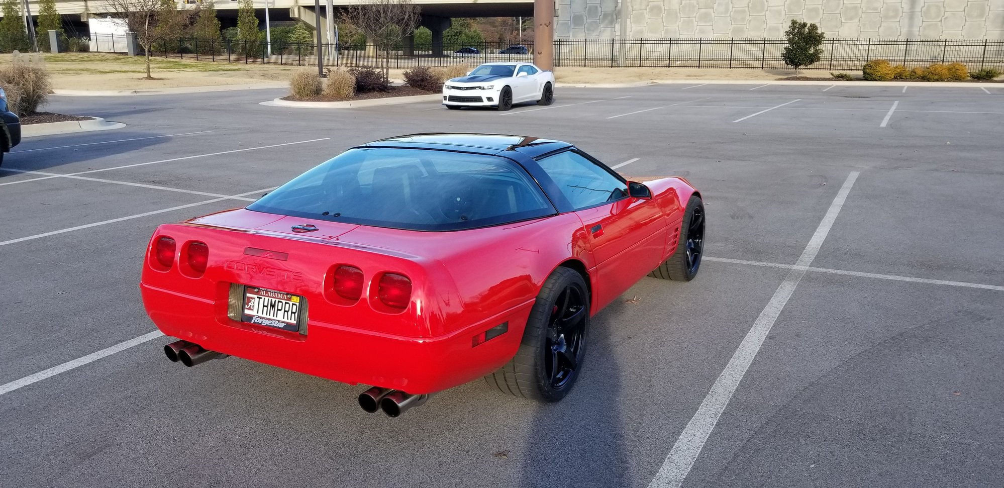

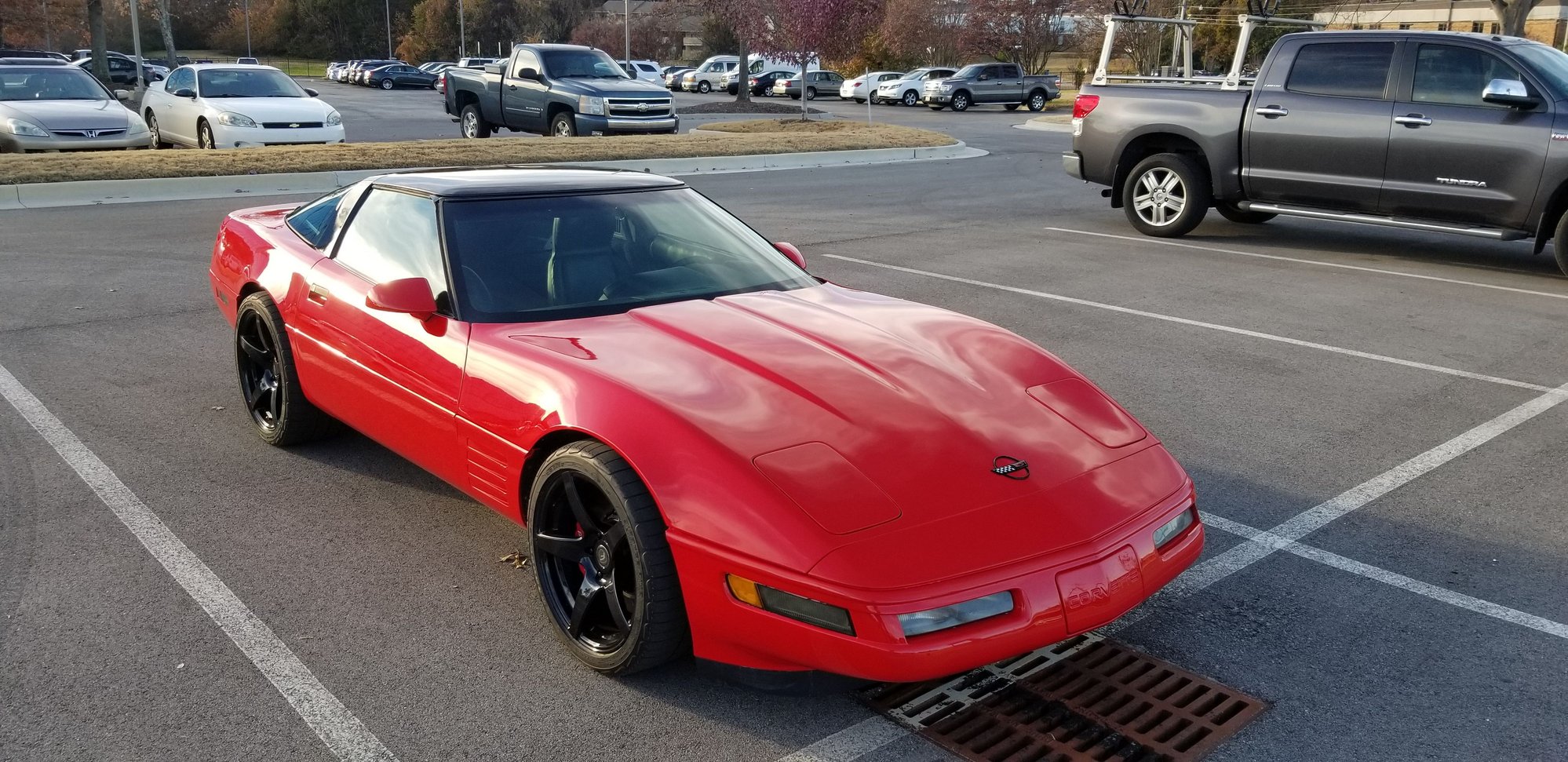

Turns out it was all cya, the car does rip. It's an animal. There is so much front end grip it feels like it's gonna swap ends. I've been daily driving an AWD Audi S4, so I'm not really used to that much responsiveness from the front end. Will have to go slowly getting used to this thing.

looks Great !

WOW!!!! I just saw this thread an read the whole thing. Great Build! I'm jealous.
