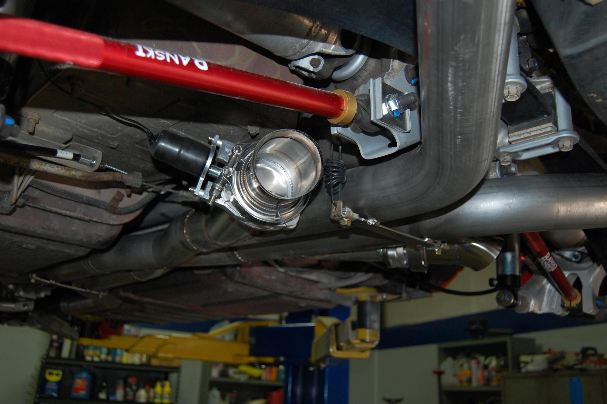

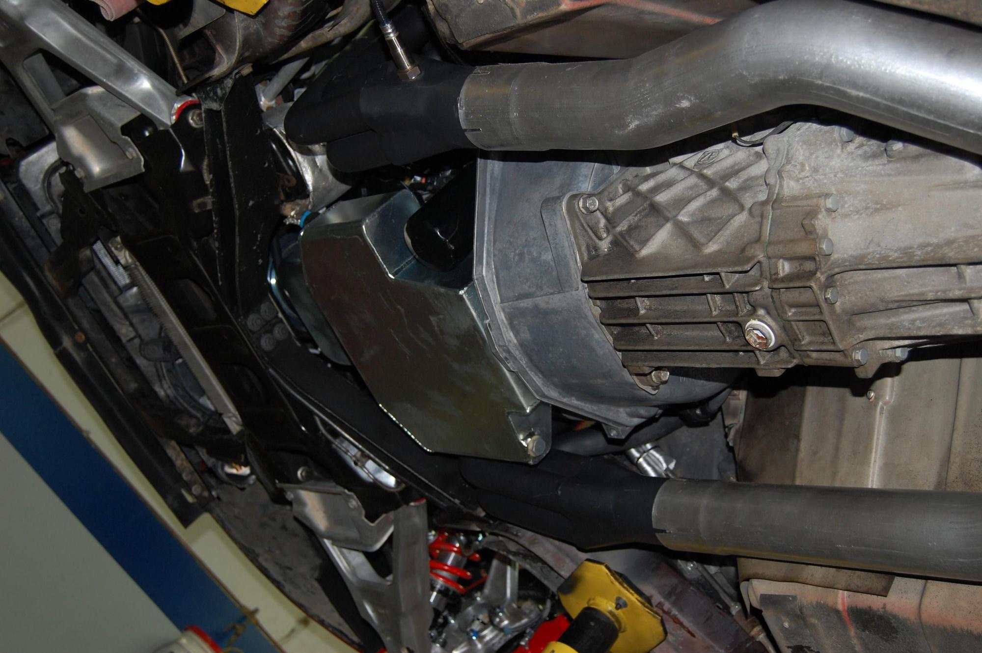

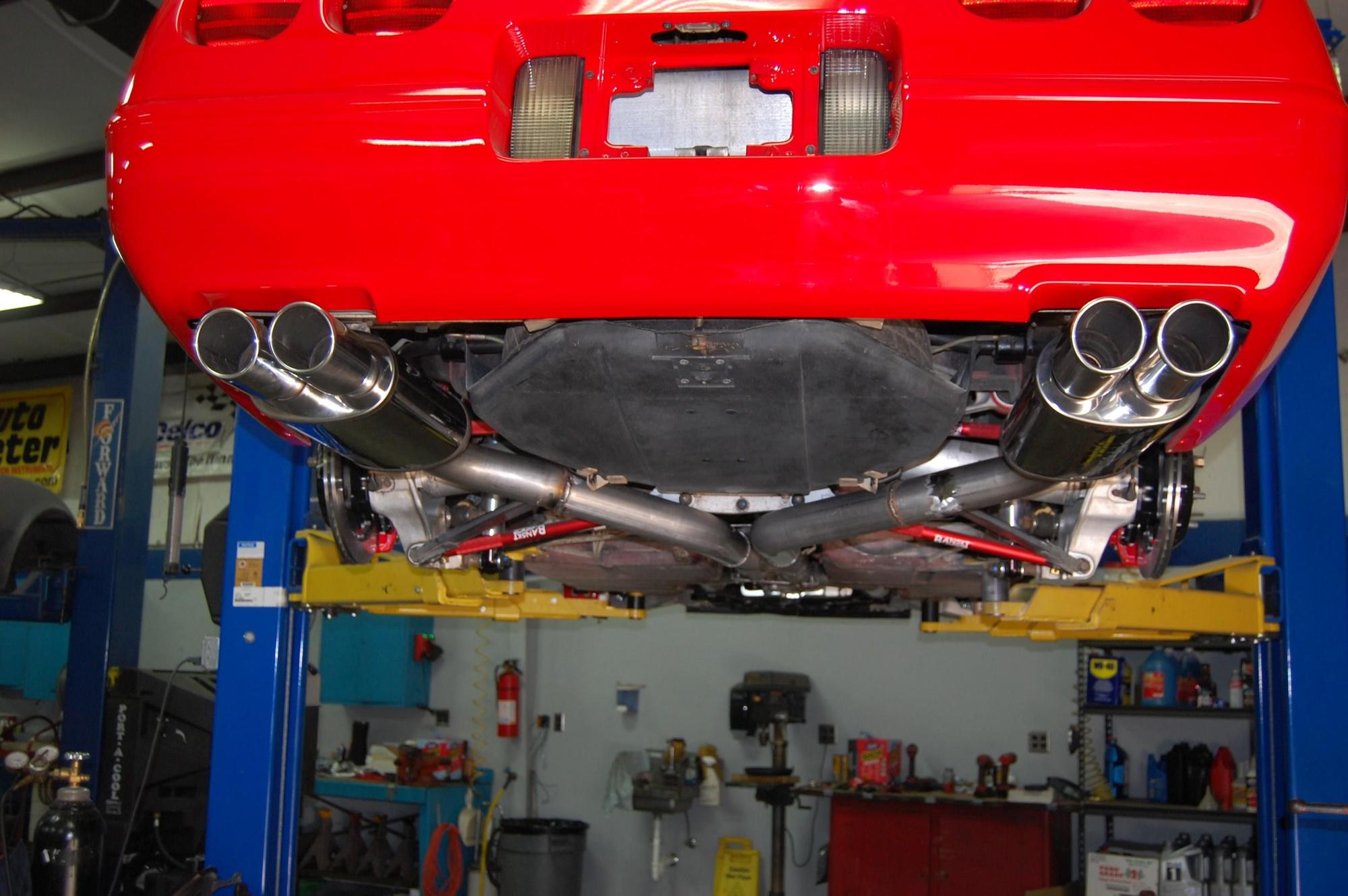

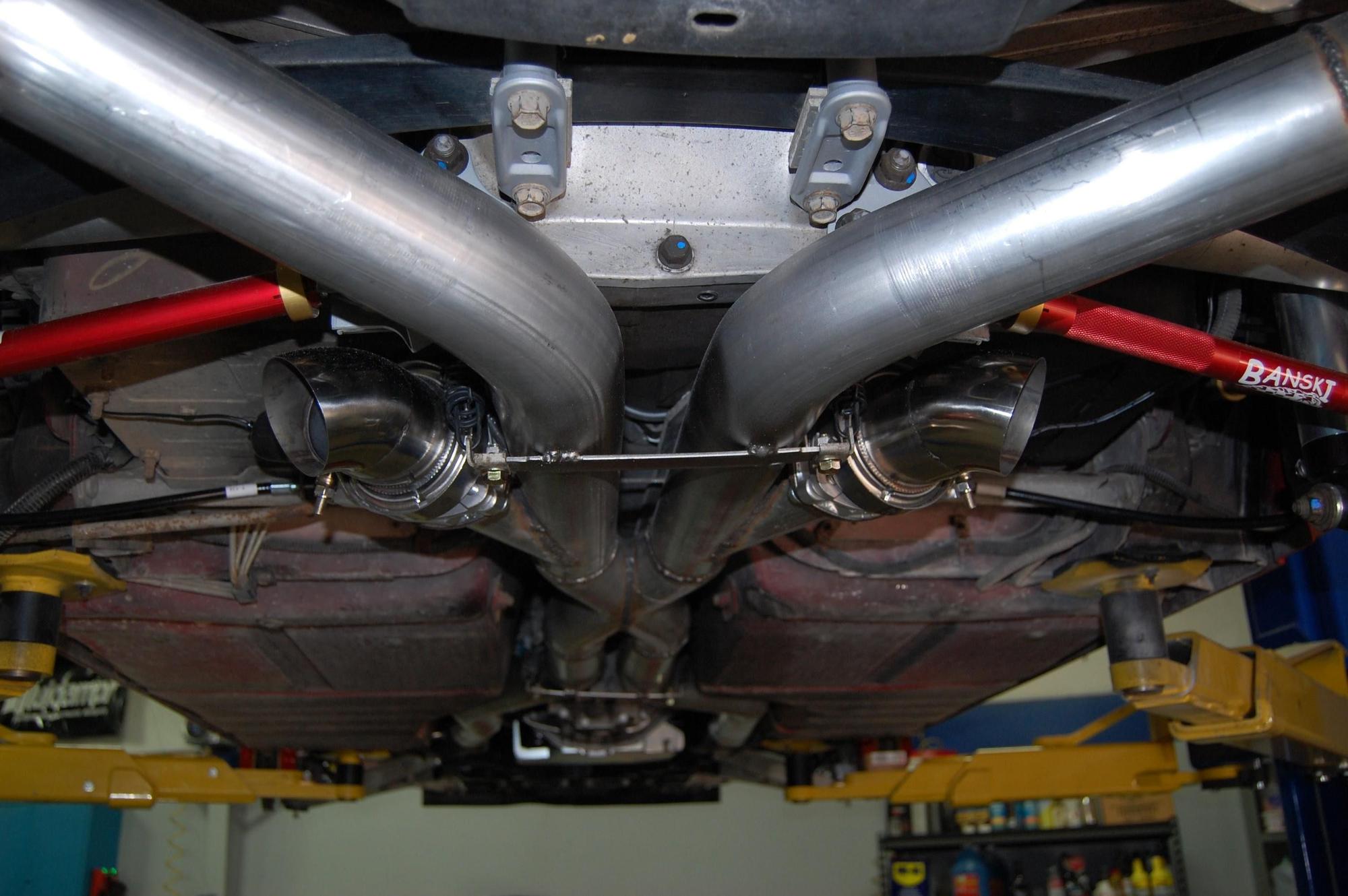

Finishing the exhaust system and hooking up the spring bolts. Probably get the car two weeks from this Friday.

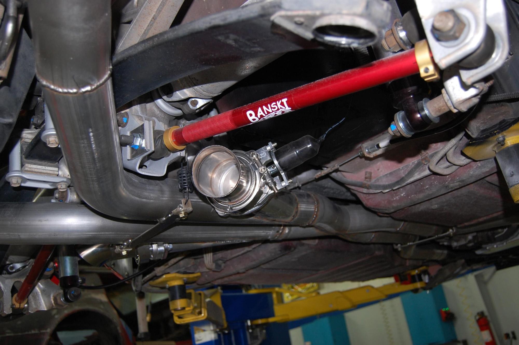

Are those "Doug's" cutouts from Jegs? I had some of those on a CTSV and they worked great, until they didn't. Had one side fail so returned both and used cover pates. Love this build btw can't wait to see this thing running with the Holley setup
Quick Time...http://www.quicktimeperformance.com/QTEC/
I take that back...they are Hooker cutouts....

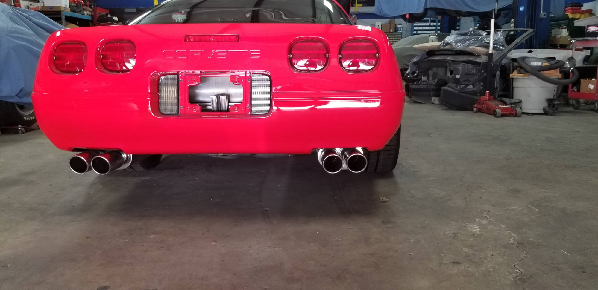

Car is running now...will go to the alignment shop next week...then to the dyno the next. Should be finished in a couple of weeks.

Sounds great! People complain about MF systems and the drone/quality, but IMO it’s still the best sounding c4 muffler. Especially with long tubes and a healthy cam.
Looking forward to the dyno #’s

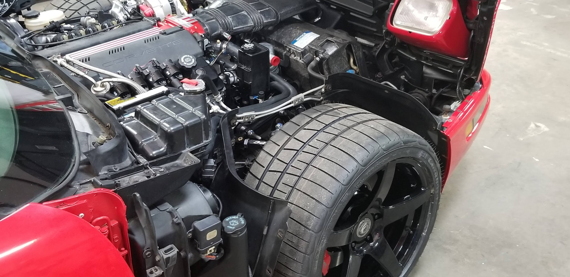

Front end grip?
Note the Holley ECU just above the master cylinder
