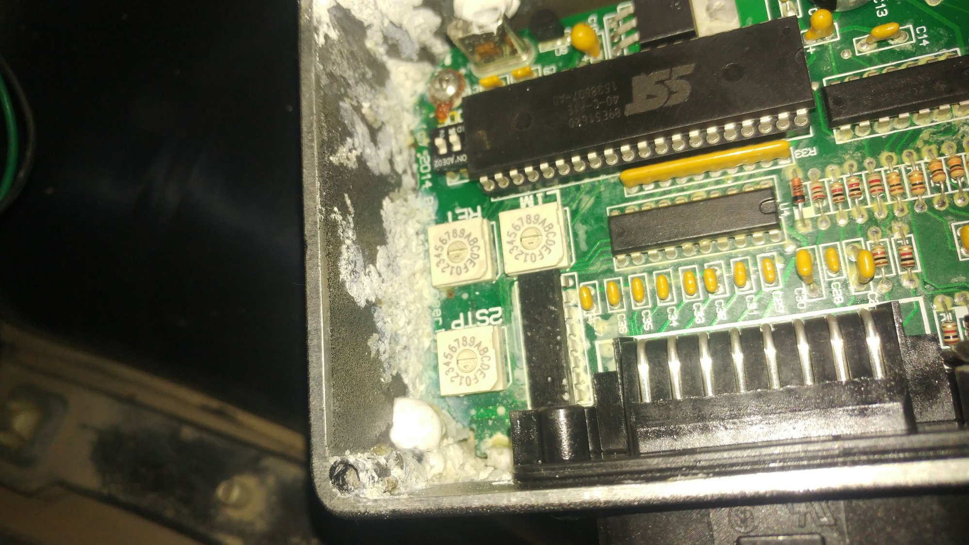

I did see some moisture in the LTCC brain box. Won't show up in pics, but here goes nothing.
So basically, it only has spark when it wants to lol.

Emailed him last night. Actually, now the lights are not doing the self test correctly. Instead of red and green coming on at 1 second, during key on, they stay both stay lit for ever. System only uses 3 grounds. All are clean and tight.

If that is corrosion I see it is likely the issue.

There's not much for troubleshooting. If the red led on is code one cylinder sequence error I would check how the opti is connected. I would also be sure opti is sending consistent signals. Did you reset the internal switches. The corrosion pointed out is curious
I don't know anything about the LTCC system but that looks pretty bad inside the box....

I'm not sure it's corrosion. When new, it comes with some white paste on the ends of the box. But who knows, could be corrosion as well.
