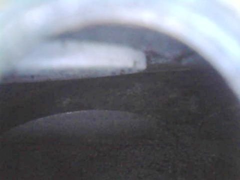

Okay! So I did some more digging and here's some new results. I removed all the spark plugs again, removed the pink wire from the distributor, pulled the fuel injector and fuel pump fuses (can't hurt to pull all 3), and got to doing my compression test. Here's a few things that I noticed and my results.
1. My engine didn't clank or make angry noises when cranking over without the plugs in. So that's positive I think. If there was something in the valley or in the cylinders that I just missed while putting it together, I feel like I'd have heard something.
2. Compression results were less happy than I'd have hoped they were. Cylinders 1, 2, 3, 5, 6, 7, and 8 seem to be a healthy 180-190 PSI. Good! But then... there's Cylinder 5... It's at 155.
Poor Cylinder 5...
Anyway... while I don't think this is what I was hearing, noise wise... that's a variance of 14-15%, which is too much, right? So... does this mean it's valve-job time?

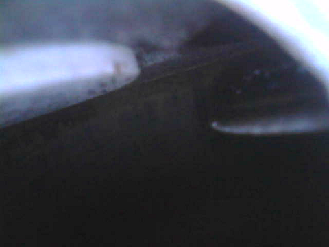

I had noticed that on cylinder 5 the first time around that I had noticed one of the valves looked open. This should be normal... cam rotation and wherever it stops and all... but when I went out to check just now again, the same valve appears to either be partially open, or maybe this is showing a dropped valve seat? Maybe it's nothing? What do you all think?
*EDIT* Yeah... something is up I'm pretty sure. Bumped the motor over and took another photo, you can see the other valve is open now, this one has remained the same. Bummer... head rebuild time?

All valves have to look like each other so you could start by taking the rocker off and see if you broke a spring
