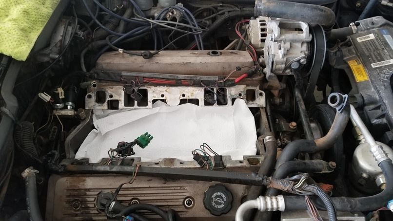

tl;dr - Did intake gaskets, now engine sounds like I've got something metal on metal clacking going on in the top of the motor.
Okay, so first off, it's probably worth mentioning that I was a mechanic for several years, so this is not the first intake I've ever replaced (though it is my first chevy shortblock). I'm also human, so I suppose there's always that chance to error... because something has clearly gone amiss.
So I had a bad oil leak from the back of the motor along the "China Wall", I believe it's called. Minus the smoke from under the hood at stop lights, I'd been enjoying driving the car for the past month with only a couple minor issues. 1, at idle the check engine light (lean) would come on, but go away when I got moving. 2. Under about 2/3rds throttle the engine seemed to surge a little, I suspected a fuel problem because it wasn't really a missfire, and 3. It was consistently a little hard to start, always started, but just took excessive cranking, again, another reason to suspect fuel in my head. So I picked up an intake gasket kit, some new Bosch 3 L98 specific fuel injectors from a guy recommended on this forum, a new factory fuel pressure regulator diaphragm/spring, and a new o2 sensor. Last week... I started the work.
Due to a wedding, my day job, etc etc, I had to do the work in bursts. Anyway... long story short, I tore it all apart and cleaned everything up. Put in the new gaskets, used the "Right Stuff", as recommended, for the front and rear lower intake seals, put everything back together using the FSM, torqued everything down. There were no "extra bolts", everything seemed fine. Minus painting the runners and upper intake, everything went back together factory.
*Note* I marked the distributor before and after removal, in relation to the rotation part and the base, but did NOT mark the base to the engine. This was an error on my part. I used pictures I took during the process, and my original marks to line it back up when I went back together. I'm fairly certain it is at the least very close to what it was when I removed it.
Anyway... to wrap it up, changed the oil, filled the car with coolant, swapped out the fuel filter (which was super clogged), and the 02 sensor, then started the car. First, the car started the easiest it's ever started, but immediately I began hearing a loud, quick thunking/clacking noise from the top of the motor. I quickly shut the car off. Wondering if I was just too jumpy, I tried starting the car 2 other times, and each time the very loud, quick thunking/clacking returns. I can record a short video if that will help? It's bad enough I'm afraid to let it run long... it sounds like (to me, but I could totally be wrong here) like either I have something in a cylinder bouncing around, or something it holding a valve open and the piston is hitting it (though... if I understand, the SBC is not an interference motor?).
Generally speaking, I think I was very careful about disassembly and reassembly. Other than the short time I was cleaning off gasket material from the lower intake, I had all intake ports plugged with paper towel (picture below of the only time I didn't, before it was fully cleaned off).
Any ideas or things I can check? I do have a bore-scope... but I just don't want to tear the motor down if I'm just being paranoid, but I don't want to damage the engine enough that I have to have new valves and the head redone.

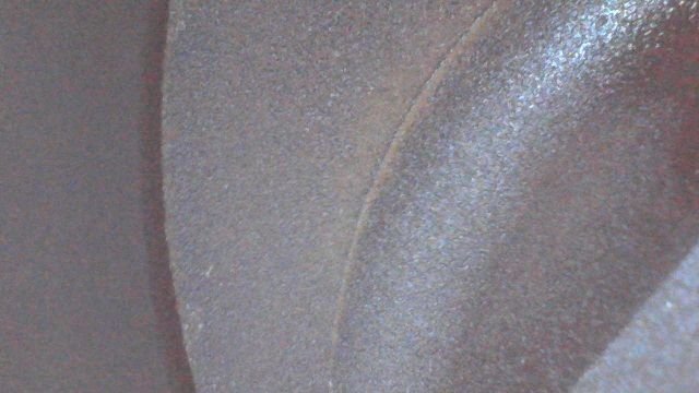

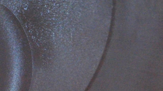

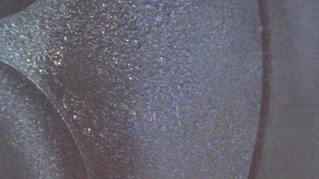

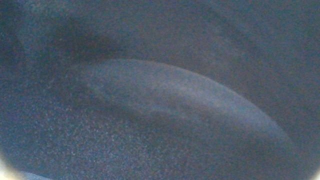

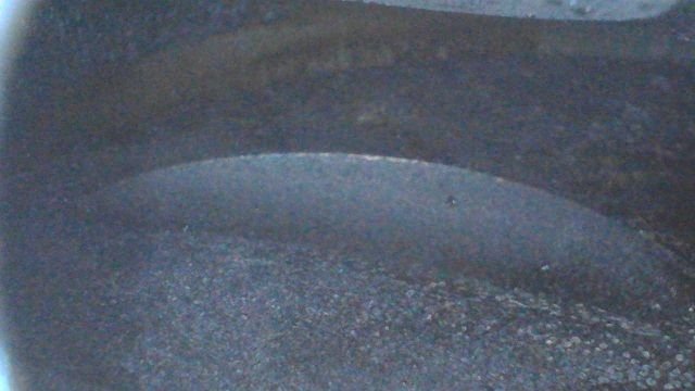

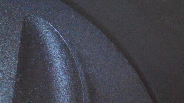

Okay... so while my borescope is a bit limited in it's articulation, I just completed pulling all the spark plugs one by one and I have no signs of damage to any of them. I also can't see any damage on the cylinder heads (other than I could probably use some cleaner ran through there a couple times to clean up the soot!). Here's pictures from each one in case you all see something I don't. I didn't photograph the spark plugs, but they all looked the same... light brown, normal gap, no scaring, no chips, no dents. So I guess my next move is either go back through them and compression test, or do we think it's time for me to fire it up and record a video for you all to see and hear it?
- Oh, and I double checked my firing order wiring and that was correct... I need a timing light and I can check my timing... but will one of these engines kick and rattle like crazy if it's just a little off? I don't know how far off it is, but compared to my pre-removal photos, it looks fairly close, but I have no concept of if like, a millimeter turn changes the timing a whole bunch or not.
Cylinder 1a
Cylinder 1b
Cylinder 2
Cylinder 3
Cylinder 4
Cylinder 5
Cylinder 6a
Cylinder 6b
Cylinder 7
Cylinder 8
Last edited by Lunchcopter; Apr 5, 2018 at 11:08 PM. Reason: Added info about timing.
