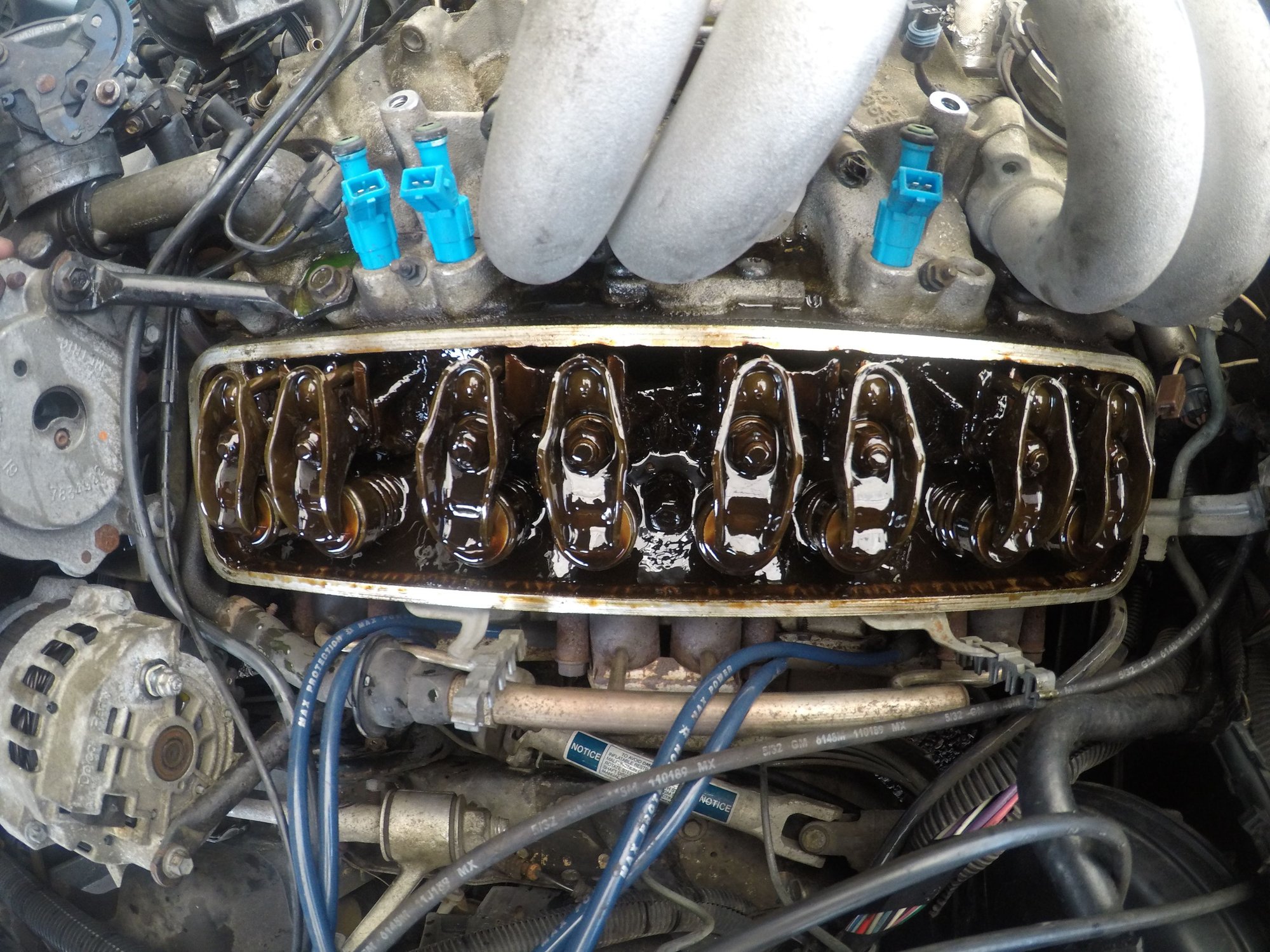

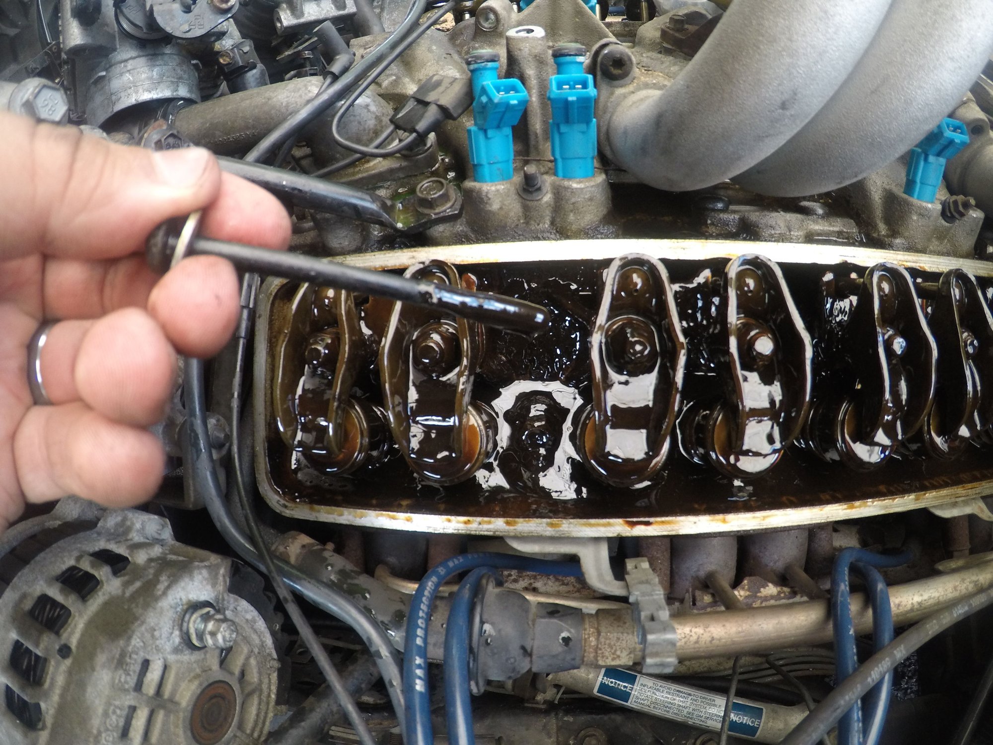

So I think I found the cause of my noise and oil pressure issue. Now the bigger question is why? What on earth would cause oil to go from a dark amber to this in under 500 miles? I used Mobil 1 full synthetic 5W-30 on my last change.
The next question is how do you clean this out once I figure out the cause?

How's your coolant level?

Slow leak with nothing on the ground. Did a compression test on the heads and a leak down of the coolant system about a month ago, the cranking pressure was from 185 to 195psi and the coolant leaked out at about 1psi per hr with nothing dripping. I figured that could have been from the seal on the test device as we had to use the adapter cone.
I pulled the intake to look and I'm not sure I see a leak here or not.
I am getting the feeling I still need to pull the heads
* Did forget to mention the 4 inboard bolts for teh 4 coolant ports where hand tight. Not backed out just had very little tension on them to break free.

Hard to say. But this:
Originally Posted by Space387
Slow leak with nothing on the ground. the coolant leaked out at about 1psi per hr with nothing dripping.
* Did forget to mention the 4 inboard bolts for the 4 coolant ports where hand tight. Not backed out just had very little tension on them to break free.
...Plus the way that oil looks....is some evidence. That's a tough one. If the intake was still on, you could pressure test the cooling system again and use a mechanic's stethoscope to listen for air leaks around the valley and in the oil returns in the heads.

With me being so far in, I am probably just going to bite the bullet and do head gaskets too. I'm going to check the heads for warpage and if its within the .004" I think is the acceptable, its just getting gaskets for now. Its getting a rebuild with more gofast parts in the nearish future ( next year or two) but I cant afford that right now and I do want to learn this car a bit better before I make large changes. So time for gaskets, any recommendations?

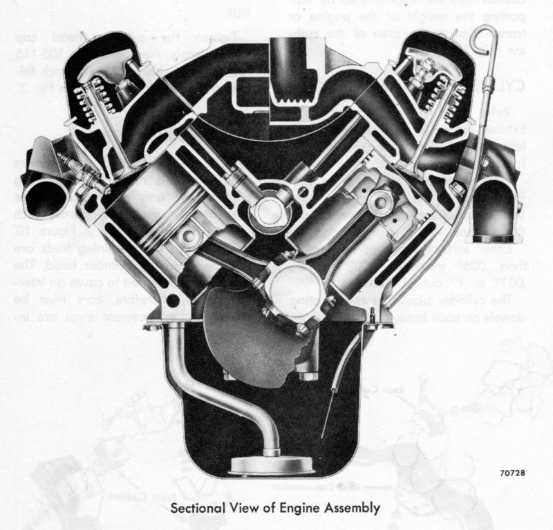

1. I mean, the whole oiling system appears to be darn similar between the two; the AMC has oil galleys for the lifters just like the SBC and the ID of that galley seems to be about the same.
2. your 327....Cool story, and killer save on the lake! I dig it! What kind of ski boat had a 327 in it? I can't see how your oil pressure wasn't super low; the "waist" of the lifter allows oil to flow around it to move on to the next lifter...even though yours was all the way at the front, it's still a big leak in the system. Not that I think it couldn't run on very low pressure just fine; we know that oil pressure isn't what protects the bearings, it's hydrodynamic lube, so just having any oil there would likely be good enough. Finally, we've seen how long a SBC (Gen III) can apparently go w/NO OIL.
3. Good question about the oil pressure sending unit location. It pretty much has to be between the oil filter and the "engine". On the AMC, it's just inside the front of the block; right after the filter, before the lifter galleys.
I found this interesting page that has "V8 CUTAWAYS". First is a SBC, second is an AMC. You can see the oil galleys in both. Also, scroll to the bottom and check out Pontiac's early reverse flow cooling!
