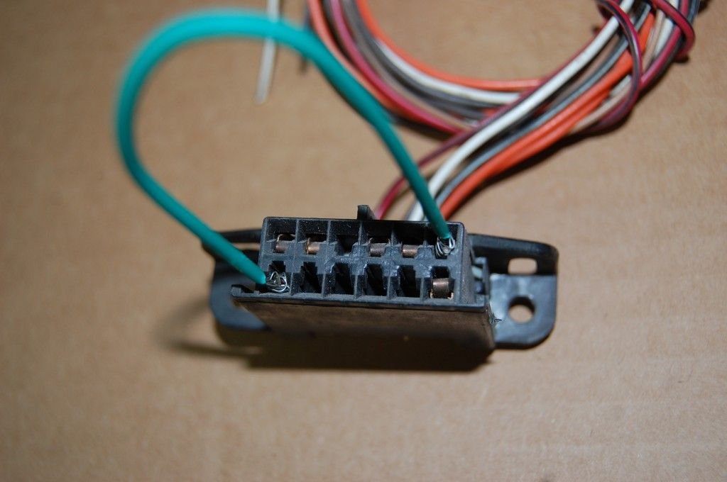

On my plug I only have three wires.Now I wonder what system I actually have?

Old May 21, 2018 | 10:52 PM
aklim's Avatar
aklim
Joined: Jul 2004
Posts: 28,474
Likes: 3,291
From: Hartford WI
I do have the DataMaster-8D program on my laptop but have no idea how to read the data after scanning.I could run that again if I could sent the data to someone who can read it.
Odd configuration Looks more like an ECM other than corvette Maybe F-body?

Manifold air temp (MAT), also known as intake air temp(IAT), is a primary input sensor in MAP-style engines like yours. Without getting too in-depth, it is responsible for helping the computer determine how much air is actually coming in to the engine - the Manifold air pressure sensor can tell the computer how much pressure the air is at, and with the input from the IAT, it can know the temperature of the incoming air. Using the combined gas law, Pressure * Volume = k (a fixed amount of air, for example, the volume of your intake) * Temperature. So the computer knows the volume of air incoming based on the MAP and IAT sensors. I had mentioned above that I would suspect that the IAT/MAT is bad on your car, as without it, the computer can only guess about the amount of fuel to mix with the air.
Pressing on the brakes killing it would also make me wonder about a vacuum leak in the booster. Do you have vacuum boosted brakes? Any chance they are bad? You can try disconnecting the brake booster line, plugging it, and seeing if the car will die.
Edit: to make my answer to your question more clearly, yes, I do believe that a bad MAT could cause stalling/shutoff. But if the actual use of the brakes is what kills it, it may be a vacuum leak. But should it die regardless of if the brakes are pressed, then the MAT may be at fault.
