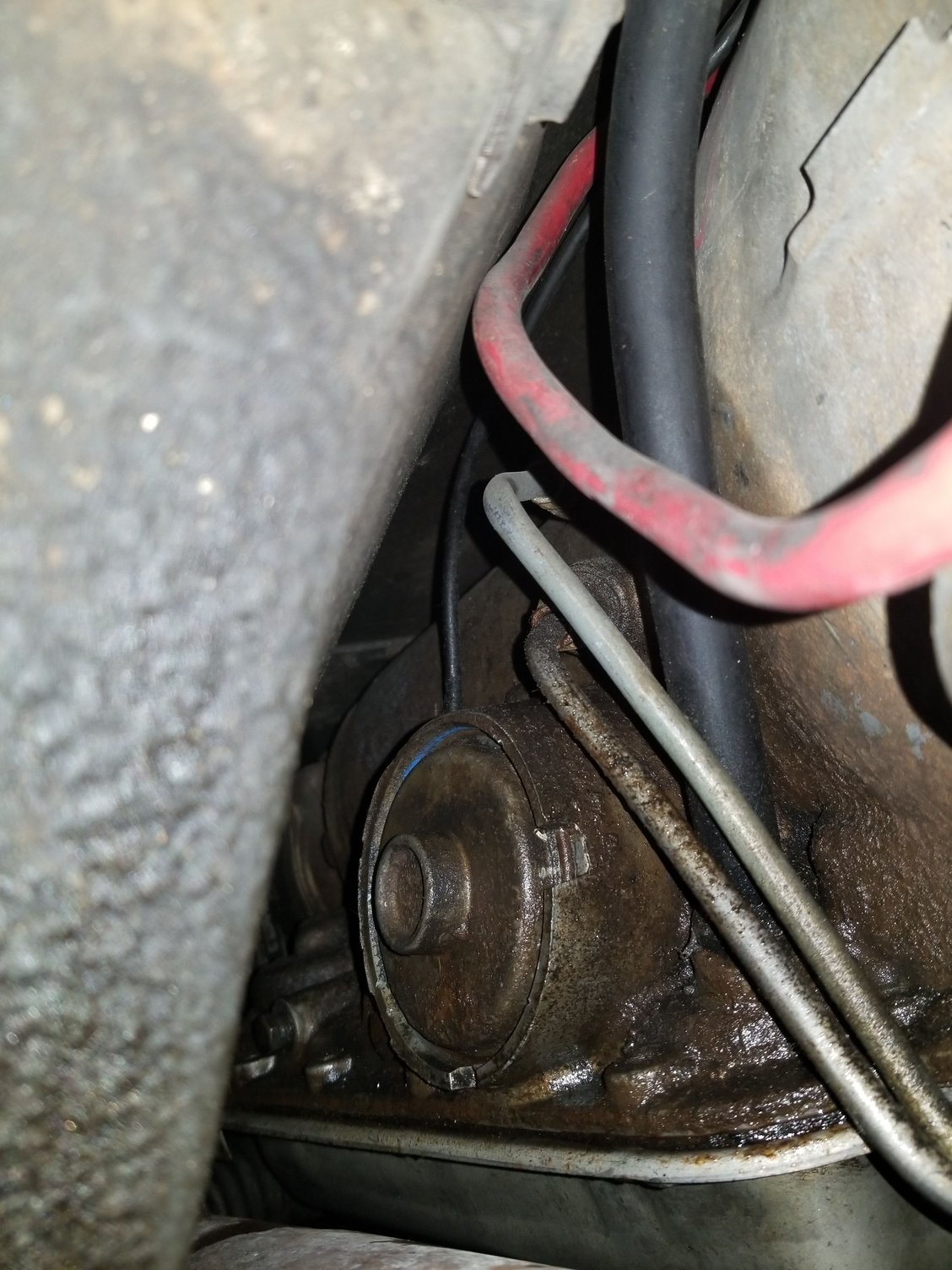

So when I was going to tighten the bolts on the transmission pan (was surprised how many I was able to snug down) I noticed that a metal line was coated in transmission fluid that may be another culprit. All help is greatly appreciated. I'm also doing as much as possible DIY so any tips are also welcome.

Yes it can be a loose cooler line, overflowing out the top vent hole or TV fitment....
You really need to pressure clean the area at a car wash, you can get a pressure cleaner nozzle down from the engine bay and have a good go at it. Only then after a short drive can you pinpoint it , even engine oil and any trans fluid will spray up from air turbulence when driving.
It does look like the TV cable area where the leak is coming from, make sure you clean the trans before tackling the TV cable.
If its that..
Is a small bolt and the TV cable can be removed, then unhook the cable from the small rod.
There is a round rubber seal, it can easily fall into the transmission so be careful.
I ended up removing the pan to retrieve my seal and make hooking up the TV cable easier, it helps to have someone put tension on the TV cable when you have hooked it on to the rod CAREFULLY Refitting the TV cable into and onto trans taking care not to force the seal out... its a bitch of a job when in the car
Good Luck

After cleaning it and driving the car around, I see fluid from the tv cable and the dip stick tube. unfortunately I don't have the tools to get to these ports so I'll be contacting a local transmission shop near me to get a quote. Thank you for all the advise and solutions to my issue

Yeah you have to remove the front exhaust to get to the 10mm bolt that holds the TV valve to transmission, its not a hard job but if you don't have a decent trolley jack stands and tools best get it done.
That small TV cable to trans seal is a bitch, can easily fall in if you are not careful inserting the TV cable body end into trans.
Plus you need an extra pair of hands to pull on the cable gently, as you place it into position after hooking it onto the trans rod.
I've done it while in the car........ cursed plenty I tell you as that rod can pop out the end of the TV cable. When its in place it cannot pop off, just takes a lot of care and patience.
The dipstick has a bolt on the back of the head from memory, once that is out the dipstick will come out. The seal should stay in the transmission and need to be pulled out with a finger, then replaced and dipstick refitted.
