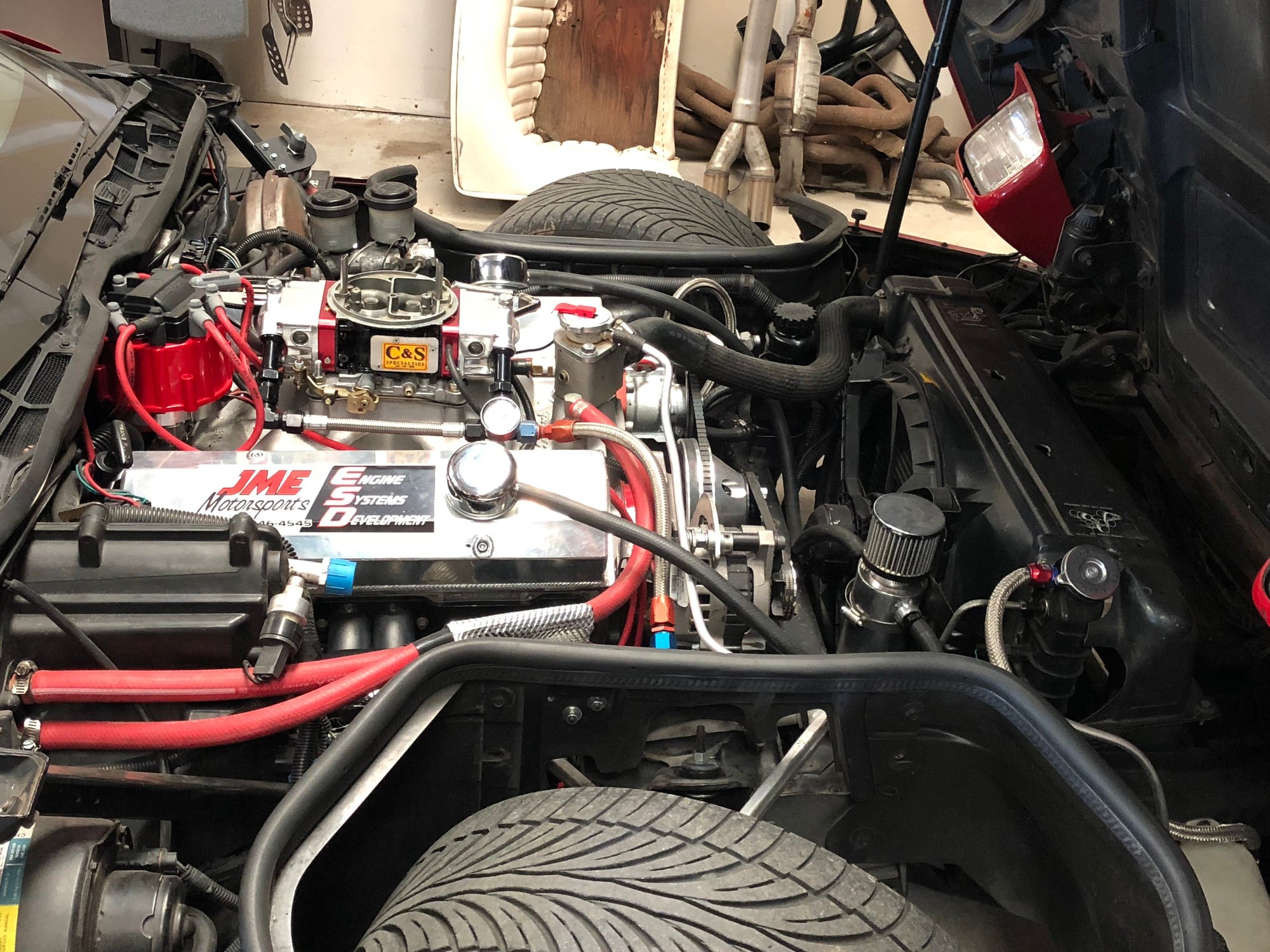

Im almost finished with my high HP set up . Went with 4 barrel carb set up . Should be somewhere around 600 Hp.transmission was rebuilt with some stronger parts to hold the power. A4 rearmed is still stock. And I’m worried that will blow soon.
to the guys on here who put big numbers on their c4s . Did it hook well? Did you blow up your rearend . How was that stock gear ? i have the “performance” rear end when I look up the rpo code.

BTW, your right front tire is mounted backwards

Clean looking setup! That Dana 36 won't last very long. If you're using sticky tires you would want to launch at a safe rpm that will keep the dana 36 from grenading it self. At least until you get a dana 44 installed.
I'm thinking of doing a big block swap. What's keeping me from pulling the trigger is finding headers, and oil pan that will fit. Could you share some info of what you had to modify to make it fit.

….. Check my avatar for how well the stock C4 suspension hooks … Dana 44 with 4.33 gears and Mickey Thompson Drag Radials … lets see some internal engine specs … cam , compression , heads , etc . …..
….. Looking at your pic , you will want to put some kind of a shut off valve on the heater hoses or you'll have full time heat inside the car ! …..
