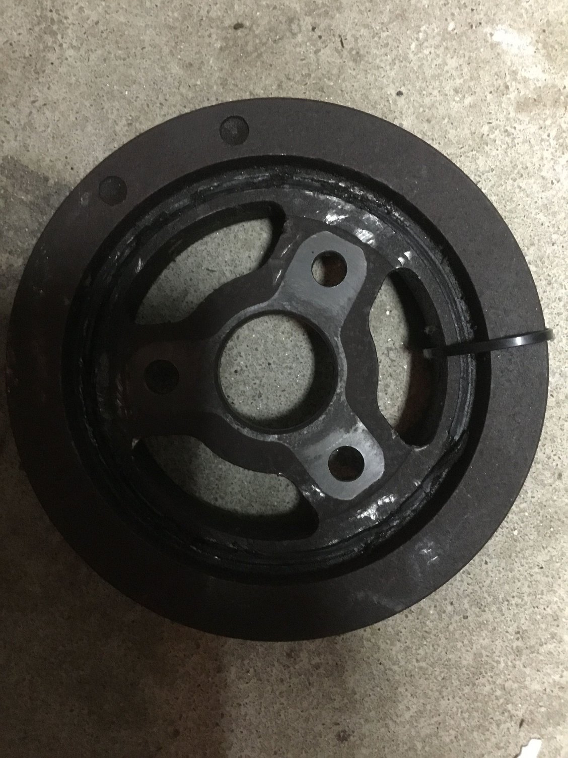

Should this be put back on? It took a beating getting it off. If I put on a new one should it be oriented the same as this one? Thank you

If there is any doubt in your mind I think you have answered your own question.

….. Gorilla tape it and hammer it back on … …..

I probably should have mentioned that it's solid. The zip tie is just to mark location. It's scuffed up from the pounding but there's no separation.

After too many slipped rings messing with my timing, I replace mine with a Fluidampr. It's not a question of if it will separate, but when.
