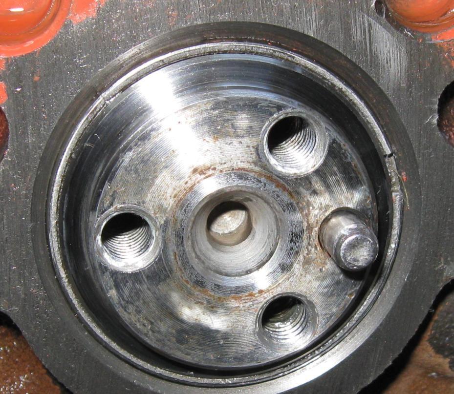

Does this front cam/cam bearing look strange or broken to you?
We put in a Cloyes double true roller.
Chain was rubbing the block at the middle oil gallery plug/casting area.
Motor ran perfect,no noises before this chain install.
Removed the chain and put in a brand new bone stock chain set.
The noise is still there.
Thanks for looking.

Looks OK to me, what noise?

Looks like a sloppy cam bearing or cam install. It is ugly but fine. Put it together and pull one injector off at a time to see if it is one cylinder related. A valve only hits a piston once and would think if stock it is about impossible for valves and pistons to hit.

So you did a valve adjustment at the same time you replaced the timing chain? You probably didnt need to do that. Lets assume you timed the chain correctly but if you didnt, you could have had a piston hit a valve. If you adjusted a valve to tight it could hit as well

The picture on the first post does not show the camshaft retaining plate, I assume you are using the plate and have just removed it for the picture?
