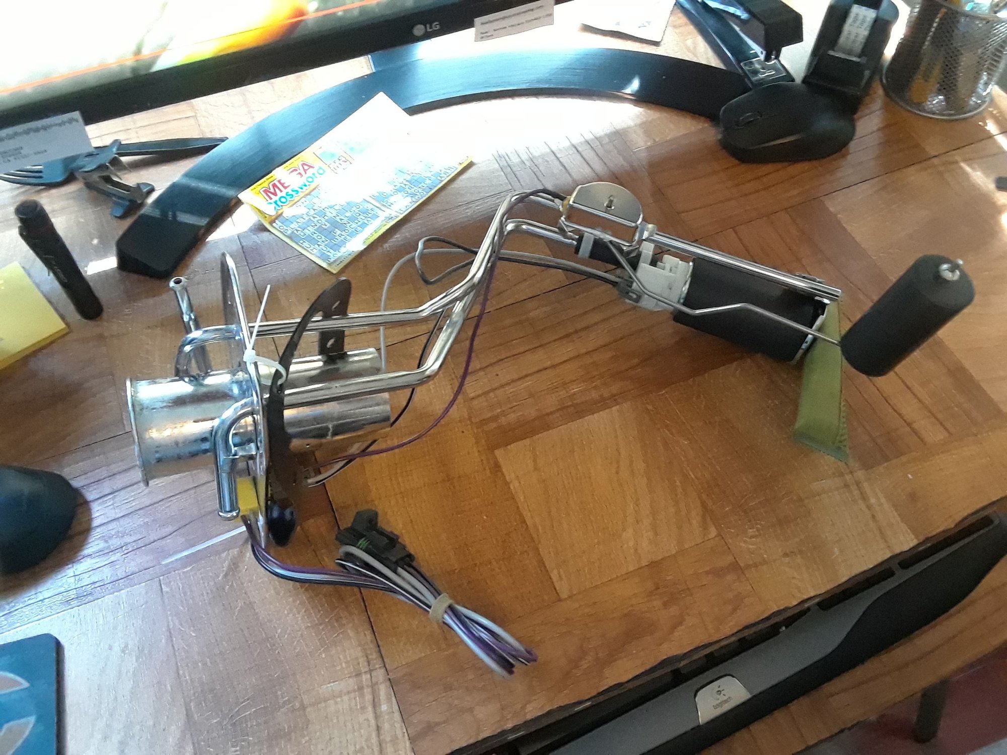

Got to do filter along with pump, in case a clogged filter ruined it. Cheap insurance. I have seen the old sock go into the filter in a pic somewhere so if your sock was original and missing, it is probably in there. Here is mine, I bought new parts and pieced them,
