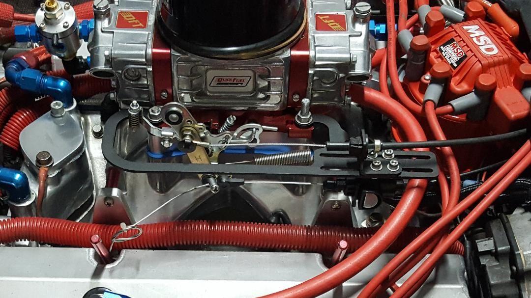

I used the TCI bracket kit, the actual bracket itself is quite good - it bolts on each end of the carb studs and it is very sturdy.
it hangs the TV cable under and the throttle cable over - means that the cables line up correctly with the throttle tabs.
I dont know if you can buy them on their own - they usually only come in the kit, maybe a similar item is made by another manufacturer ?

That looks neat.
