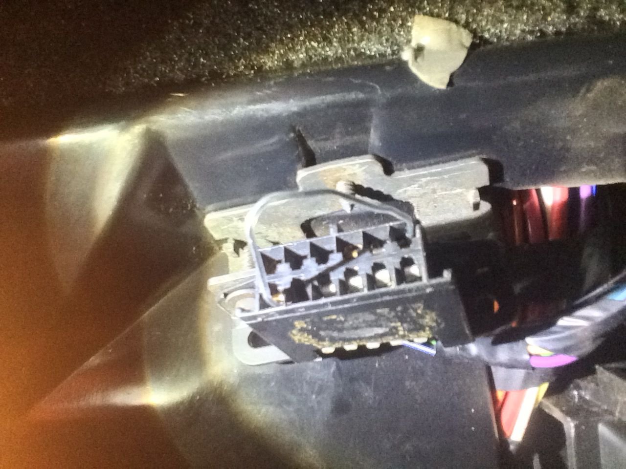

Here's a video of how to pull codes I also added a pic of how to jumper the ALDL connector. It's a little better than what the video shows.

DTC read
Thank you I pulled several codes How do I decipher them. Codes H31,H33,H35,H37 and H74.

Since the codes begin with H they aren't active
H=History
C= Current
Only one, the 33, is engine related it's a MAP sensor fault, but again not current.
