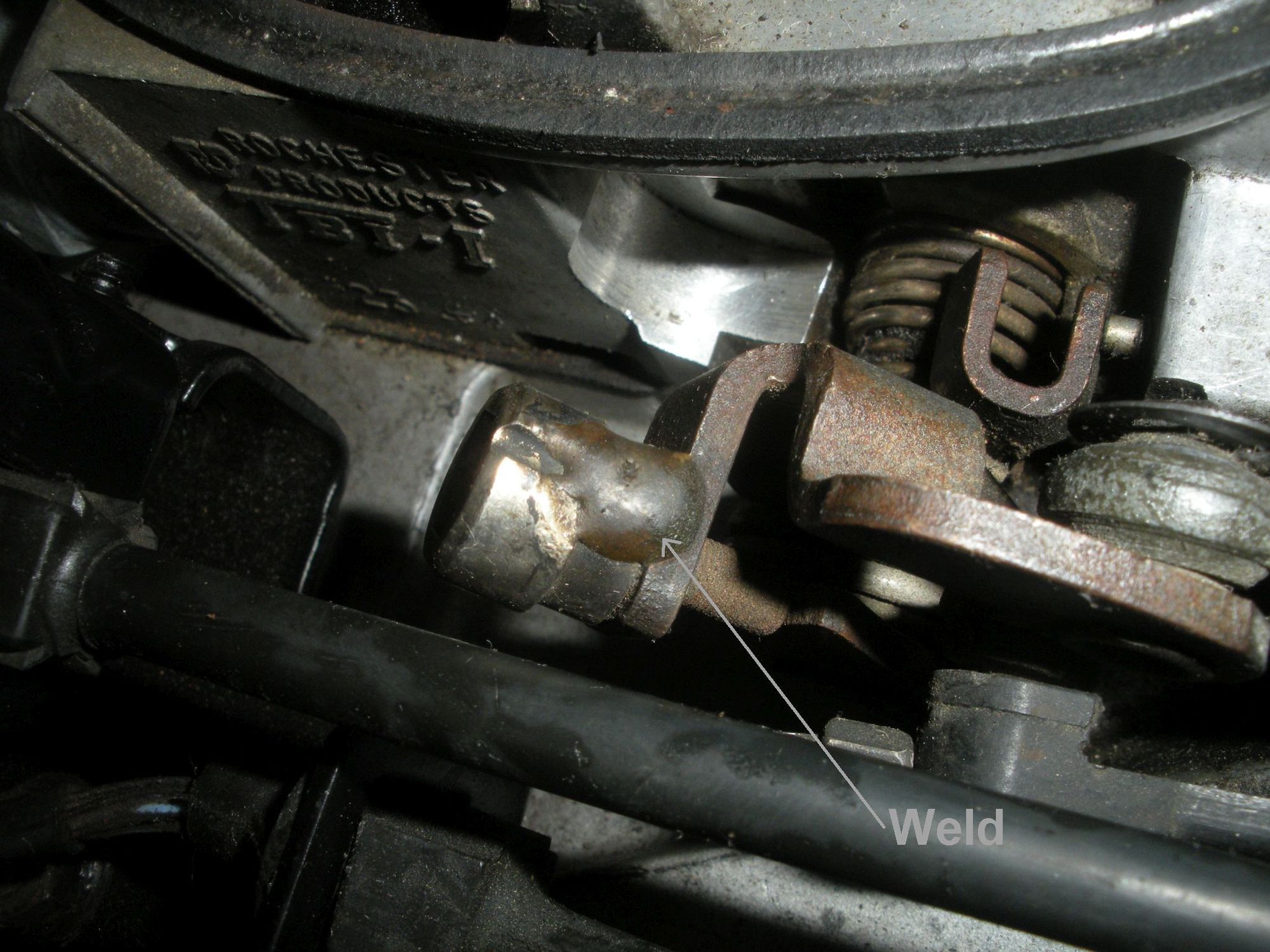

Originally Posted by lieber680
If I wanted to do which most feel would be a mistake, and convert it to carburetion,
Why would you want to do that? Are you having trouble with your TPI?
I've got 240,000 miles on my '84, and my despised CFI still has its adjustments welded into position from the factory! I'd say GM was pretty confident about their design to WELD the thing, so as to discourage tampering! I'll bet you won't be able to do that with your four-barrel! My car starts good, runs good, and gets good mileage. What more could you ask for? (I'll admit that I have 'tampered' with the engine internals.)
