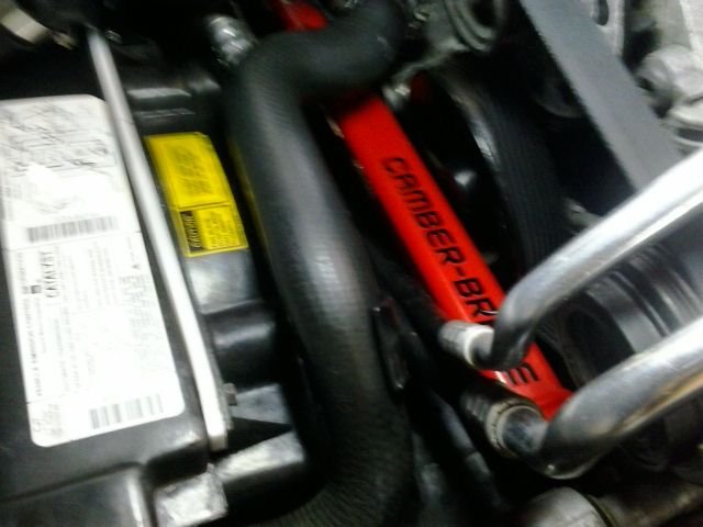

Has anybody bought and installed one of these? It connects the front upper control arm bulkheads together. Claims improved handling. Just wondering if anybody has done one and if you can tell any difference.

I was hoping someone had a pic. It looks like probably won't go on because of my supercharger. Where did you get the other brace for inside the car? I used to see one that went across behind the seats and tie points were at I think the storage mounts for the targa top but haven't been able to locate one now.

Looks like it goes right across the charger. dang.

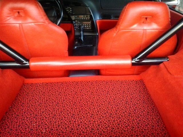

Exotic Muscle. However I had to have one of the holes welded up and redrilled and I had to fit it in. It bolts to the targa top holder bolts and to the upper seat belt bolts. Some folks have enough of the stud left to put the targa holders back, I did not.

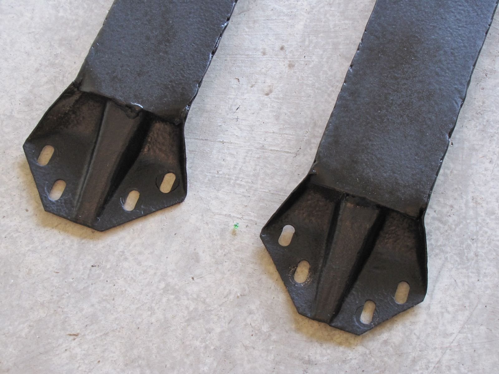

When you say boxing the x-brace, are you referring to the stock convertible x-brace, or an aftermarket one? Sounds like mod I may want to make to my vert. Any pics?

The Harness bar doesn't look bad installed. My wife made the padding. We found torch red vinyl at JoAnn Fabrics that matches exactly. I bought some scrap carpet out of another Vette and used it to cover the spots where the targa top brackets were.
That's cool looking!

Originally Posted by SLVRSHRK
When you say boxing the x-brace, are you referring to the stock convertible x-brace, or an aftermarket one? Sounds like mod I may want to make to my vert. Any pics?.
Here are some pics of mine:
