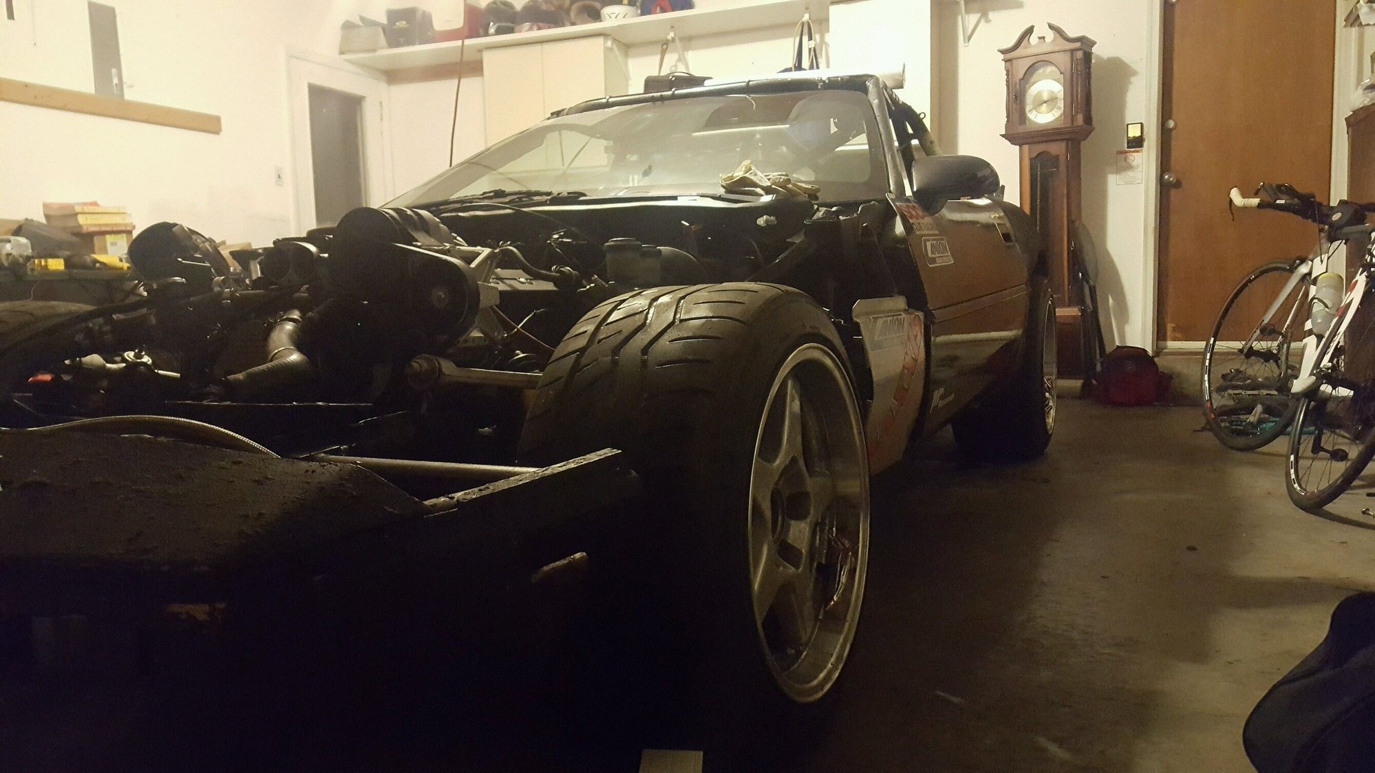

Took out the D36 (Out of a ’84 Z51). Put in a D44 (with NYR spring) from a ’96. Used the ’84 trailing arms+ mounts. Front has drop wedges and one of the pads removed on the outer edges of the spring. . .
Installed drop bolts. Installed new poly bushings everywhere. On the very bottom of the drop bolts and this thing sits HIGHER than my D36 that was on stock bolts. Did I do something wrong?

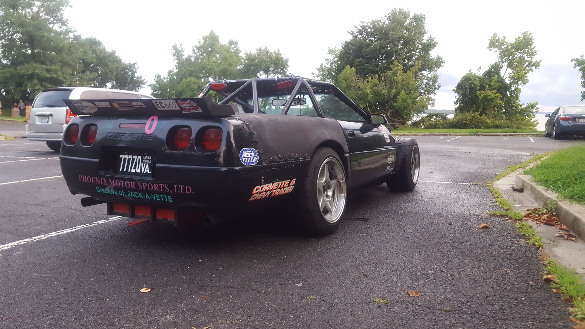

Belay my last. Drove her around and she sits nicely
