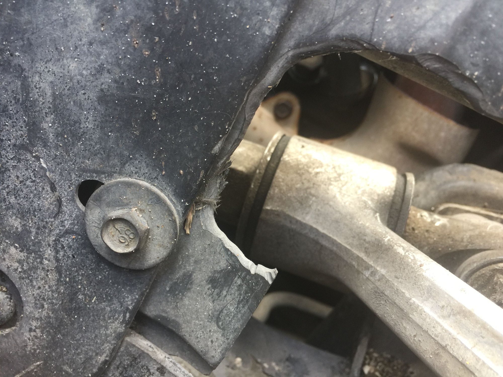

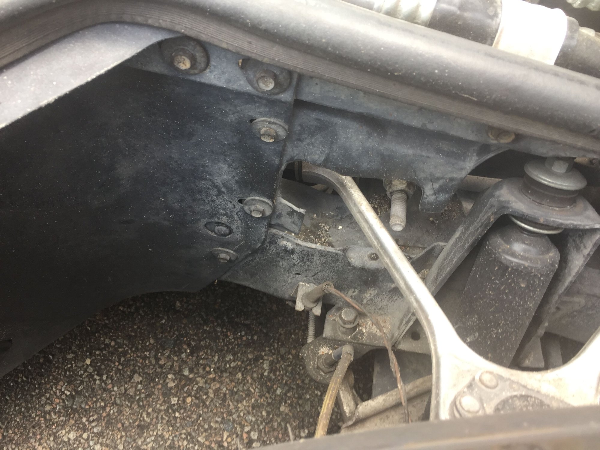

You can simply cut a notch in the plastic wheelwell directly lateral to the #8 and use a long extension on your socket driver through the wheelwell. That's what I did and I never looked back. I'll post a picture when I get home.
Small notch on fender well allows easy access to #8 plug with a straigt extension. See plug in pic
Robert

Great Pic thx alot

Removing the driver side wheel liner insert helped me feed and position the wires much more confidently and easily in the looms/ holders. Might prevent having to cut anything away on the passenger side also for #8? I managed #8 with a 3/8 ratchet +swivel on a standard plug socket. Diff brands are slightly different lengths tho. Just gotta get yourself situated 1st haha. Def a tedious endeavor doing plugs & wires on these opti- LT's. Take your time & do it right, so you can KNOW that the next misfire codes will HAVE to be something else 👍 Lol
