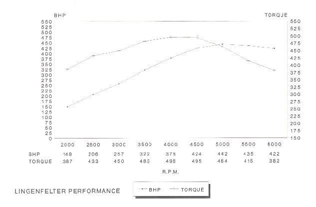

Here is my dyno from LPE. You can see most of the specs in my sig. Another vote here for the SR.
