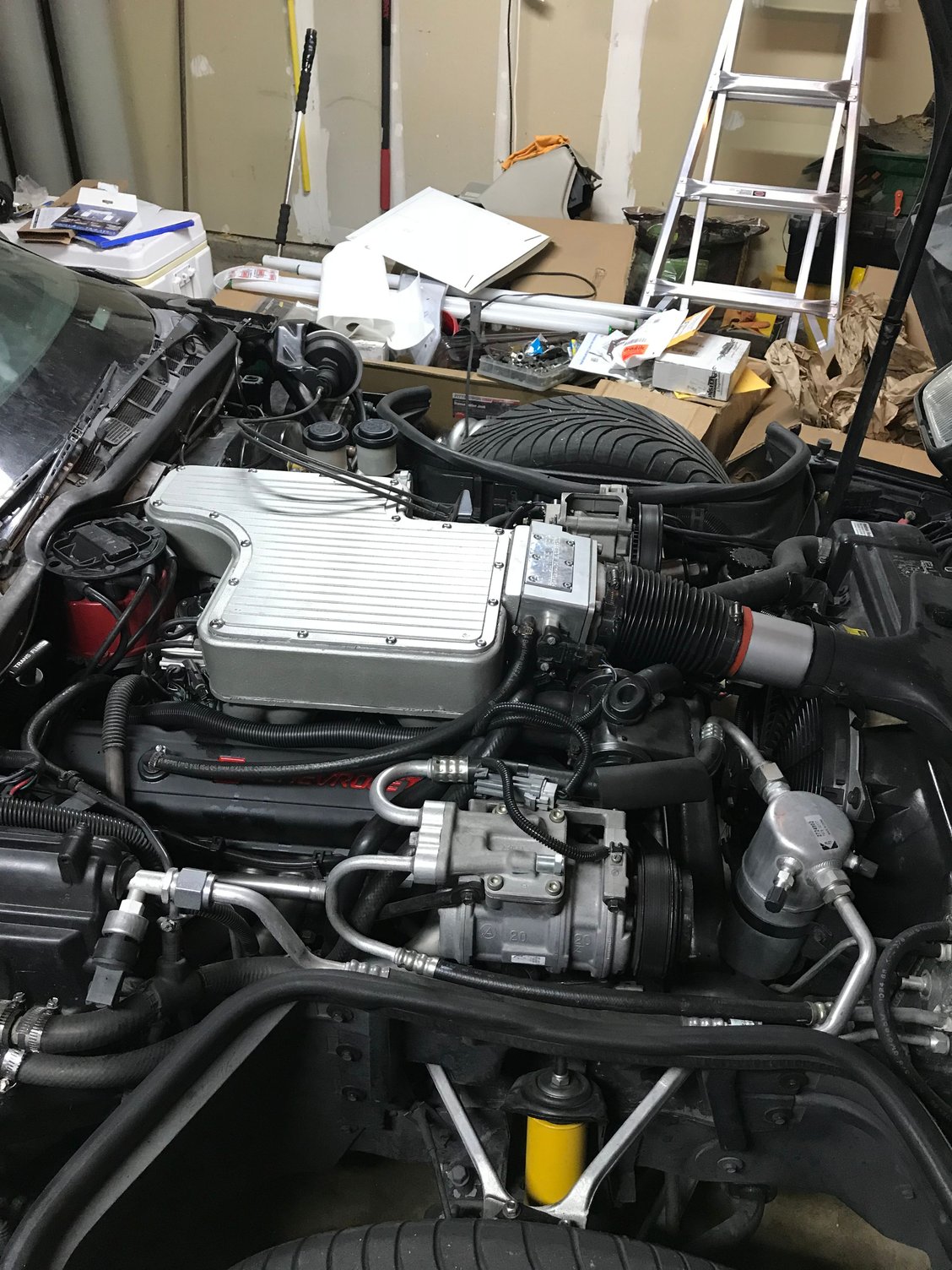

Thought I’d put a pic up of this thing.
Nice Job!!

Looks great!!!

Forget the Super Ram, I'm jealous of how clean the rest of your engine bay is!
