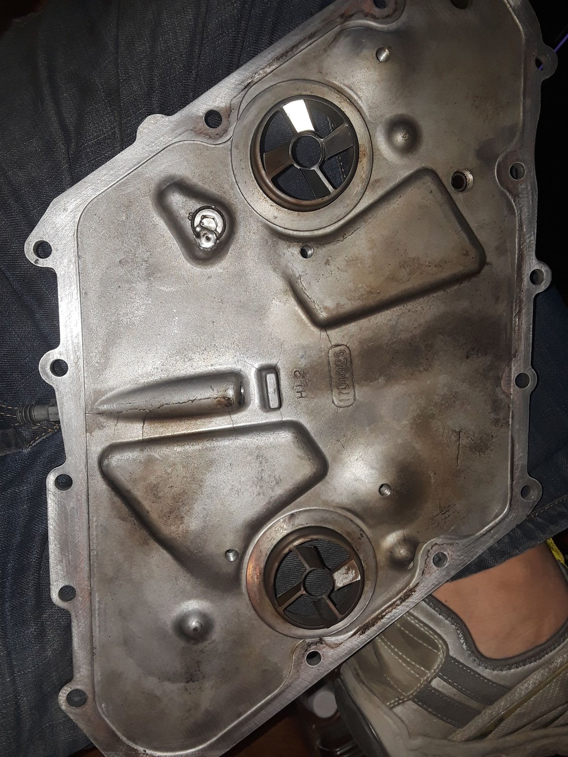

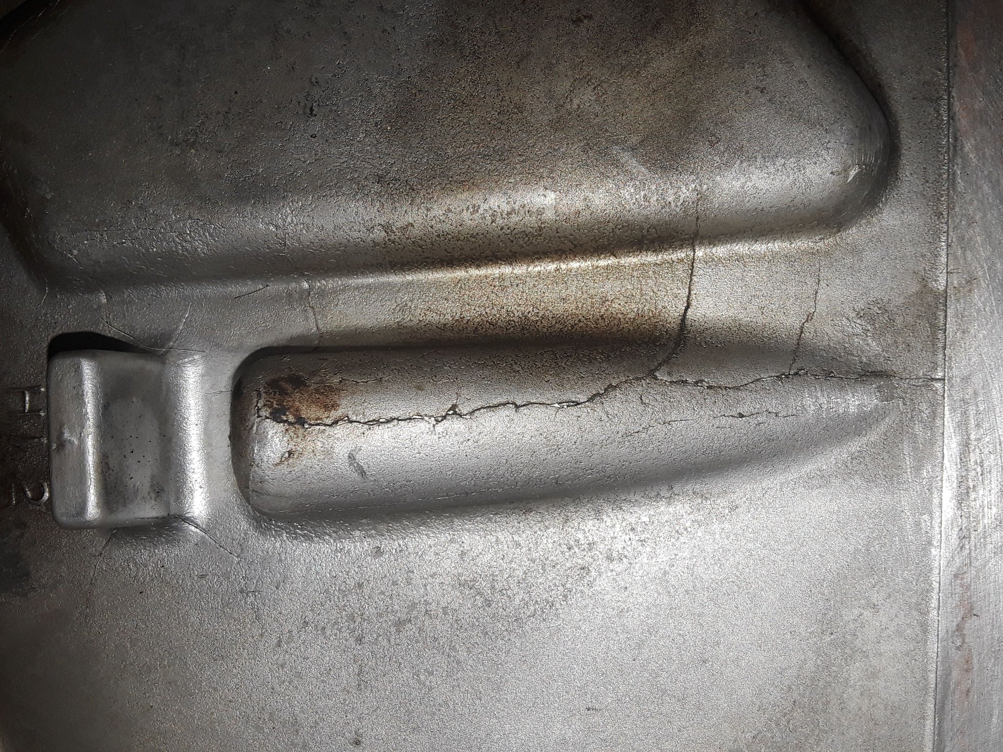

Well, was looking into restoring and driving this beauty since its my first corvette. Lot of TLC is needed though but for now those pictures I posted where part of the intake manifold. Are those cracks? Should I be worried about short term? How would I go about repairing the damage if possible, or should I purchase a new intake cover?

A popular way to make complex aluminum castings is with the "permanent mold" process. The marks you are seeing are caused by cracks in the molds, but do not result in cracks in the casting! The marks you are seeing are probably cosmetic only, and do not affect the performance of the part. If they are cracks, you would be able to see flaws in the casting on the opposite side of the part, and if you spray a low viscosity fluid (like Liquid Wrench) on one side of the part, you would see some of the fluid on the other side of the part.
