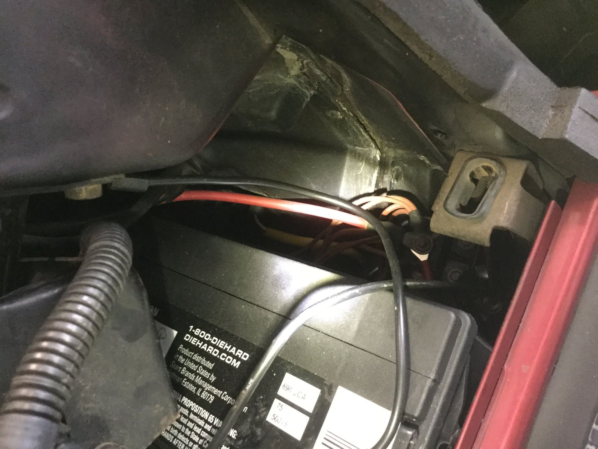

I have a CTEK battery charger/conditioner that I want to use to maintain the battery in the C4. I use it for the C3 where it was easy to wire the accessory socket to the battery terminals to make connecting the charger a breeze. Not so easy with the side post connection system in a C4, has anyone come up with a cunning method of connecting a trickle charger to their C4?

Why get all bent out of shape about needing to connect to the battery? Electricity doesn't know the difference. There is a junction block right behind the battery (in a 90 at least) which is perfect to connect your tender to.

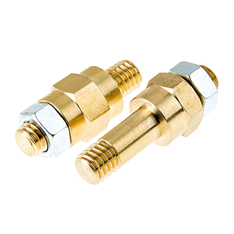

You can also use one of these of you want to connect directly to the battery, but as stated above it's not really necessary. I use them to connect my amp too.

Sounds like Boss Hogs idea is the winner and then use the vent like Ihatebarkings dogs.
I used these same bolt/fasters (purchased at NAPA) with pigtail from Battery Tender JR Plus. Left pigtail connected to battery and placed pigtail thru side "gills". When not charging pigtail is folded in "gills" for easy access. I used for many years this way without any problems.

I used the extended battery bolts as well. Long pigtail routed with another harness in the engine compartment, with the connector tie-wrapped at the left side of the front air dam.
