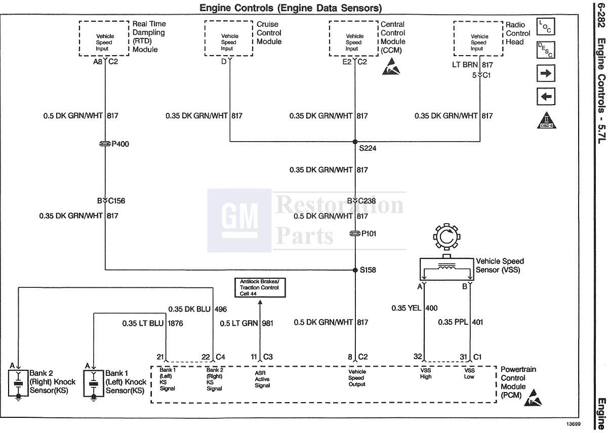

Originally Posted by ihatebarkingdogs
You can use a signal conditioner. The trans sensor is fed to the ECM, the ECM then sends speed info on the grn/wht wire to several devices including CCM (speedometer and odometer), radio, HVAC. Read the install instructions, particularly with regards to affecting TCC slip calculations. There may also be issues with TCS, ABS, and active suspension as well. I don't know. WVZR is probably correct that a reprogram within the ECM is the best way, but not many people have access to the equipment, or know people that can do it.
EDIT: If you intercept the raw signal right out of the transmission, condition it, then send it on to the ECM, all systems affected by speed will be "recalibrated". So the $85 conditioner will work. Check with DakotaDigital that the SGI-5E can indeed be used to condition the raw VSS signal, but I think it can.
To add on extra details, in a 1996 the signal from the VSS (vehicle speed sensor in the tailshaft of the transmission) goes to the CCM, radio head unit (for variable volume based on road speed), the cruise control module, and the Real Time Damping module (for the variable shocks, if equipped):
I agree it would be better to recondition the signal before the PCM than after it. The PCM does use the speed info for various things, but the area where the speed accuracy is most important probably is in the control of the torque converter lockup.
The best way is indeed to update the PCM calibrations (aka get it "tuned") to re-calibrate the speedo. The bad news in a 1996 model is that in order to do this you have to buy a $400 software suite called Jet DST. Once you have that, it's simple to change the speedo calibration. It's just not cheap software.
