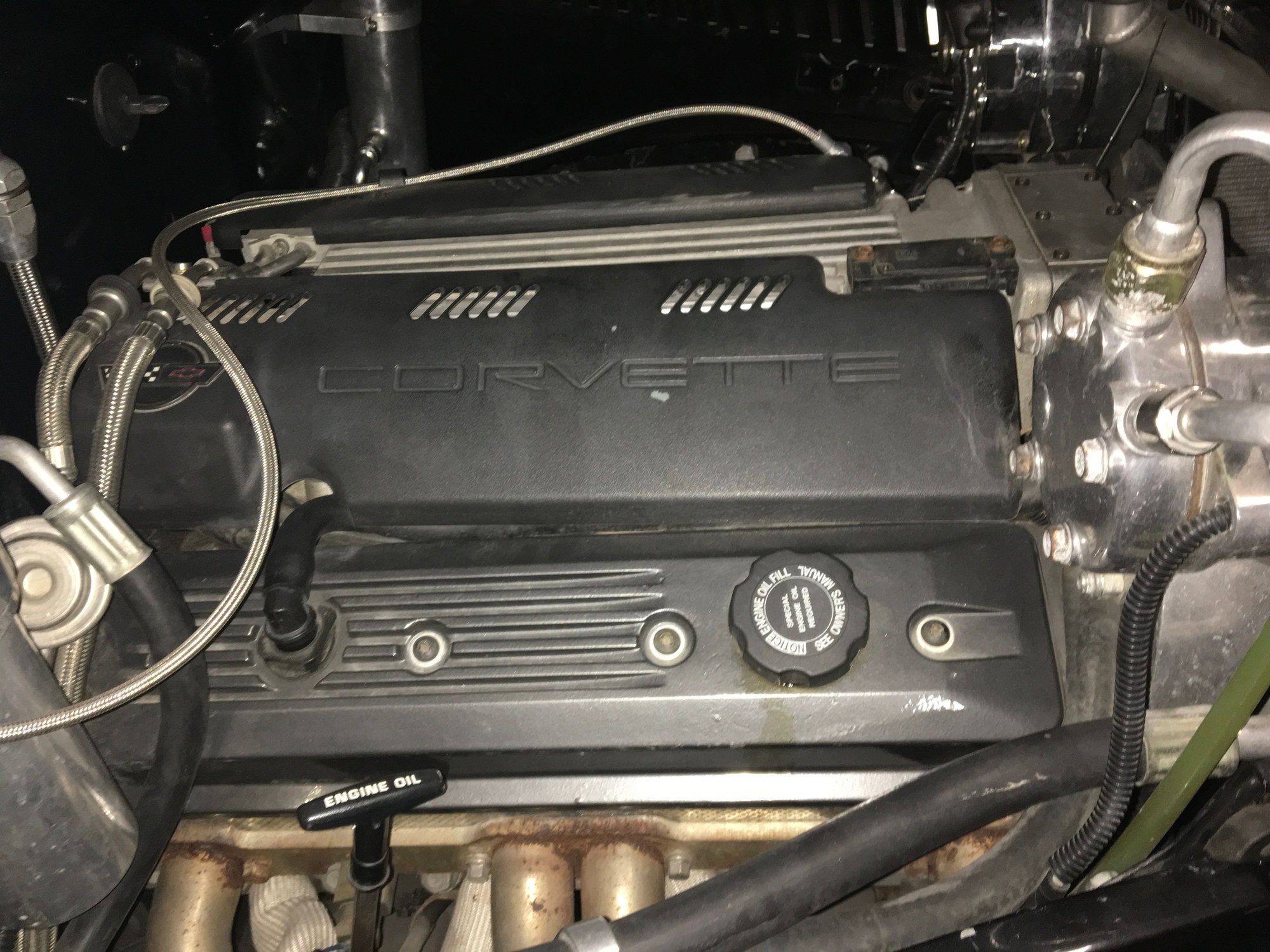

can you gentlemen help me have a fast idle speed

Sounds like a vacuum leak or maybe bad IAC. Your picture looks odd I see the LT1 is not in a Corvette?

Is this installed in a 32 Ford?
