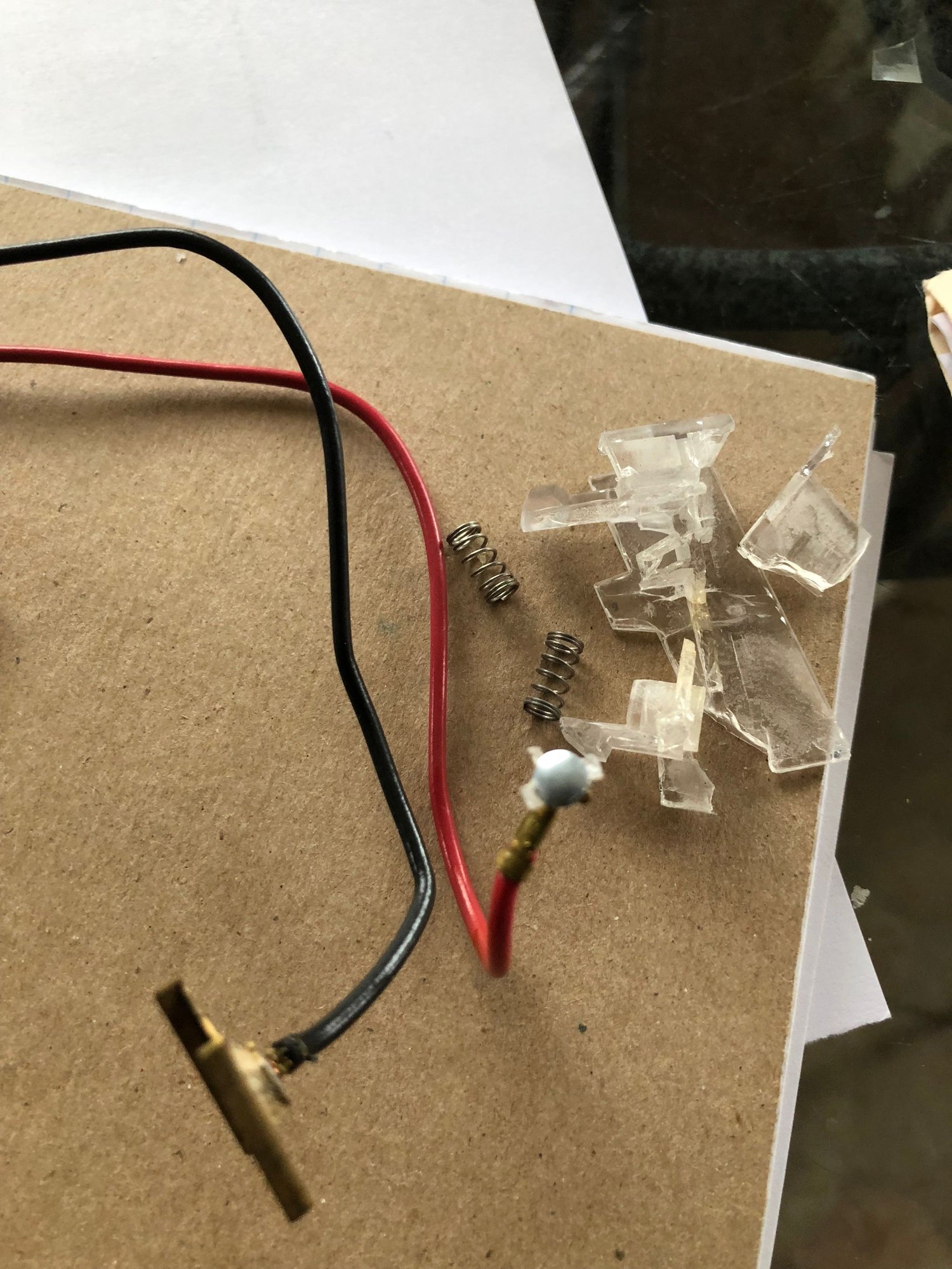

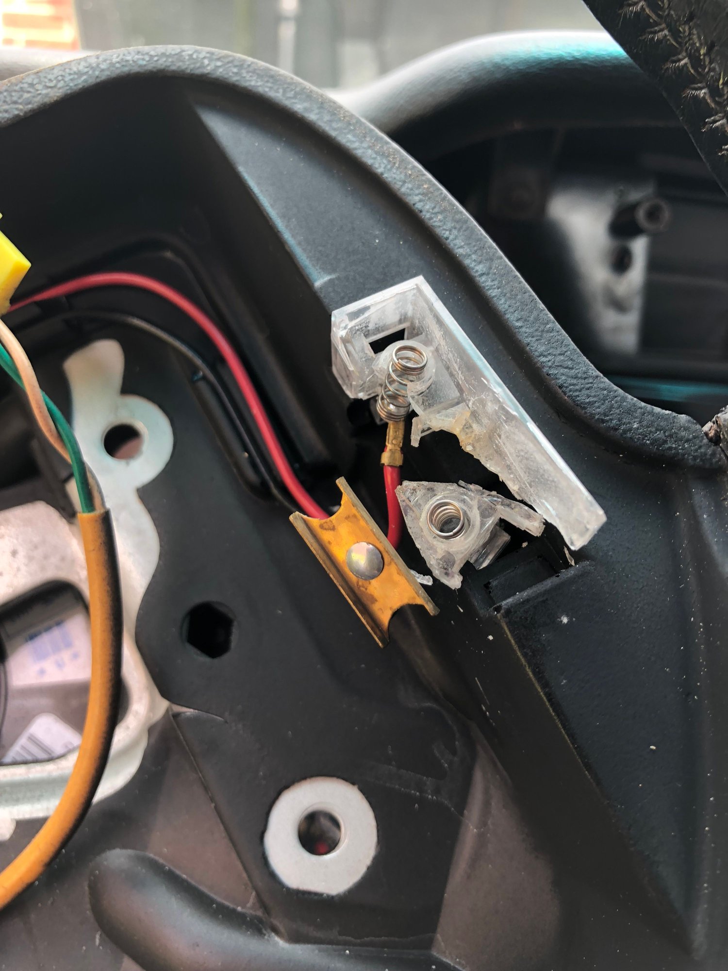

While driving last weekend my horn started blowing by it's self when making left or right turns. To stop it I had to pry the right button up from where the cover meets the wheel.
I got home, parked the car. Ten minutes later horn started blowing continuously. To stop it I had to disconnect both horns from under the hood. Today I got a chance to track down the problem. This is what I found. Can you guys/gals help me locate these parts?
Right button
Harness

https://www.ebay.com/itm/1994-1996-C...dRgqlW&vxp=mtr

Thanks Whaleman, greatly appreciated. Just ordered it.
