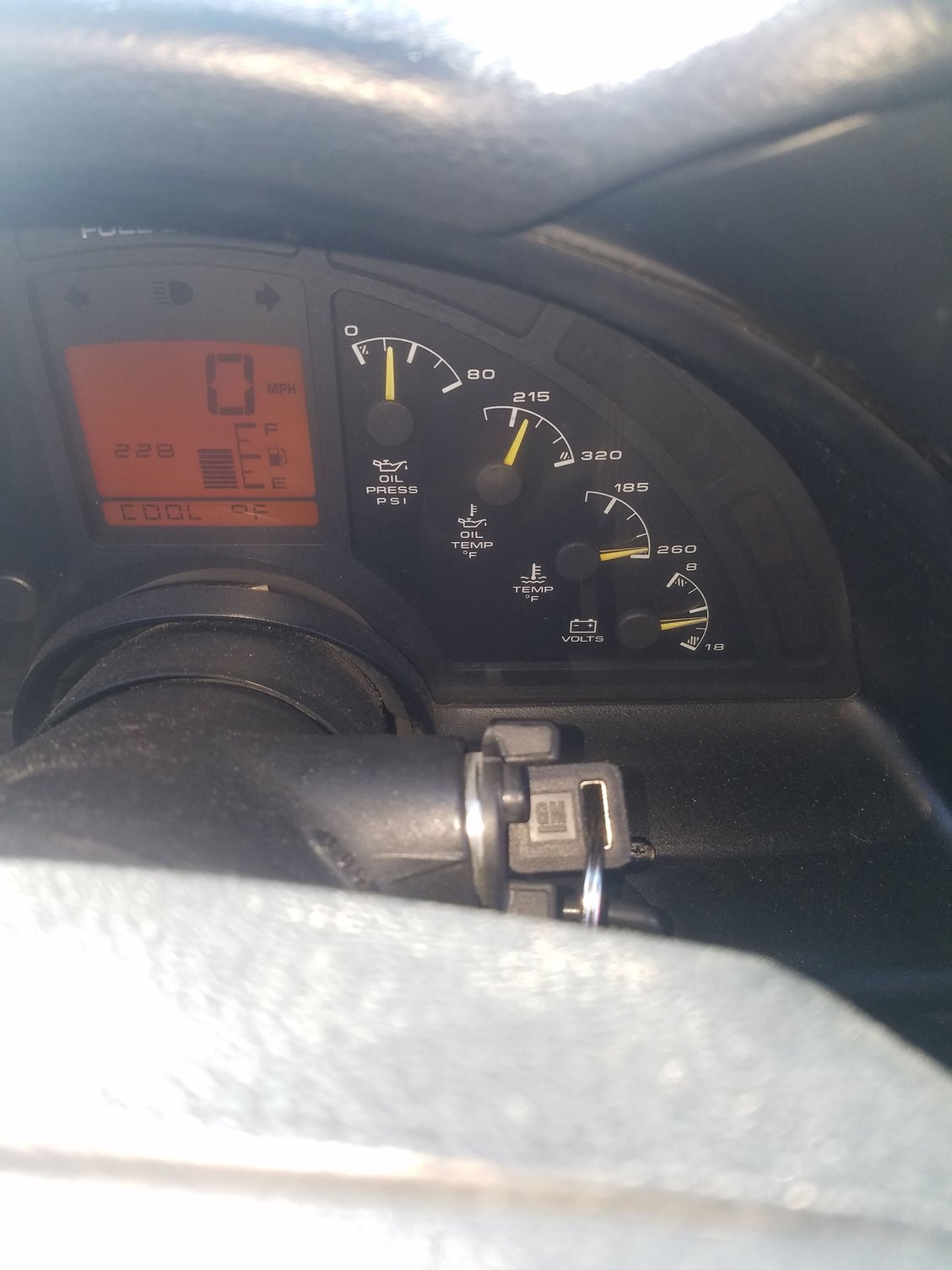

Still having a large reading spread. Digital reads 225, analog reads 240-250. Car smells hot. I'll try to post a pic.

In the pic, your speed is 0 mph. That means that there is 0 air flow through the radiator, until the cooling fans come on....at about 230*F. Your digital gauge is showing a value lower than 230, so the fans aren't doing anything yet. Your analog gauge is doing exactly as it was designed to do; act as a dumb "idiot light" that shows you when the car is "cold", "warm" and "hot".
I bet if you run it another 1 minute, the cooling fan comes on and the temp drops down to ~217 or so. OR turn the AC on which forces the fans on and that should drive your temps down below 200*

You are correct Tom. The pic was taken right when i stopped for a light.

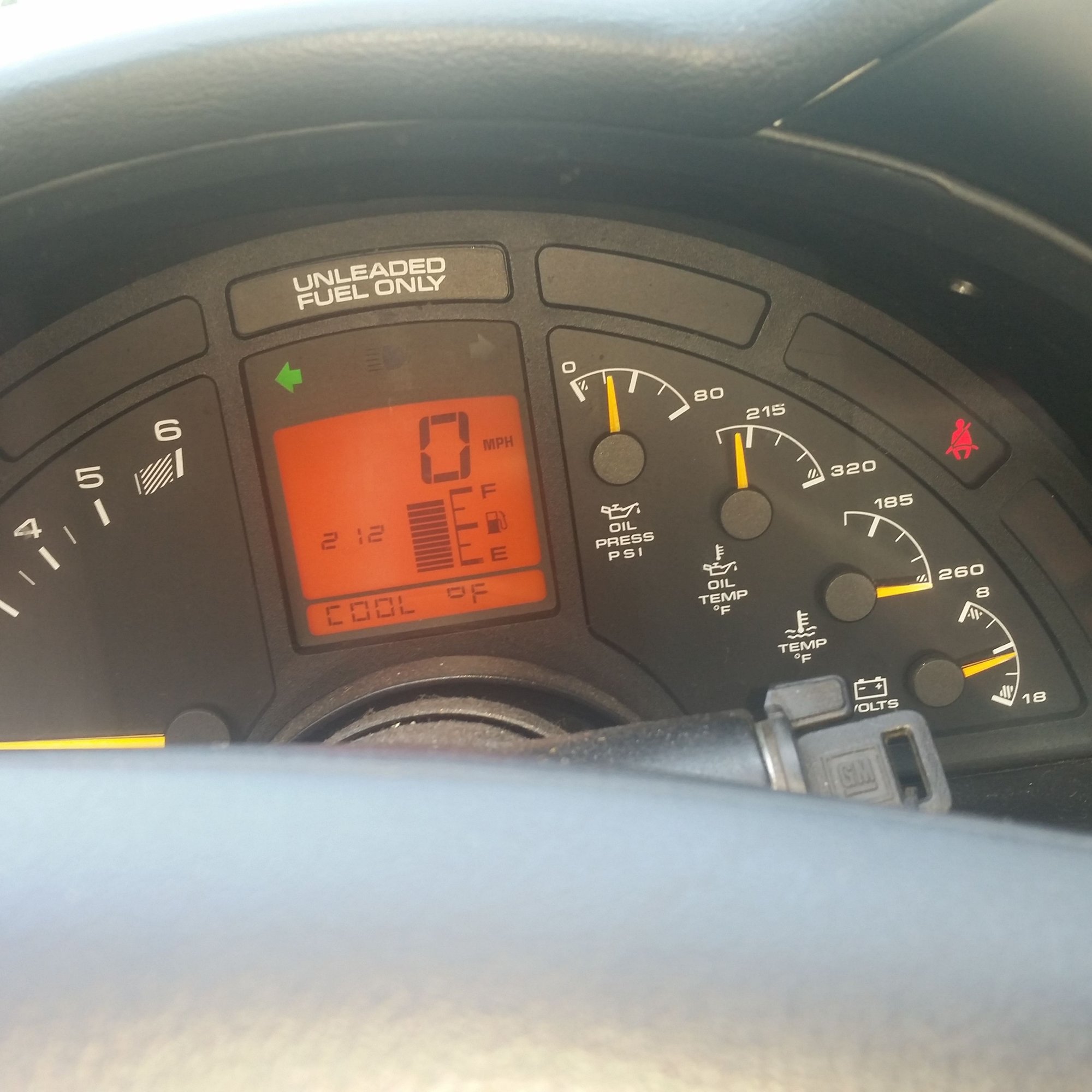

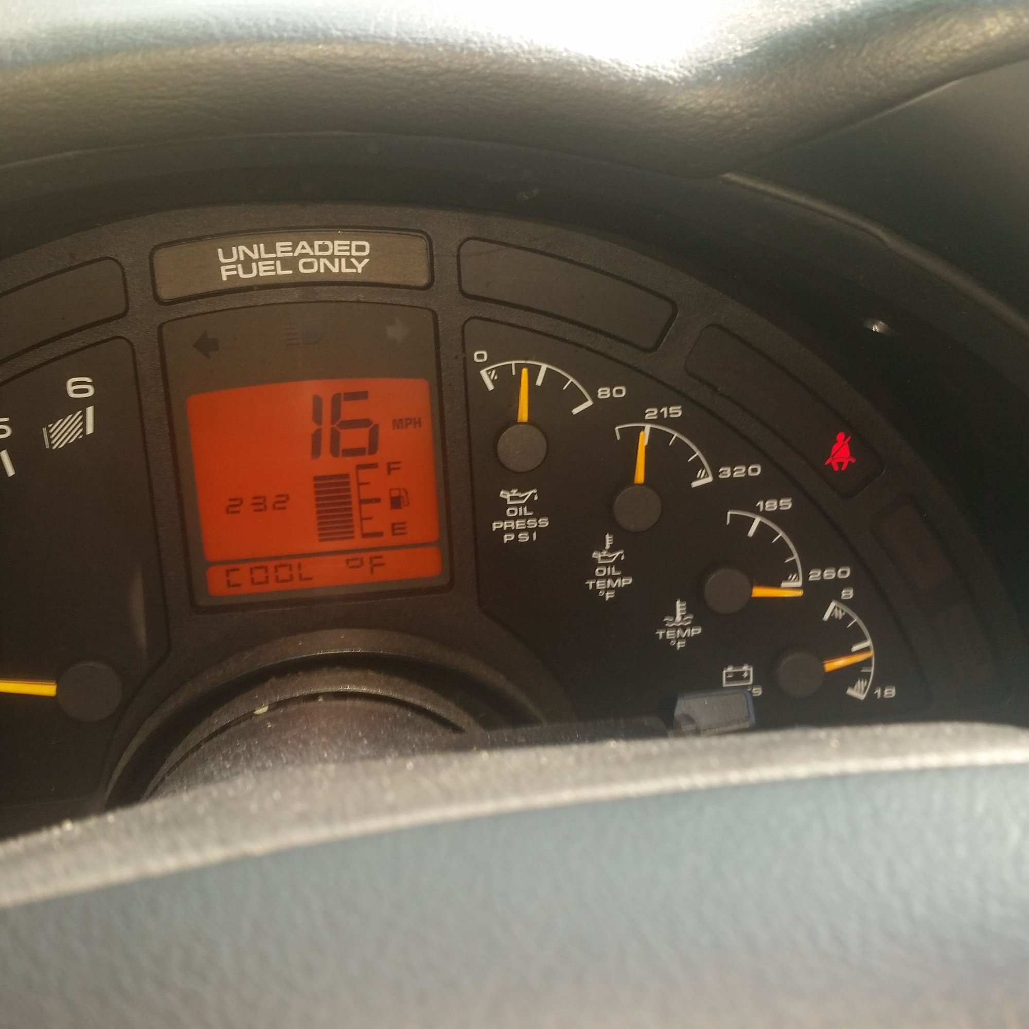

Default Pic worth a thousand words
In this case 2 pics. At stop and slow speed.

The digital gauge shows. 212 and 232. Neither temp is overheating for that car. I'd pay attention to the digital and ignore the analog which is nothing more than an "idiot light".
You COULD, if you want, verify the digi gauge with a temp gun.
