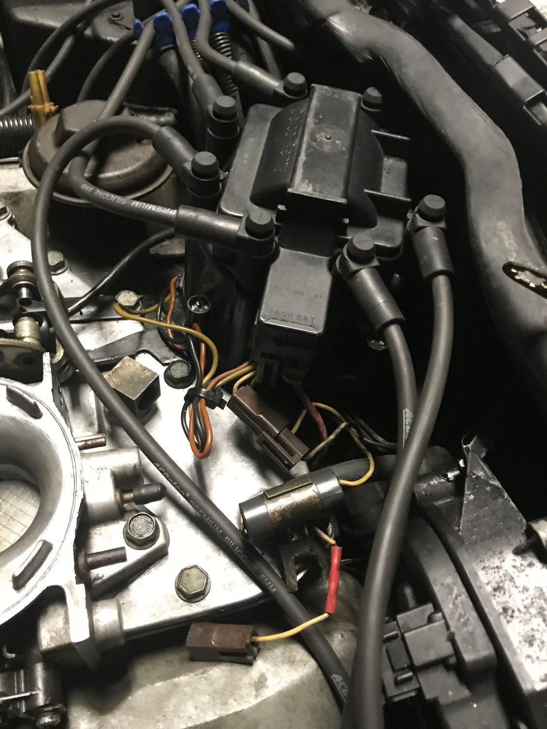

does this loose wire with the tach filter hook to the b+ on distributor? Didn’t get a good look at it before removing the intake plate, and I’m not sure if it was already just hanging there, or if it popped off the distributor.

It should be a single spade Brown plug white wire if memory is correct it goes just Left of the red positive on Distributor cap

A better pic to see what is going on here

There are two white wires that come from the same pin on the distributor connector. One goes to the tach filter, and the other isn't connected to anything. That wire is used at the factory during testing, and is left loose to puzzle subsequent mechanics.
