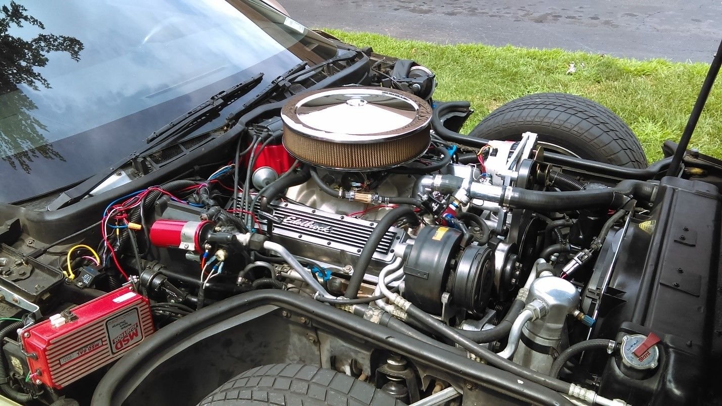

I did a carb on my 85, Wynand Street Warrior manifold, you will need a regular distributor / heli.

That doesn't look like it fits under the stock hood...does it?
The distributor requirement would depend on the brand/type of aftermarket EFI system. There are plenty that would work with the stock distributor.

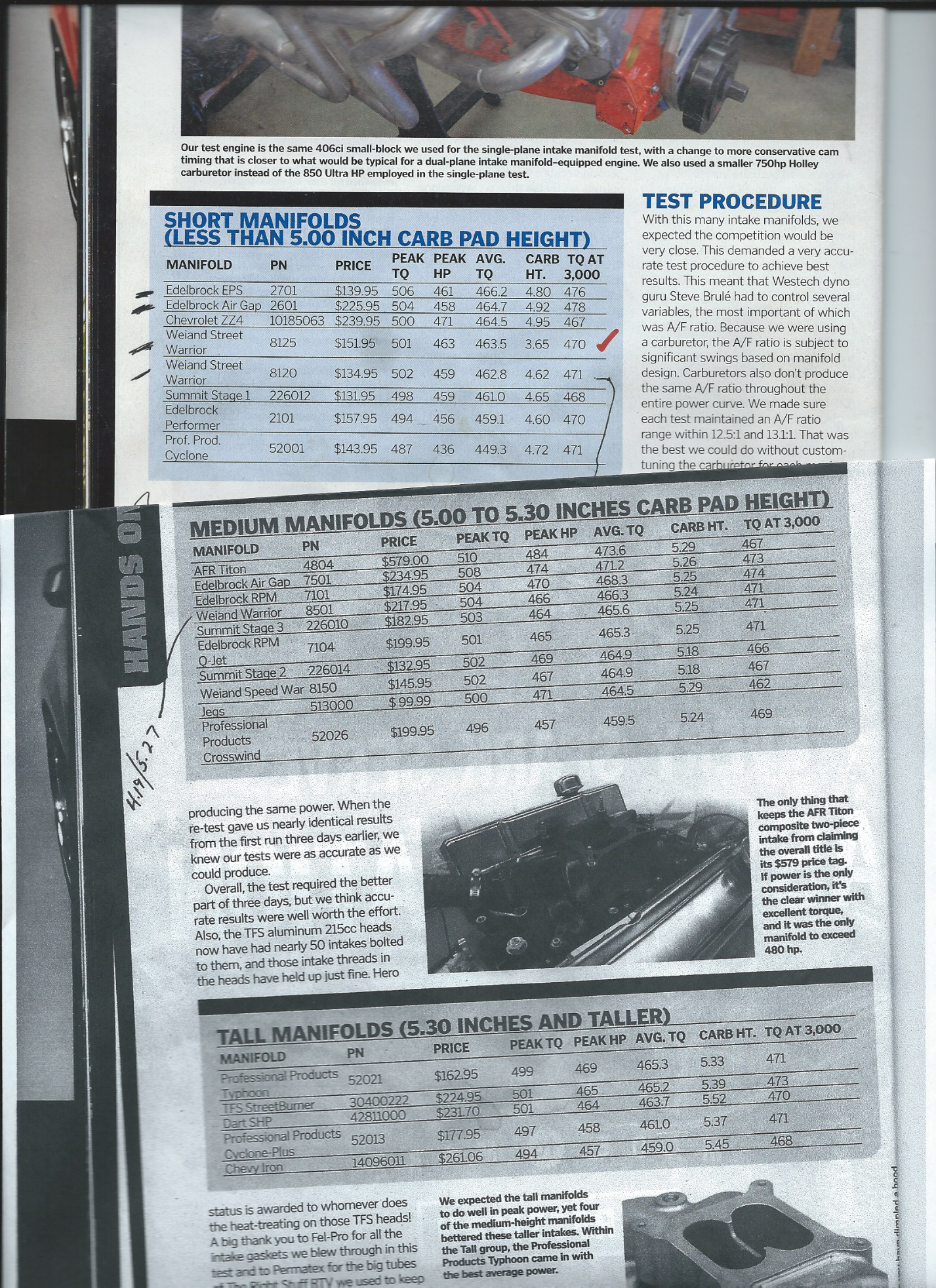

The Weiand 925-8120WND is a dual-plane ; 3.5"-4.5" tall, with a 0-5500 RPM range. The Weiand Team G 925-7530WND is a Single-plane :3.65"-4.56", with a 2500-7200 RPM range. These are a couple of the shortest and best flowing intakes I know of. The Holly Sniper is 3 3/4" tall from base to Air Filter flange. They have a special Filter base that fits it... I think it has a 1" drop from the flange.

here are the manifold heights
