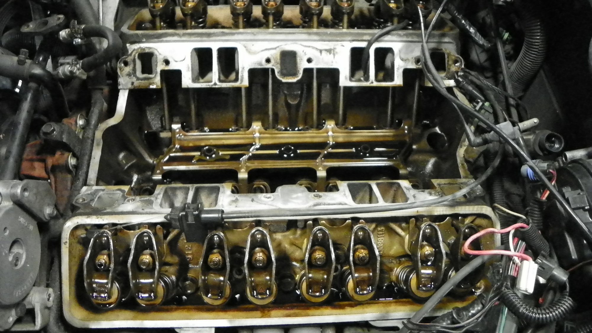

I bought a 1988 C4 that had been neglected and had sludge in it from oil changes that were never done by the previous owner. What I have done in the past is to take a seriously dirty engine and warm it up and let it drain for as long as it wants. Then I fill the engine up to the normal oil levels or slightly above normal with some warm kerosene and let it sit in the engine for a couple hours until I dumped it out.
DO NOT RUN the engine with kerosene as the primary lubricant.
I got a lot of the sludge out but not all. There are products made by reputable companies to assist in the removal of sludge if that would help you. I have not tried them but I would if I needed to.
One important point for you to be aware of is that in 1987 GM changed several key components in the engine including heads and camshaft and they went to the newer style roller rockers and followers. That changes the oil type to allow the cars to run lower levels of Zinc (environmental concerns) like the newer oils made for today's modern cars. This is a problem for any car out there with the older style Camshaft and lifters as they NEED the Zinc or you can wipe a lobe of the cam pretty quickly. Check first, I am not an expert on this but I believe that puts your engine in the same category as my 1968. If this is true then you need to buy oil with Zinc or add Zinc to your oil during the oil change.
On the 1988 C4 after a couple 2000 mile oil changes the oil became clearer and cleaner. Like mentioned to you above, periodic oil changes are the best thing for an older Corvette. I change my oil once a year whether or not I have 5 miles or 500 on all my cars. I don't buy this 15,000 miles oil change schedule, Heck, VW wanted my wife to drive her new 2018 10,000 miles before the First oil change, not... Even the VW Service manager told me every 6 months or 5000 miles. This kind of advice I can handle!
In a earlier post I mentioned taking my Dad's F-150 to a Jiffy lube. There they did an "Engine Flush" using a machine that pumped hot solvent throughout the engine's oil lubrication system and it removed all evidence of any sludge at all. They did it for me to "show" me that it really worked and did not even charge me for the live demonstration. I was very impressed as the engine oil stayed clean after that for many years. The engine was REALLY badly sludged up when my Dad bought it and after this he drove it for years without any problems with dirty engine oil.
I am not a big proponent of Jiffy Lube but what they did for my Dad's engine was amazing. They showed me a filter before and after the procedure, it was amazing that you could have that much sludge and still get oil to circulate inside those tiny passages.
