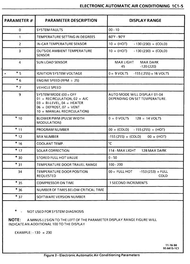

C68 - push FAN + and FAN - simultaniosly for a few seconds and display should show 00 I believe, push AUTO FAN and it should display C68 codes. After code display if you use FAN + or - various paramaters are available. Toggle to 6 I believe and hit AUTO FAN - RPM will be the display /25. If I get a chance I'll copy the entire list of values. Do you have the FSM?
